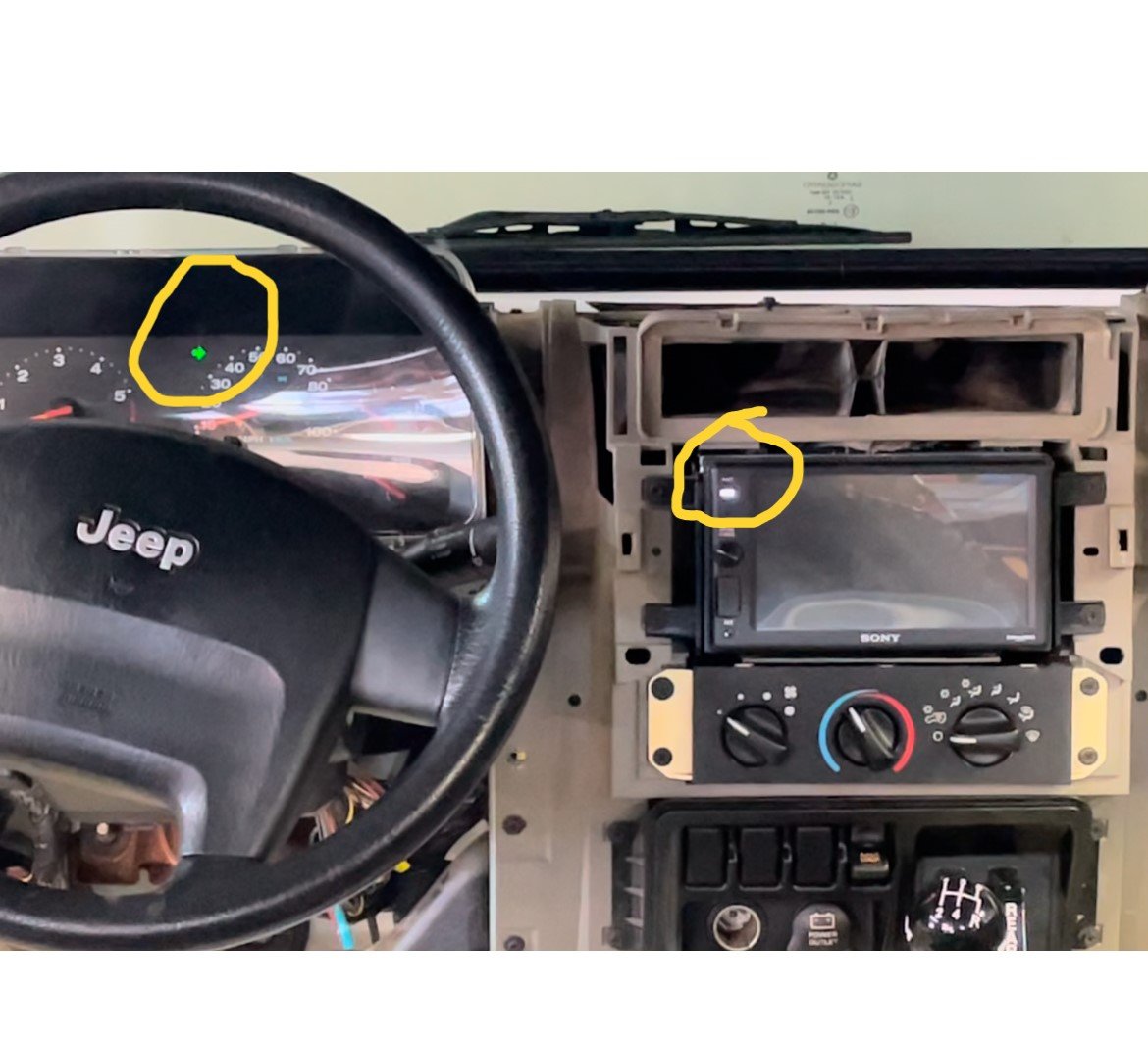

- With no key in the ignition, turn signals function correctly and the home button on the radio now blinks the same as the turn signal (see picture showing both lit up)
- With either the running or headlights turned on, the left turn signal light comes on (see picture) and the turn signal does not function but the right turn signal functions correctly
I have tried going back to the old bulbs but issues noted above are still there. I can't for the life of me understand why changing to LED's in the cluster and HVAC controls would cause these issues. I did have to reverse the polarity on a few of the LED's to get them all to light up correctly but can't imagine that would cause these problems. And I've never known turn signals to function without the key in and turned on which makes me think there is now a short somewhere feeding that circuit.
Other then what I have noted above, nothing else has changed which just adds to the mystery. Could the MFS have coincidentally gone bad at the same time as changing to the LED's? Is there a diagnostic check to do to confirm if it is good or bad?
How do the signals function properly if there is no key giving power? When you turn the vehicle off it kills the power and the blinkers quit flashing, they do not continue flashing with the keys in your pocket.
The key is coming out in the accessory position so the radio turn signals and wipers will still have power. Turn the key forward anotch to the off position when removing it. And get the lock barrel replaced when you can.
Turn signal in dash lighting with running lights is possibly a bad ground behind the headlamp on that side, or corrosion in the turn signal socket. Clean the ground and check the socket.

I took the advice to get the LM470 relay. Relay I originally purchased was an EP26
Changing the relay solved the turn signals "working" with no key in the ignition and also stopped the back feeding to the radio (great news!!)
Regarding the left turn signal light in the cluster coming on when the lights are turned on, the only way I could solve that was to go back to the incandescent's for the front turn signals. Have no idea why the LED's up front would cause the issue but after going down the rabbit hole for a few hours trying to make the LED's work, I finally punted and put the original bulbs back in. I really wanted the LED's for the rear anyways to help with visibility so from that standpoint all good.
