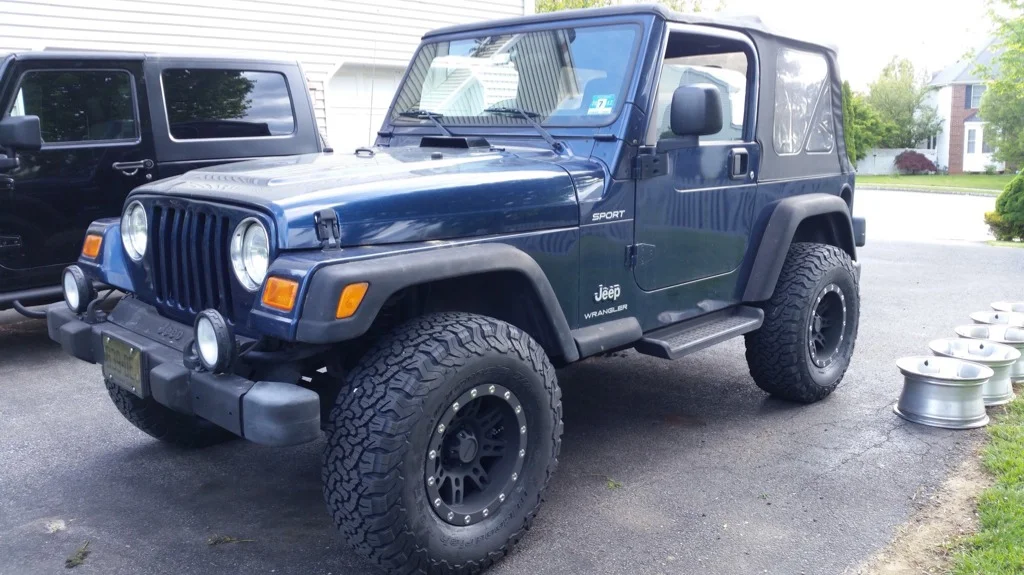

I am running a 2” pro comp spring lift with a 1.25 JKS body lift on 33” bf good rich KO
Love the ride quality
I had a vibration after that, so instead of the ugly tc drop, I did a 1” motor mount lift. Problem solved
Not to tall of a lift but perfect for my 5’ 8” height

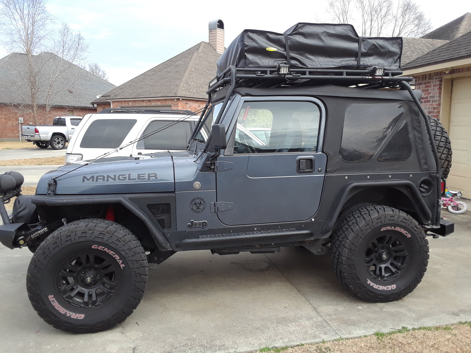

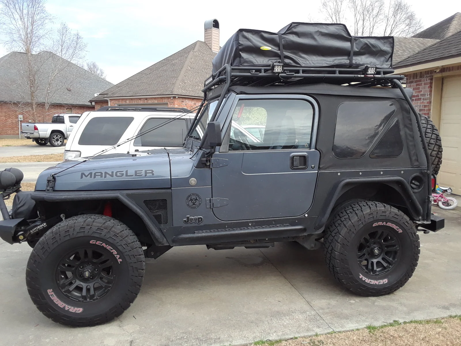

Here's what I did. 2'' OME lift springs front and rear(heavy duty) Rancho RX5000X shocks in the front and the 9000XL in the back. But I pull a trailer most times and needed the extra help in the back. Tires are 33'' x 12.5 on 15'' wheels with a -19 backspacing. No rubbing. And I barely make contact with my fenders when sitting on the bump stops.

-19 would be offset. Offset and backspacing are different. Just don't want the OP to get confused. You're Jeep looks great, but I've said that before! Most on here just use backspacing figures so we are all on the same page. I think its also more intuitive for most, since it's the measurement from the inside edge of the rim to the inside edge of the center of the hub mount surface. The more backspacing you have the shallower the dish is. Offset deals with a positive or negative metric (mm) measurement from the centerline of the wheel. Negative offset means the dish is deeper by the number of mm listed. Positive offset means the dish is shallower.
Good backspacing for a TJ (this is for the OP) is 3.75"-4.25" on an 8" rim. Preference really is the determining factor. I like my 3 5/8" backspacing, but it's too much for some and the tires stick out too far. For me it gives me a wider stance, slightly more stability offroad and the tires look bigger. If I were to do it again though, I would probably get 4" backspacing.
