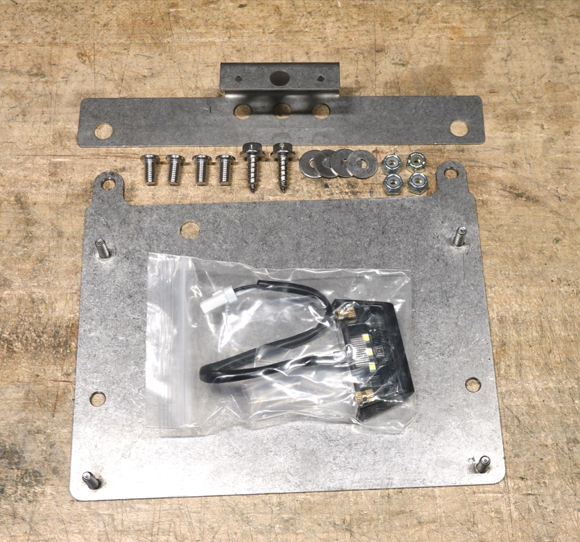

Neither, they are both stainless steel. The studs are also stainless as are the mounting screws into the body and the license plate screws. The only parts that are not stainless are the LED plate light and the nyloc nuts. If you use a SS nyloc on a SS fastener, they will gall and ruin something. The actual color is closer to what is shown below but the highlight reflection makes it look dumb on the website.

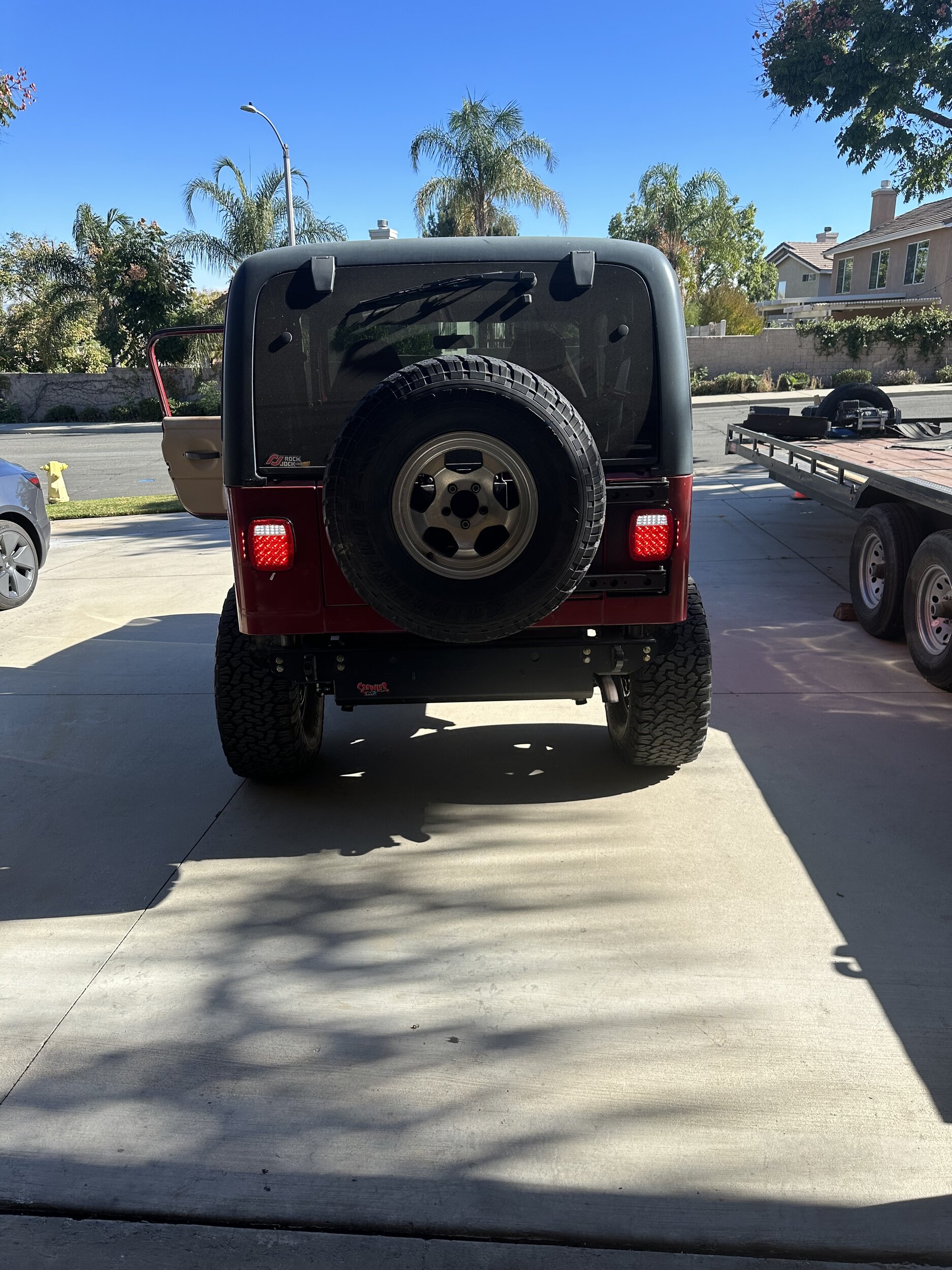

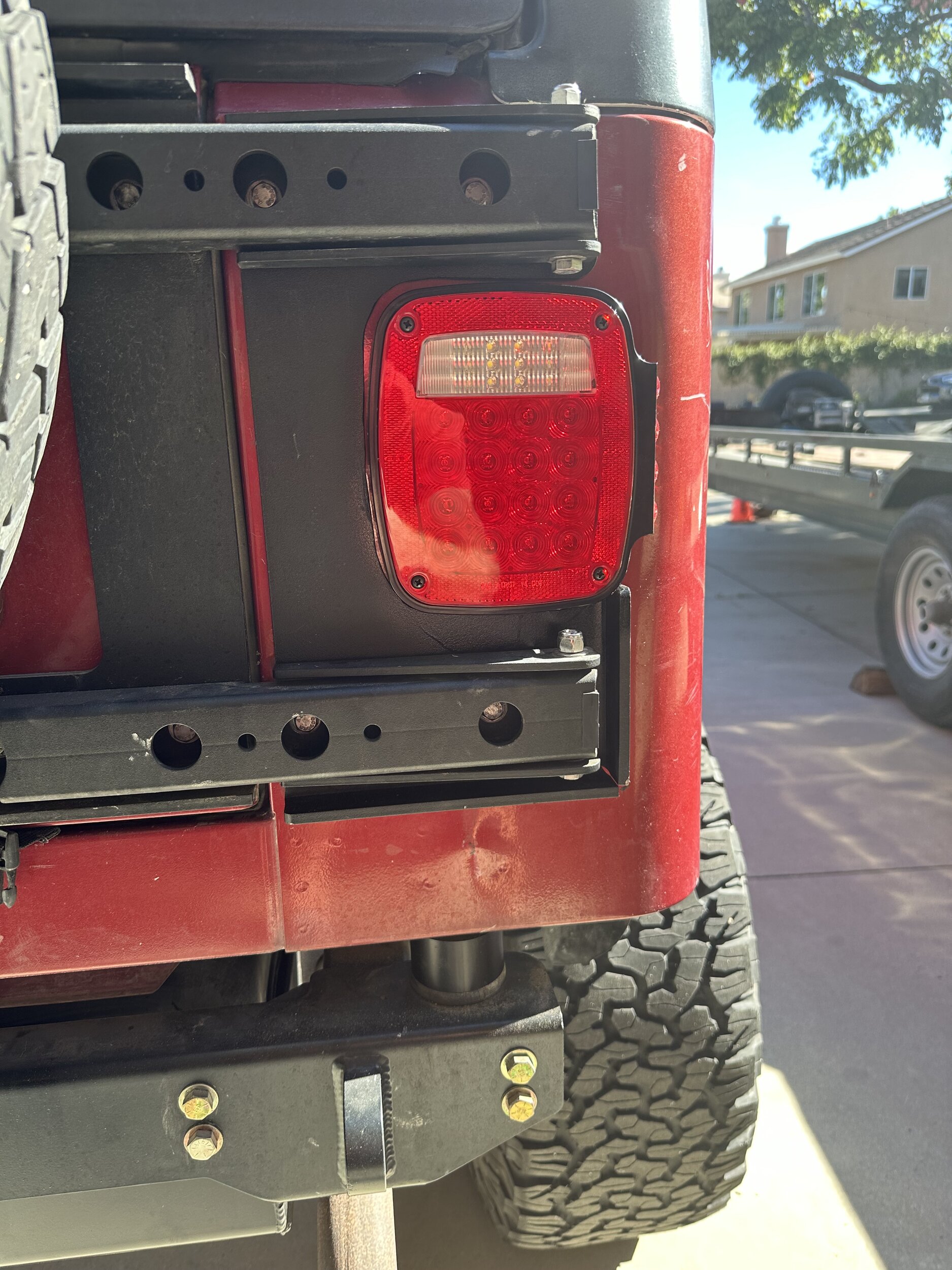

Well, I ordered these last weekend and they were in my hands in a few days and now final install. I knew prior to mounting that my Morryde Tire Carrier was going to have to be trimmed. Got the housings mocked up, traced out and proceeded to cut/grind about 3/4 inch of the plate. Trim job could have been better but my band saw depth wasn't able to handle the whole piece.
Just a heads up for those with the Morryde Tire Carrier, there will be a little more to the install. Blaine's instructions were probably the best I have ever dealt with, straight forward and very clear !
Only other issue I ran into, the body on the Driverside did not allow the housing to sit flat (this was a body issue), instructions mention to use a dead blow to push in the high spots. I did this but the body had a tin can effect which allowed the light to move with the body. A little more persuading with dead blow and the tin can effect was taken care of. This could also be fixed by using the additional mounting holes.

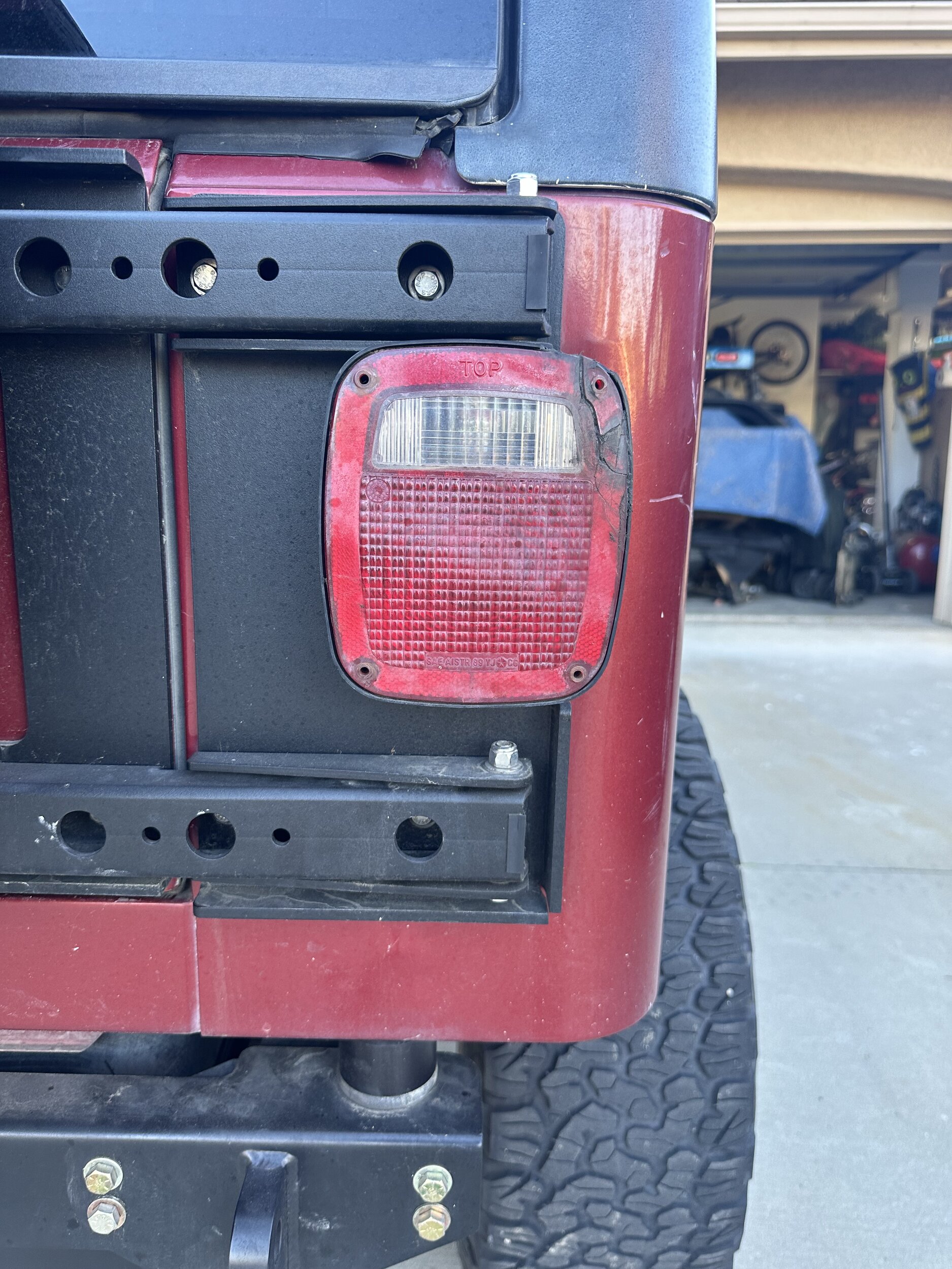

Looks great, but makes me sad. Very doubtful I buy a grinder and remove the morryde. Looks like I have to suffer with the inferior stock lights.

Thanks for the kind words. In reality, we use a hammer to smack the holes in so the housings sit flush. However, I'm not in the market for all the grief I'd get putting that in the instructions.
What if the tin can effect is there? I've got a little of that effect on the driver's side around lowest hole area.
I’ve got everything wired and ready for the relocation kit. Got a new-to-me license plate plastic thingy thanks to @JMT
what is the ‘tin can effect’?
The stock screws pull the holes in the tub outward so the housing sits on them and not the tub.

No reason whatsoever to do it that way and that will just make the install more difficult. Iffen ya'll will let me know, I can include Keps nuts for the 12-24 mounting screws that will bite into the sheet metal and ground the screw that deforms the ground ring. If you don't know, a Keps nut has a captive toothed washer, they bite and lock very well.
