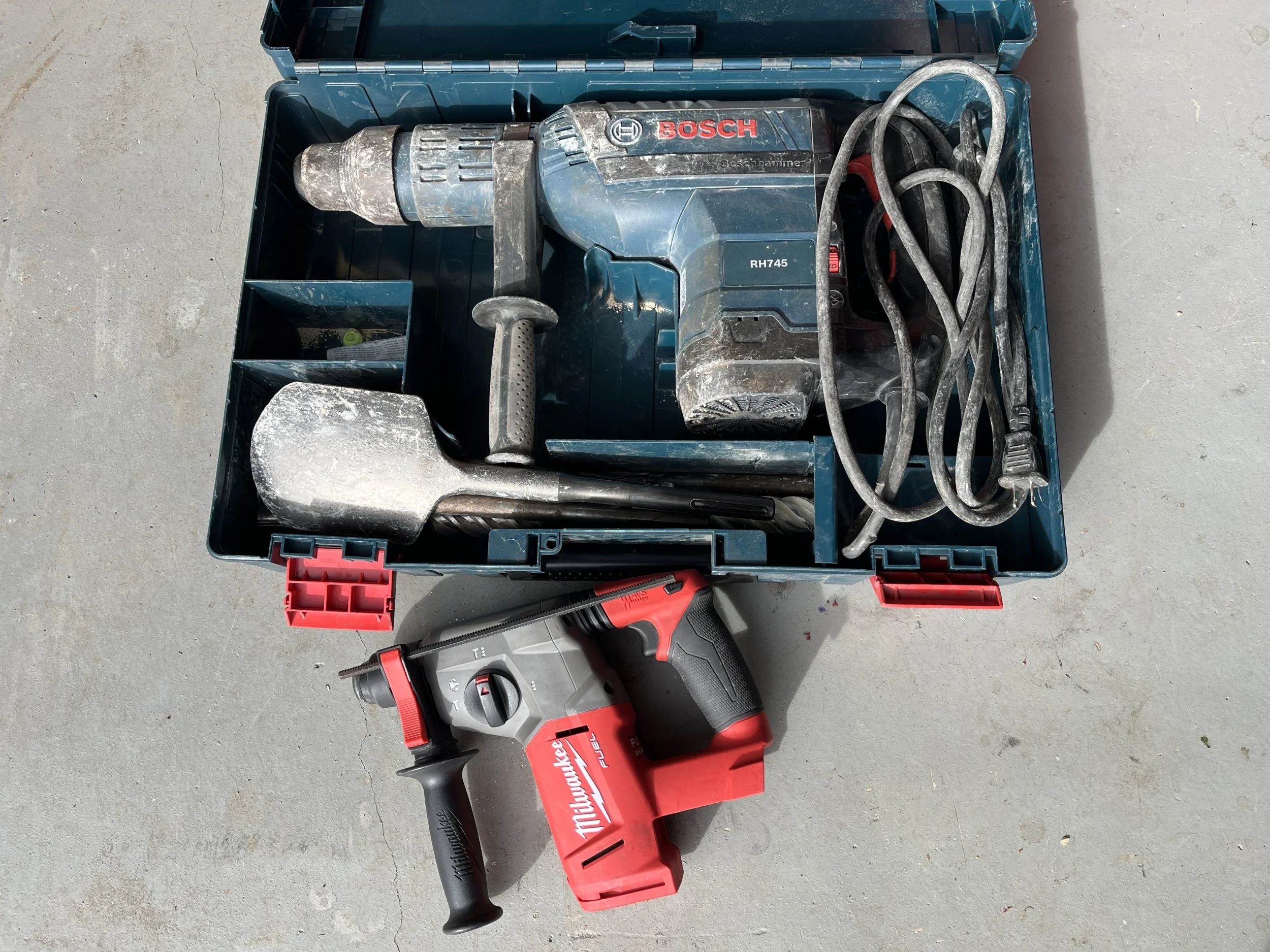

Due to a fairly extensive background in construction, my go-to hammer tools have always been Bosch due to a great crossing of cost versus benefit. They are fast, durable, and fairly economical. You may be able to buy a better/faster hammer drill, you will spend a bunch more for a minor increase in anything that matters. As such I have several ranging from the smaller Bulldog style up to a dolly transported jack hammer. Tired of the cords and associated bullshit, I bought the 5/8" capable Milwaukee M18 Fuel SDS plus hammer drill.
If this tool would have been out when I was doing construction, I would not own nearly as much stuff from Bosch. It is astoundingly fast drilling holes in old hard concrete. It will put a 3/8" - 1/2" hole through a 4" slab in sub 30 seconds. (using a good bit)

It’s hard to argue with you, Mr. Blaine. Two of my favorites that might look familiar:
I’ll be using the M18 soon to drill into a cinder block wall…

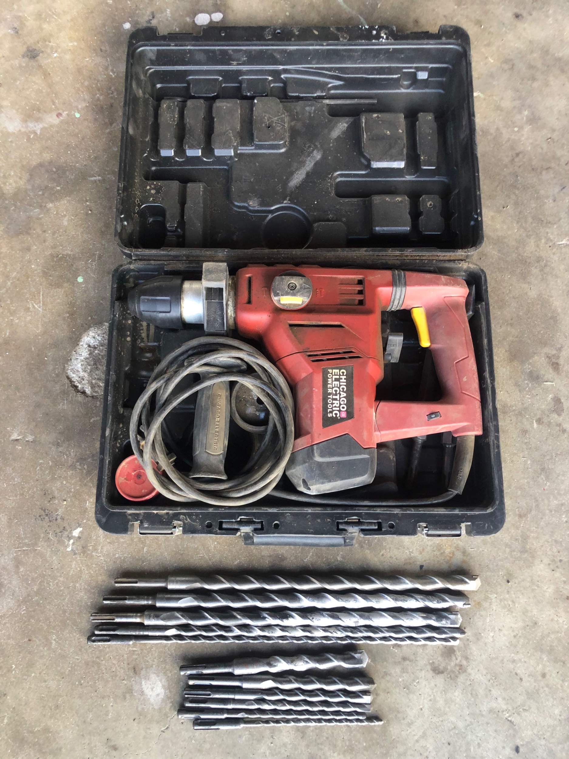

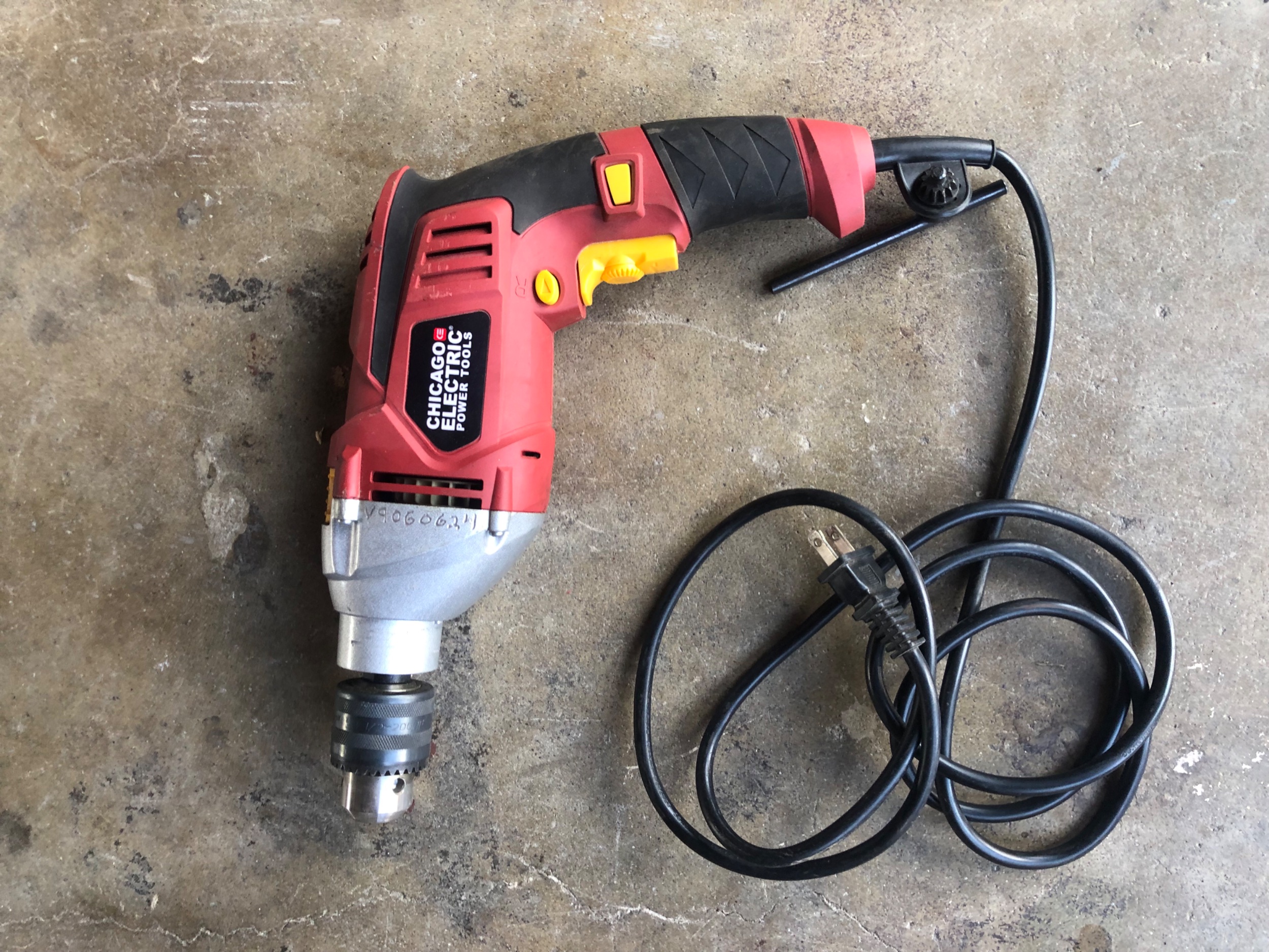

I’ve also got an extensive history of hammer drill use. A corded drill if far superior to a battery. I would suggest that for your limited use the Bauer HD from Harbor Freight would be the best tool. I bought one when my Milwaukee drill finally died. Mine does a great job for up to a 5/8” hole. I also have a HF rotary hammer drill for larger and deeper holes.
Don’t go cheap on the drills themselves. A high quality masonry drill will cut much faster and last longer. These tend to be non plated but have a better quality cutting tip. When drilling a larger hole I start with a 1/4” pilot hole.
I once had a job where I needed to install 250 bronze plaques with four 3/8” each. Tight deadline with 2 days to get the job done for a dedication ceremony. I went through 3 Milwaukee 1/2” hammer drills and many bits. I was in my early 20s and that job nearly killed me.
https://www.harborfreight.com/75-amp-12-in-variable-speed-hammer-drill-56404.html
