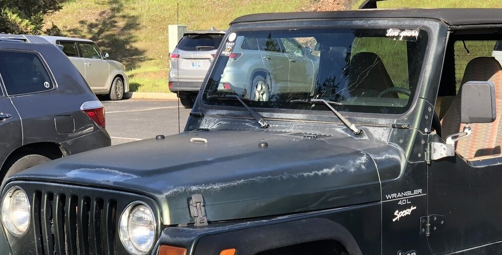

Nice work on this 97. Seems very familiar to me. I've worked through many of the same issues on mine except the transmission; my AX-15 is about the only thing I haven't had to mess with (except the clutch, done prophylactically when I changed the motor). And the paint schemes are about identical:)
  • Love
Reactions: hear
man, we are totes twinkies with that "patina." I'm not sure if missing paint entirely qualifies as patina, but I'm going with it.

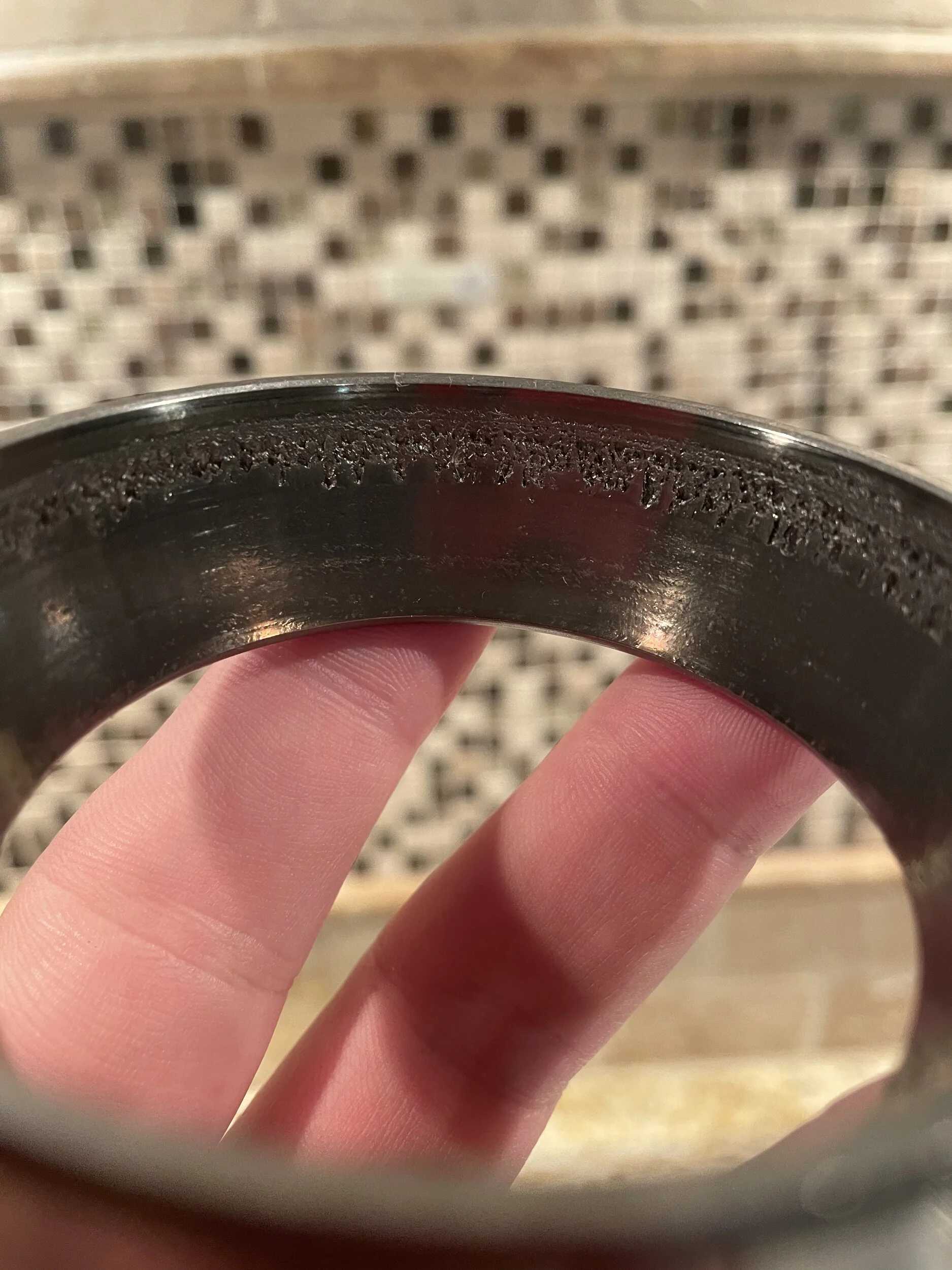

In the interest of closure, I got under the thing last night and easily popped the race back out. This time it went in cleanly & easily. The outer race was a little harder, but both are in. Hoping to put the bearing & seal in later tonight, and maybe even set the preload on the crush sleeve. Although if I get that far there's no way I'm not going to attempt to finish the job.
Old pinion was “slightly pitted.”
