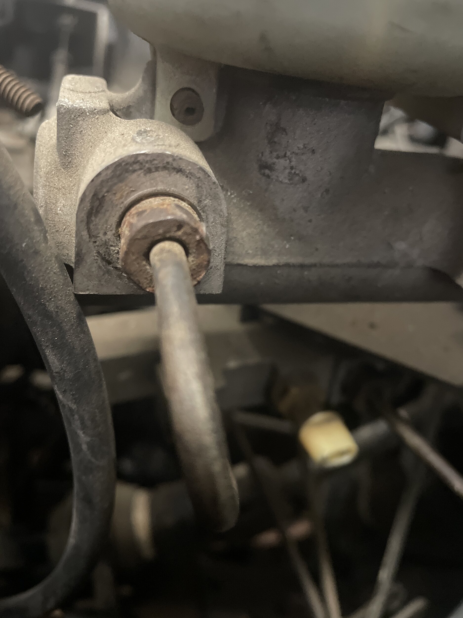

In the meanwhile I’m replacing the master cylinder. I planned to just bench bleed it because it was a little squishy after the normal bleed and it may have run dry at one point. Well that quickly went south, as the tube nuts were already rounded, my line wrench wouldn’t grab at all. Thus far vice grips haven’t even been able to move them.

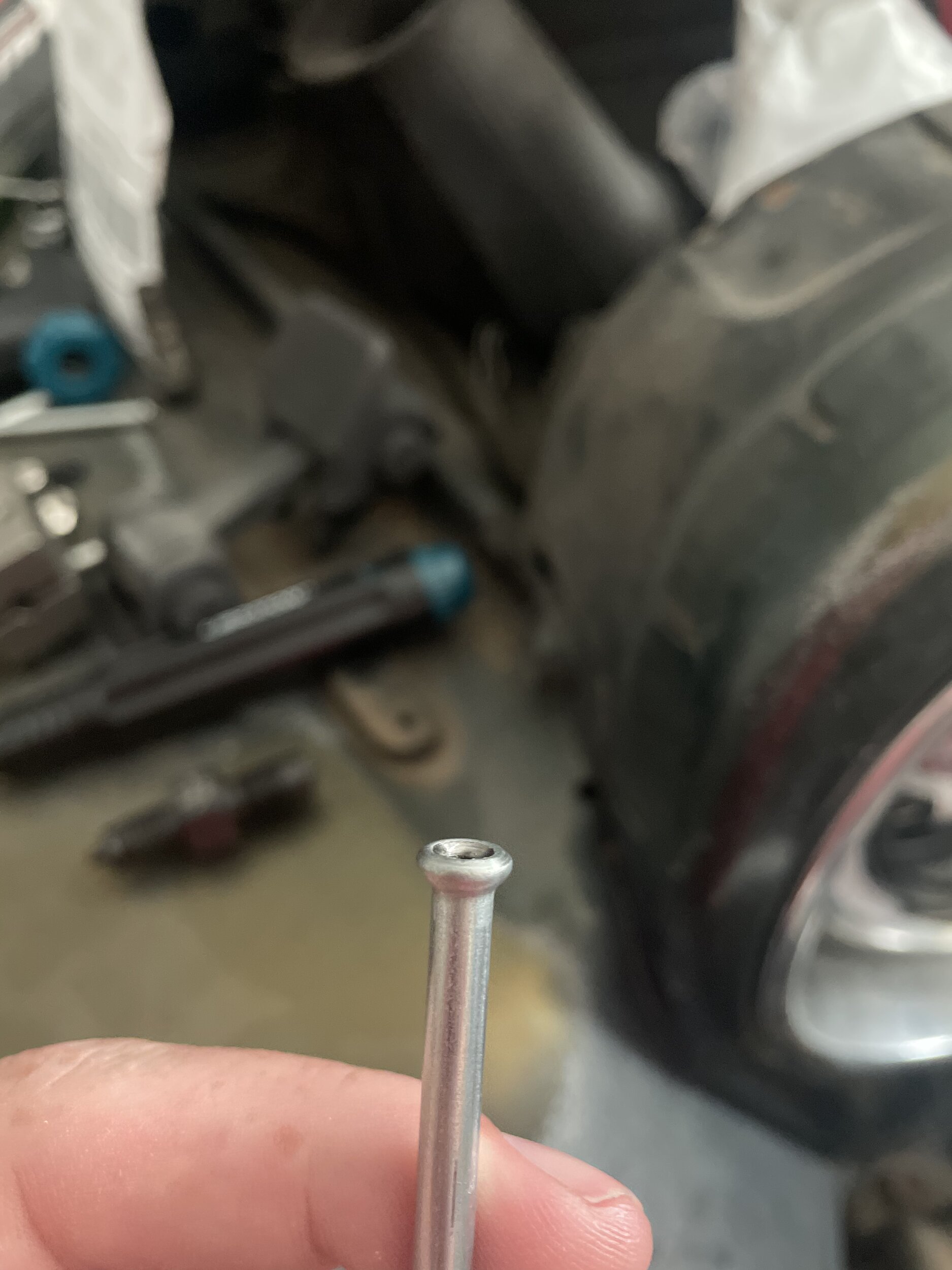

So new m/c, and new “shorty” lines. Can’t find the shorty lines for a TJ FOR sale anywhere so I guess I’m going to learn how to bend & flare my own lines.

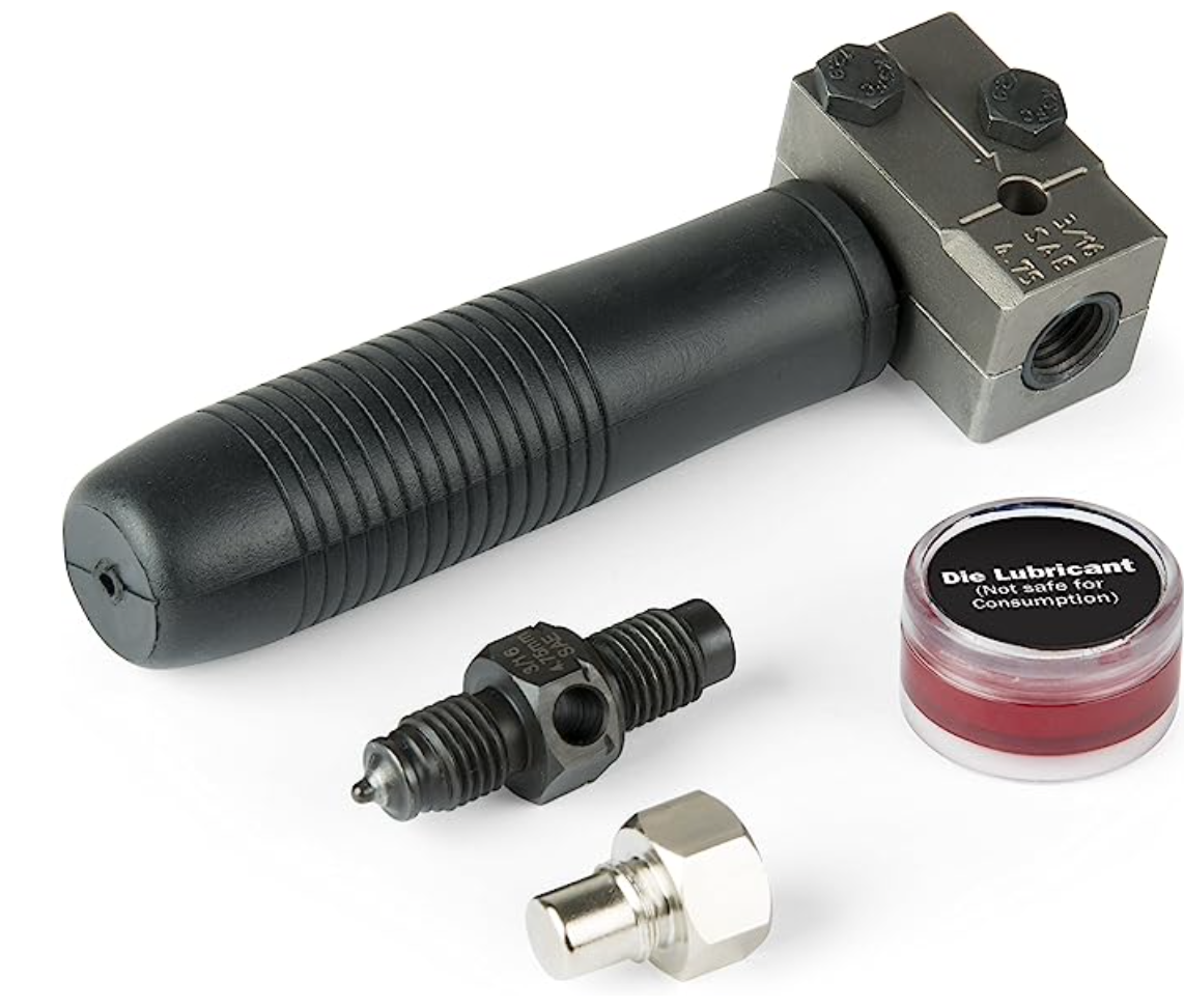

I bought the $40 Titan flaring tool off Amazon, which ended up being 1000x better than the junk I borrowed from Autozone. This was my 3rd practice attempt, which I think is good enough to actually use. I got a $15 tube cutter off Amazon as well, which (no surprise) did a better job than the one I bought from Autozone. The flaring tool is great because is takes all the guesswork out of it. There is a threaded stud to help you set the initial depth, and there is a hard stop on the die so you know when you've completed each part of the flare. It doesn't take 4 hands and dominion over the laws of gravity to get it setup, and doesn't leave tool marks all over your brand new lines. I fully expected to be returning this tool, but I'm definitely keeping it now that I've seen how easy it is to use.

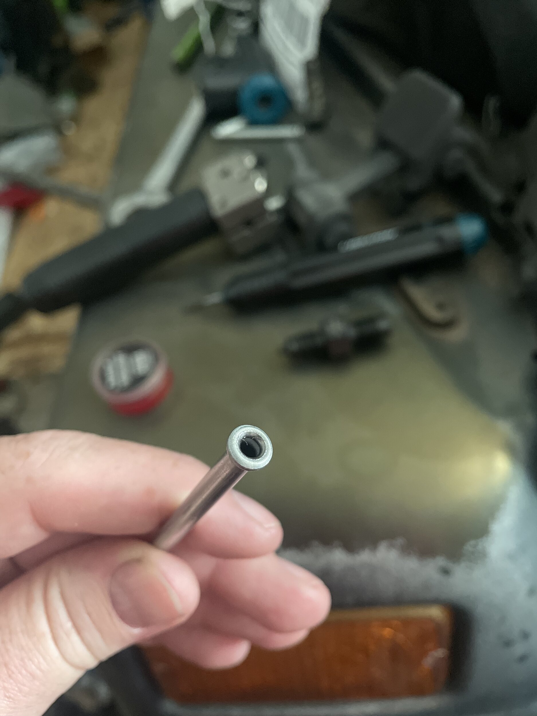

View attachment 506599Finding the correct size tube nuts has been a challenge, more to come on that.
p.s. the flares look amazing. Your hands are too clean though.

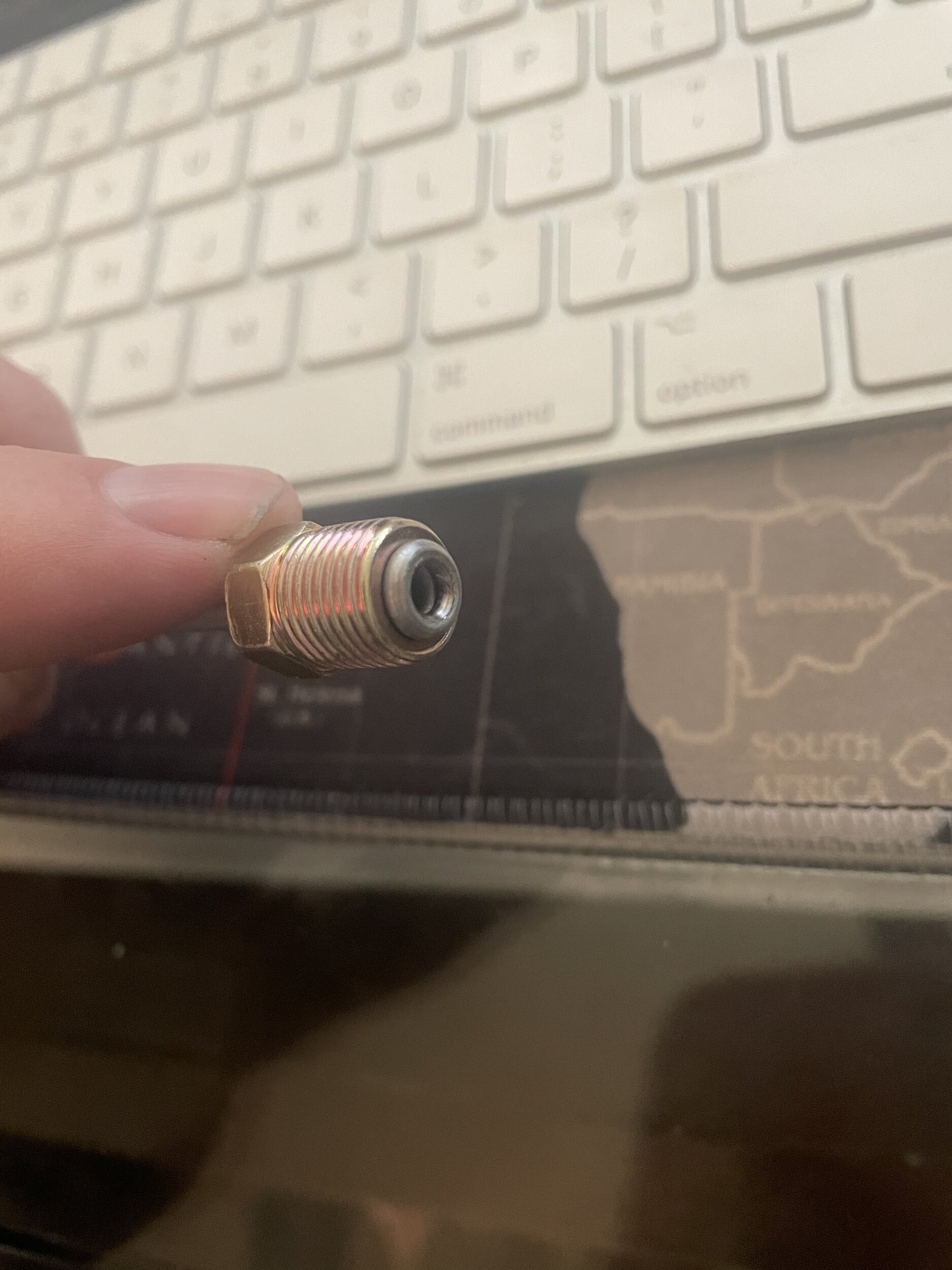

I think I may have this brake fitting stuff understood. Looks like at the m/c it has 2 metric fittings, and based on what I see inside the m/c it requires a bubble flare & tube nuts with a "lead" on the end, which is really just an unthreaded shoulder which is narrower than the threads . 12mm x 1.0 & 10mm x 1.0.
The combo block fittings are 1/2-20 & 7/16-24 according to a couple of threads I've found on the topic. And allegedly they need a double flare and tube nuts that don't have that flare. I won't really know until I take the lines out of the combo block, but Im not quite ready to do that because it means brake fluid draining out. Regardless, I now have those fittings (along with a couple of 11mm x 1.0 which I've read may be part of this puzzle or may just be one of the fittings needed for a different port on the combo block) coming from inline tube, plus another $9.50 in s/h. I could've saved a couple bucks by getting them off amazon but apparently inline tube is the only place where you can find the 11mm tube nut.
I made up a test section to see how each flare fits with the what I believe to be correct tube nut style. I've read that the bubble flare should be 90* on the back side, mine are closer to 45* but they seem to seat ok in the nut. ¯\_(ツ)_/¯ I'll do several more bubble flares before we proceed. They take just about zero effort.

Speaking of which, I got the old m/c out last night. One of the nuts at the booster was REALLY stuck, and because I couldn't get the lines out of the m/c I was extremely limited on options. I could get a wrench on it, but I was afraid to strip it so I really wanted a 6pt socket. The only socket that would fit was a 1/4" drive deep 13mm but even that couldn't get perfectly square on it. Eventually I used a few rounds of PB blaster and CAREFULLY placed heat, then the ring side of a box end wrench + pounding the wrench with big orange. Those nuts for some reason are like half width flange nuts, which I will replace with normal size flange nuts. It will move the m/c about 1/8" forward, but otherwise there will be no impact.

On the brakes front, after nearly giving up 2 nights ago I gave it another go with a fresh head yesterday and started to see the light at the end of the tunnel. I made a few more attempts and started to try some bends and things started to look ok. 3rd attempt was the one I went with. The bends aren't as crisp as I would have liked and could probably take an inch or two out of the overall length, but they threaded in to the m/c & combo block w/o tons of stress so I decided to call it good.
Next up was to bench bleed the master cylinder which I did this afternoon. It didn't take too many strokes (lol) but got it all bled & then mounted on the jeep. Got the lines all in and held my breath on my flare quality. Had my daughter slowly put pressure on the brake pedal (knowing full well the rest of the system needed to be bled too), and I did have some drips at 3 of the 4 tube nuts. Tightened them down a little more and NO MORE DRIPS!

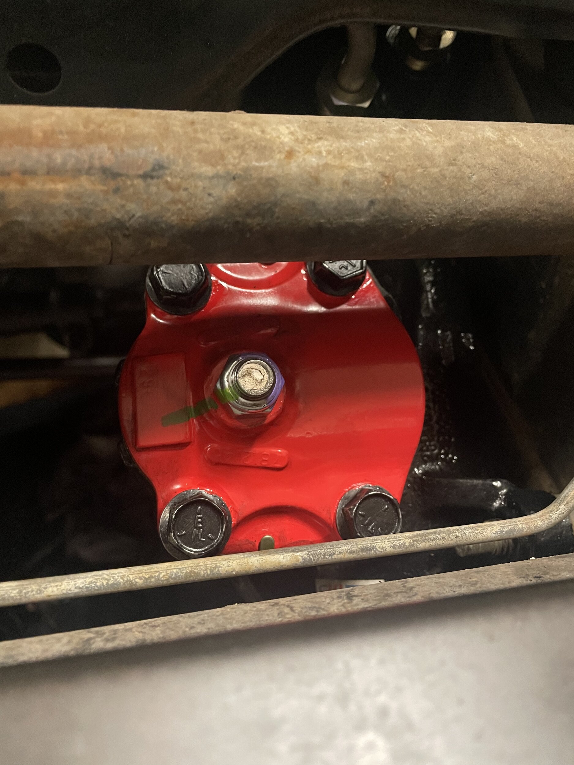

Oh, and I have to bleed the power steering since I put the redhead box & new ps hoses on the thing. I'm very read to see this thing drive.

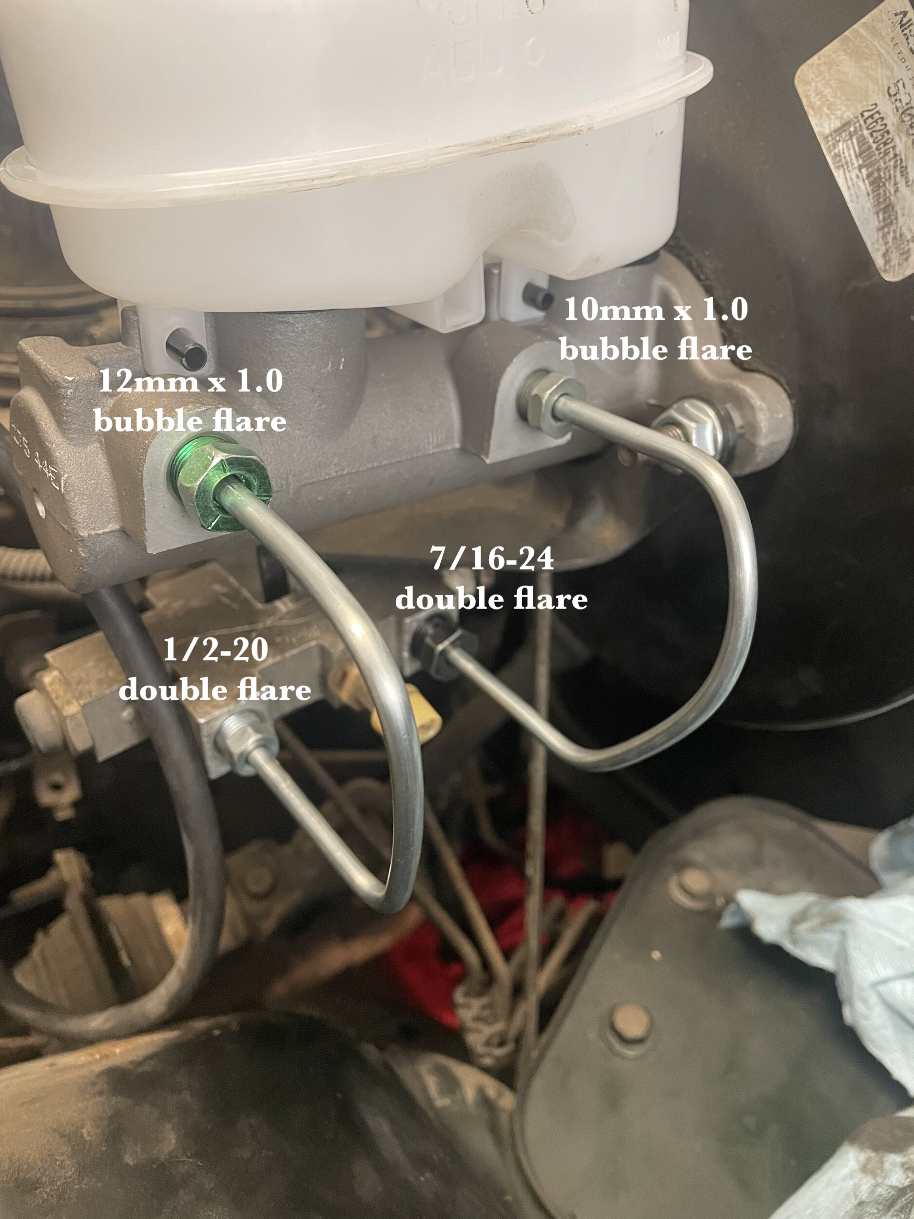

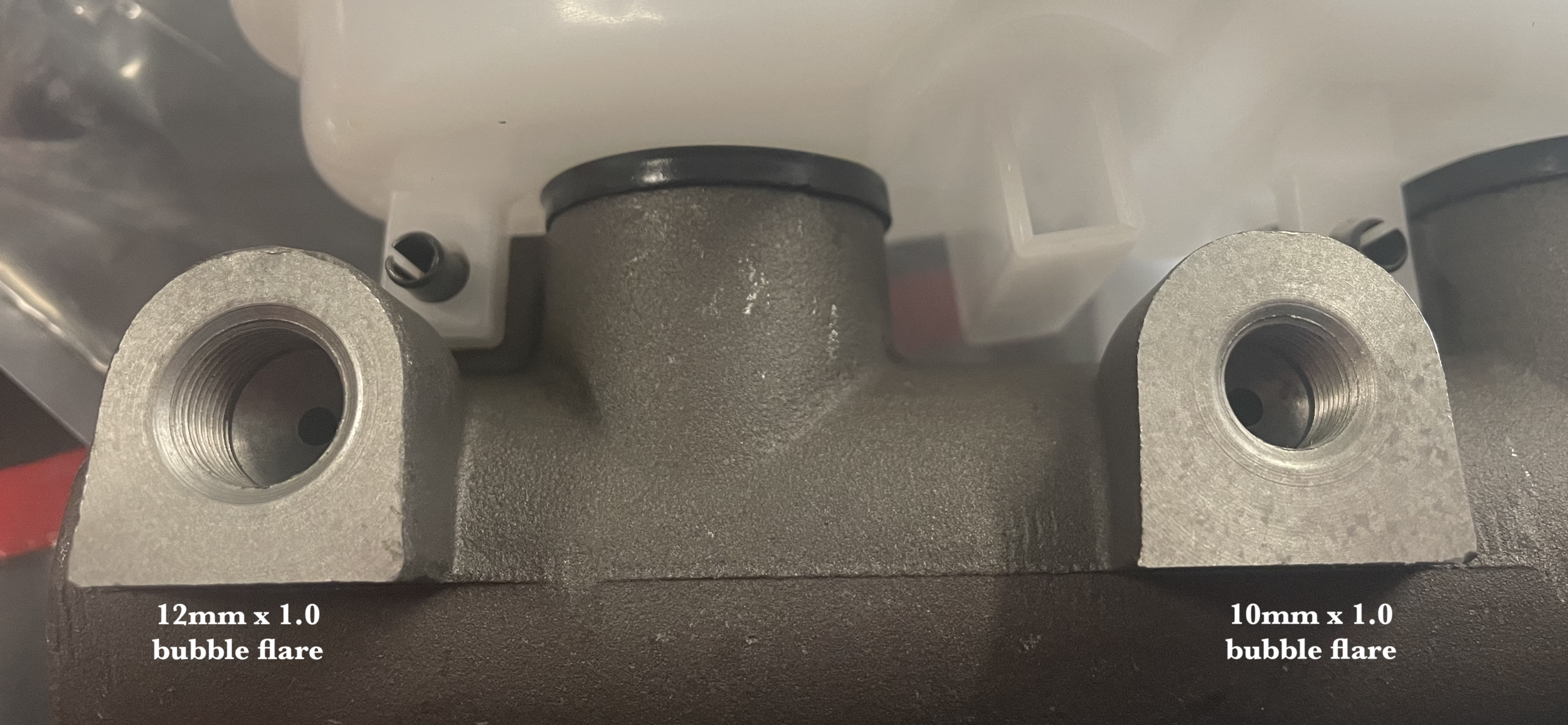

A (hopefully) final note on master cylinders & flares. There are a quite a few threads on this topic and they were occasionally confusing, and I don't remember seeing any threads that really gave all the info. And I guess this is just adding to their number because I'm not addressing the fittings that go to the hard lines, I'm only concerned with what connects the master cylinder to the combo block.
There are a couple threads floating around where it is mentioned that (a) one of the fittings is an 11.0mm x 1.0 and (b) that it is really hard to find this fitting. Then there are some other threads where it is said that (c) one of the fittings is an 10.0mm x 1.0 and (d) that it is really hard to find this fitting. Now I will caveat by saying that TJs can have variations, so it's possible what I'm stating here is only true for my 97 and isn't gospel, but it more or less aligns with a lot of what I found after cobbling threads together.
First off, a definitely agree that 11.0mm x 1.0 is hard to find, but Inline Tube carries them. 10mm x 1.0 seem to be readily available on Amazon, inline tube, and even at parts stores. The Dorman master cylinder bench bleed kit also comes with those metric sizes, which supports my claim that the 10mm is a fairly standard size, and is what is in use on our master cylinders.
http://fedhillusa.com/ was a very helpful site in understanding flare types etc.
At the m/c there are 2 ports:
  • Forward (left) port
    • 12mm x 1.0
    • bubble flare
  • Rearward (right) port
    • 10.0 x 1.0
    • bubble flare
At the combo block there are lots of ports, but we only care about the ones that connect to the master cylinder.
    • 1/2-20
    • double flare
    • 7/16-24
    • double flare
Note that the flare type is different at the m/c than it is at the combo block. I'm sure there is a great reason they did it this way that involves unions and committees and other awesomely effective decision making processes. Why some are SAE & some are metric it no doubt the result of an entirely different set of committees and backroom dealings.
Aaaaaaaand the finished product. I'd like to have gotten those lines to be a little shorter & have the bends be a little better, but for a DIY job I'll take it. Currently its holding pressure without leaks.
Looking forward to a report on the redhead steering box
