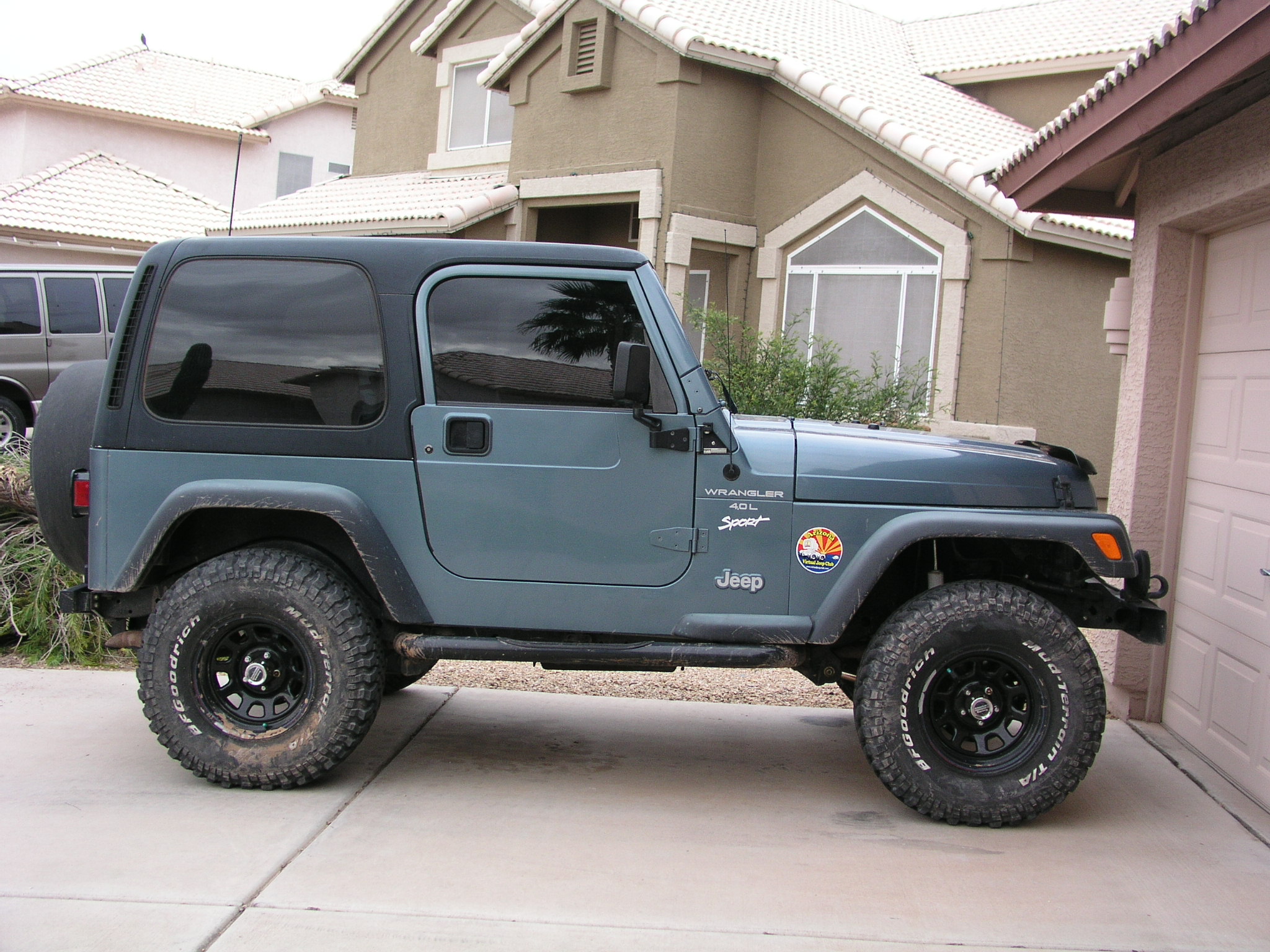

FYI - mine is a 4.0, 5 speed, 3.73 gears, and an Old Man Emu 2" lift with 32" tires, the rest of the suspension stuff was factory for many years (control arms, track bar, etc). I'd focus on the lift and regearing as soon as possible to replace those 3.07 gears.
I've been through a lot of Arizona off-road trails with this setup.
That's an awesome stance...a 2" lift is where my head is at ... I'll check out Old Man Emu as I'm not that familiar. Thanks!

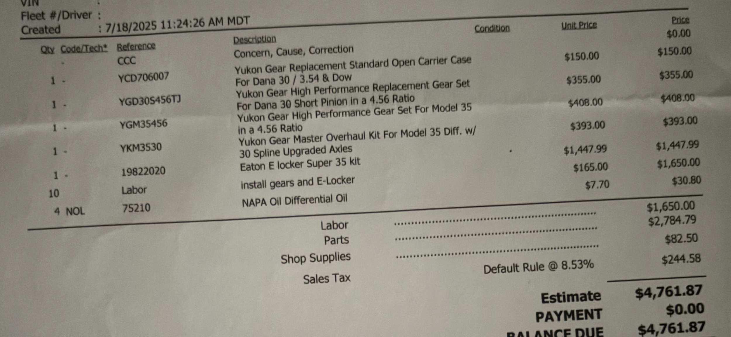

Went to our local off-road shop and got a $4700 quote for the regear (4.56) and super 35 (Yukon components) with an Eaton e-locker. $1600 of that is 10 hours worth of labor. Does that sound reasonable?

That re-gear and super 35 price seems a little high to me but I'm not surprised. Everything is so expensive now. With regard to locker/limited slip choices, the best option for trail capability and icy road manners is selectable lockers front and rear. OFF for road driving where open diffs are the most stable. ON as necessary for trails or if you get stuck in the snow. I don't see true tracs or some other limited slip as good in most situations in a short wheelbase rig like a TJ. They are useless if you lift a wheel and you don't really want both wheels spinning if you are going road speeds in icy conditions (especially in the rear). I had F/R true tracs in mine briefly. I thought that would be a simple, effective and slightly less expensive way to go. Wrong on all counts:rolleyes:
