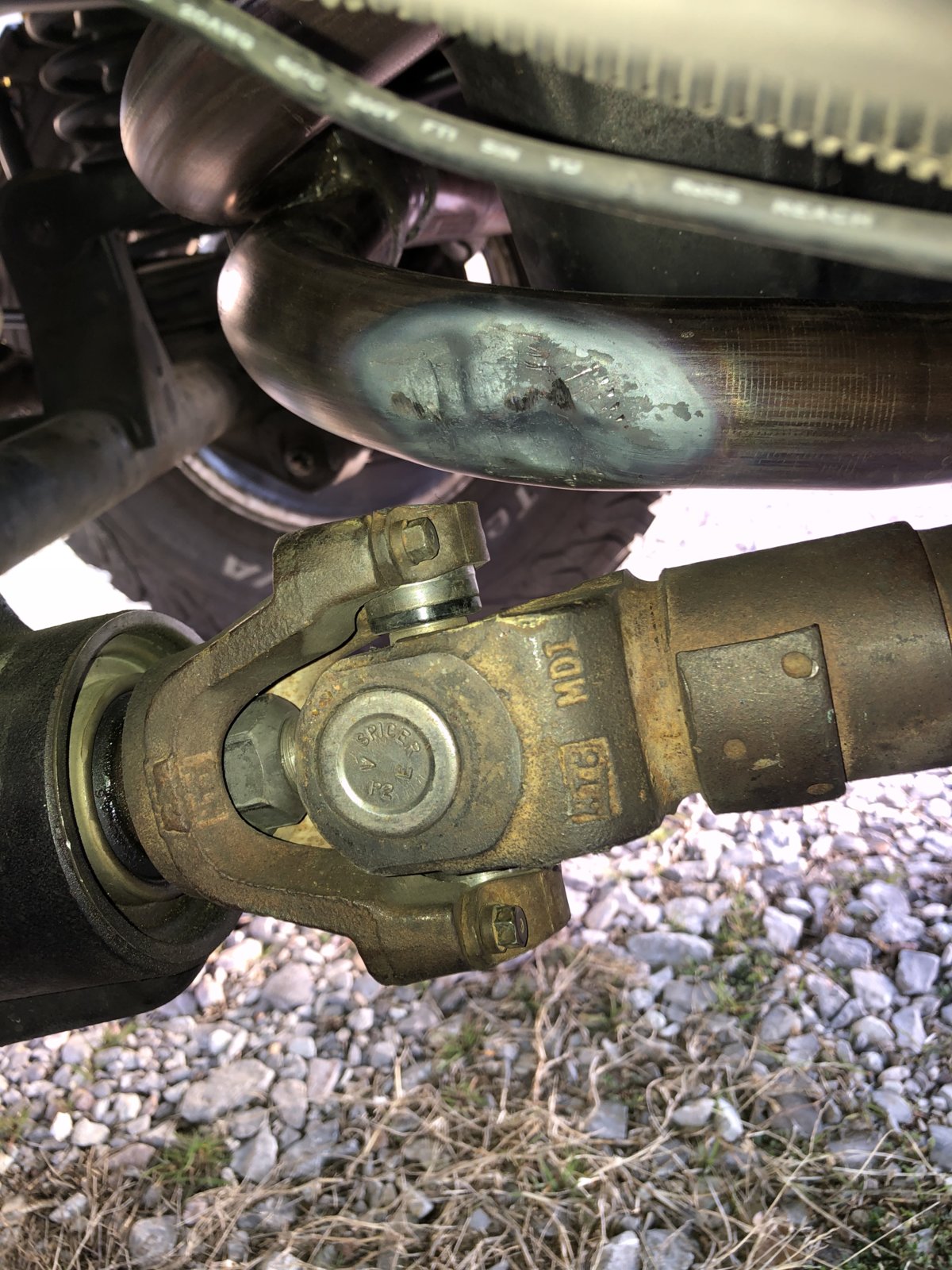

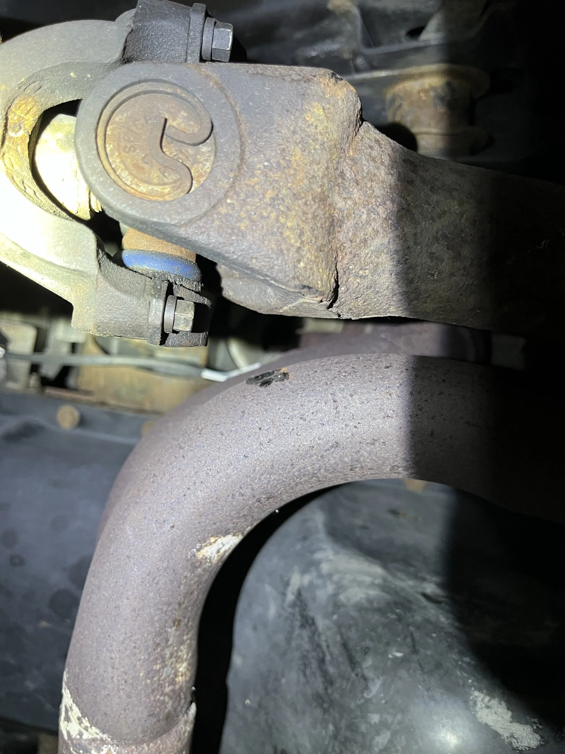

Found another possibility. Looks fresh. Is this the culprit of the sound? Any solutions? The cat is the flow master bolt on replacement.

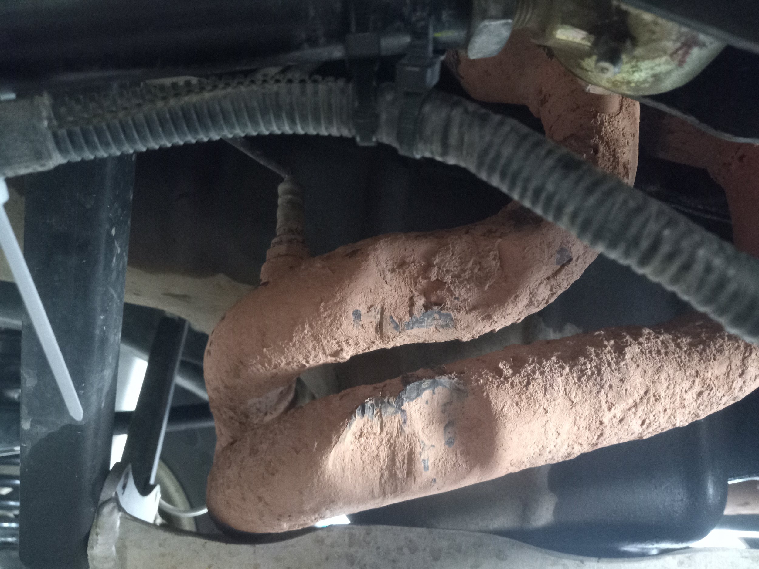

lol. Man, did you go at that with a pipe wrench? Is that heat mark from the exhaust heat stagnant in the bend or was a blow torch used to Bend it in?
I had to remove the cats to replace the RMS last year. Had to do the whole job over night because I had to drive to work the following morning. Rough week. Was holding the exhaust up with my legs in the air and wrenching the exhaust manifold and my hands. Anna were sore for week.
lol. Man, did you go at that with a pipe wrench? Is that heat mark from the exhaust heat stagnant in the bend or was a blow torch used to Bend it in.
That wasn't mine.
Mine's actually worse. Both pipes pushed in. I assumed it self-clearanced before I bought it. Suspension setup was different then.
Guess it's fine now because that dirt's been on there forever.

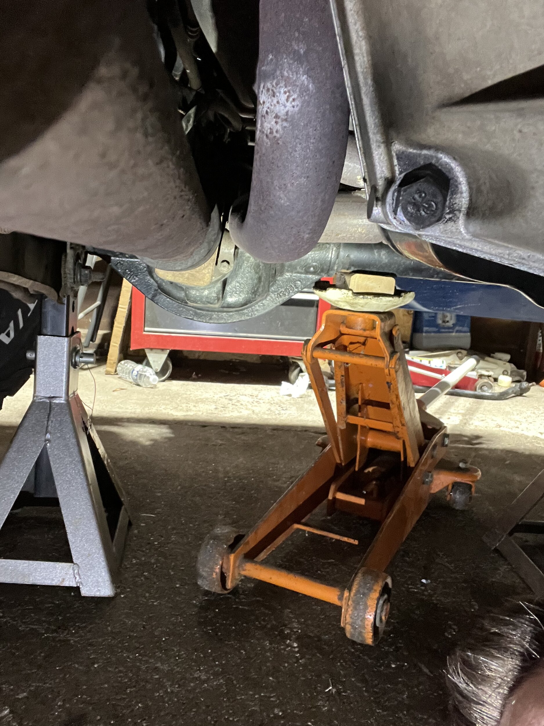

While doing a oil change I decided to loosen the bolts that hold the cats to the exhaust manifold. Jacked the exhaust up on the passenger side and retightened the bolts. The sound has been gone since. For. After two days it’s a safe assumption the front drive shaft hitting the exhaust was the sound in the video.
