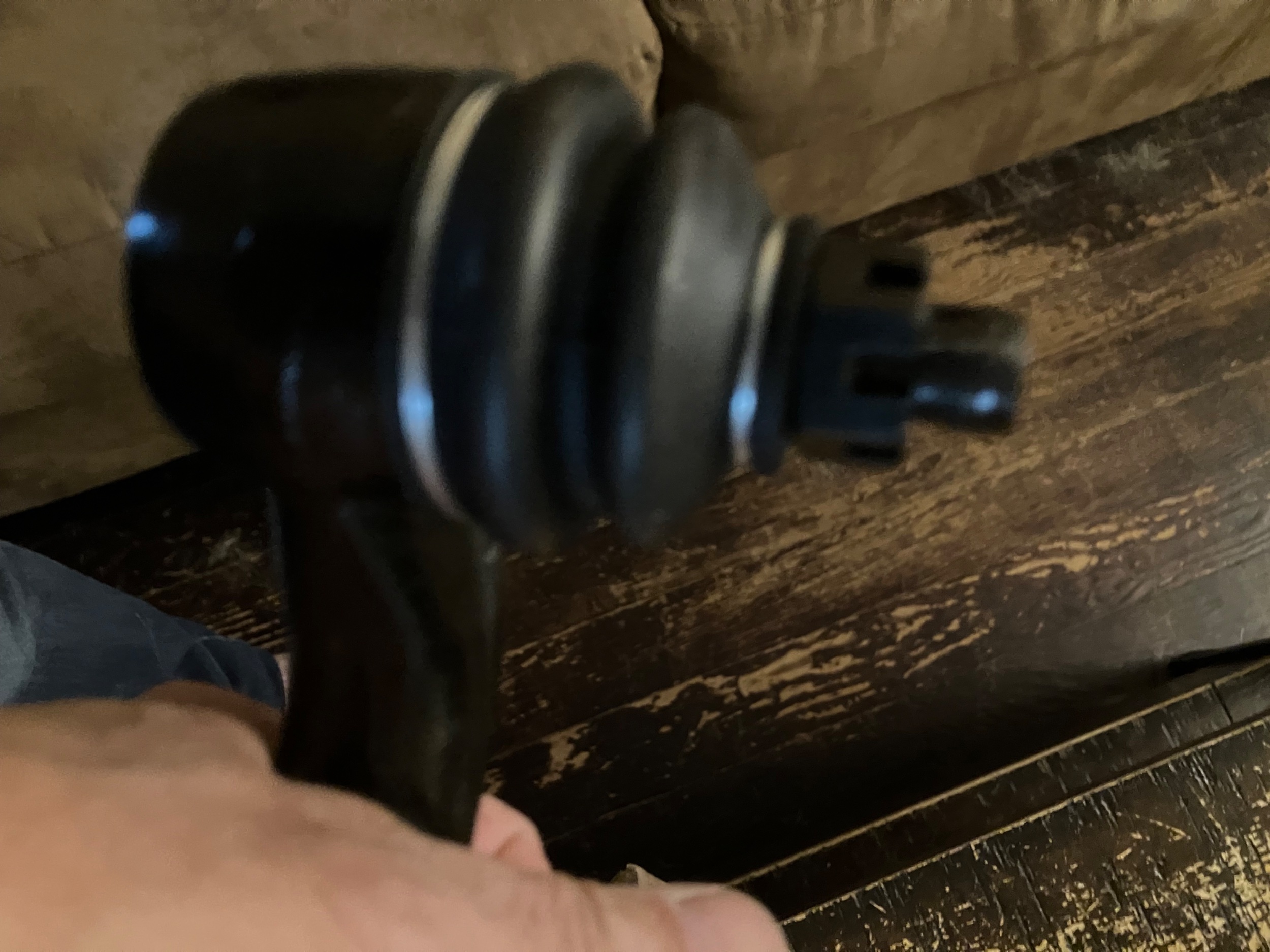

W warlock66_x New Member Original poster Joined Mar 7, 2024 Messages 1 Location Michigan Oct 27, 2025 #1 Hi! First time poster here. So I got a cheap drag link replacement bar, and the tie rod end doesn’t have a grease fitting. Do I need to grease it? Or just run it?
Chris Administrator Staff Member Ride of the Month Winner Joined Sep 28, 2015 Messages 76,802 Location Gillette, WY Oct 27, 2025 #2 Remove the boot and pack it with grease, then put the boot back on. Unless it's brand new, in which case it should have grease in there already. Reactions: macleanflood
