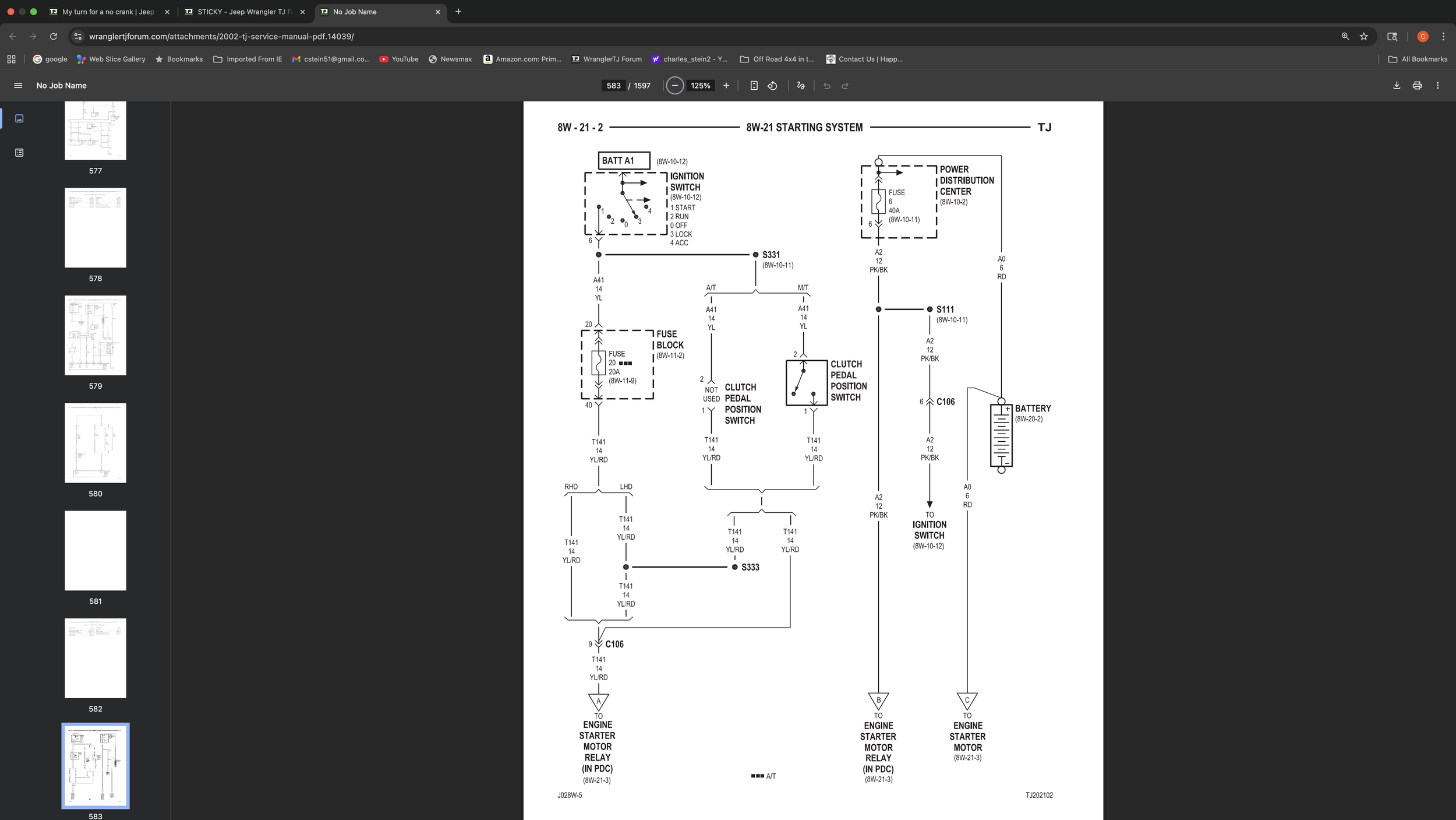

Hope these schematics assist you in troubleshooting the starter problem.
I’m going to trace the circuit from the diagrams now that I’m back at my desk. We did swap relays with no change in the result. And I tried to measure the voltage at the relay (without the relay) but my probes wouldn’t really make good contact with the contacts down inside the cavity. That or I have very little voltage there.

I'm also trying to understand the starting circuit in the wiring diagrams but it's complicated. I only have a physics degree so I have to go slow.
With the key off, we jumped the big side of the relay cavity and hear the starter turn. That was good enough for me (at the time?) to prove that power can get to the starter and make it spin. I'm reasonably confident it will start from there, I'm focused on why the key won't make it spin.
Check the YL/RD 14 gauge wire from C106 to verify continuous 12V terminal 86 at starter relay when turning the ignition switch to start.
Check the BR/LB 20 gauge wire from C104 to verify continuous Ground terminal 85 at starter relay.
This will determine if you have the ability to engage the coil side of the starter relay.

IF I understand your question correctly; on 8W-21-3 above; the starter relay terminals on the drawing are as follows:
B1 is relay terminal 30, B2 is relay terminal 87, B5 is coil positive from ign sw 86 and B3 is coil ground 85.

For whatever reason I'm having a hard time understanding this circuit, so your words are helping it come together against the diagrams. Here is the description of the circuit trace, which is probably just a restatement of what you've said in several posts already, but at least now I can follow along with the diagrams and maybe even explain it.
B1 = 30 ==> 12 PK/BK to Splice S111
>>> S111 has 2 branches
  • 12 PK/BK to Ignition switch SUPPLY via C106 (pin 6)
  • 12 PK/BK to PDC Fuse 6; the other side of Fuse Six is 6 RD to BAT+
I understand why they handled this with a splice, but it would be easier to understand if these were 2 different wires. Because I'm an amateur.
B2 = 87 ==> 12 BR to starter solenoid via C104 (pin 12)
B3 = 85 ==> 20 BR/LB to NSS via C104 (pin 5)
B5 = 86 ==> 14 YL/RD to Splice S333 via C106 (pin ?)
>>> S333 is interesting when it comes to LHD A/T
  • 14 YL/RD ==> Fuse 20 ==> 14 YL ==> S331
  • 14 YL/RD ==> Clutch pedal switch (not used) ==> 14 YL ==> S331
Then S331 ==> START position of Ignition switch
QUESTION: Does "not used" mean not even wired up? Because otherwise wouldn't that make the path of least resistance be the pass-thru clutch switch, and it would bypass Fuse 20? On page 8W-10-11 it seems to indicated it's not even wired up. I have definite confusion here.
Then as far as the relay goes, I think I've translated that earlier ASCII art into what's actually happening at the circuit. There are (at least) 3 states:
(1) Key OFF:
  • 12V at the ignition supply but the circuit is open because the key is OFF
  • So no power on B5/86.
OUTCOME: relay should remain open.
(2) Ignition at START, transmission in Park/Neutral:
  • 12V supply at ignition passed through fuse 20 to 86/B5 on relay
    • I don't understand how the clutch safety works yet
  • Relay circuit completed to ground through a closed NSS
  • Relay closes
  • 30/B1 & 87/B2 are now tied together
  • 12V passed to starter solenoid from 87/B2
OUTCOME: Starter should fire
(2) Ignition at START, transmission in gear/unplugged:
  • Relay circuit remains open due to no ground path, due to open NSS
Code:
      [ Relay Cavity View, View looking into the PDC ]
              86 / B5 ──┤ |   | ├── 85 / B3
    (Fuse 20 ==> START) │       │ (20 BR/LB to NSS via C104 [pin 5] )
                        │ 30/B1 │   (12 PK/BK to Ign supply & Fuse 6 ==> BAT+)
                        └─87/B2─┘   (12 BR to starter solenoid via C104 (pin 12)
I realize that's a ton of circuitry, but if someone could at least vet my relay diagram and then the walkthrough of the3 use cases, it would be very helpful.
