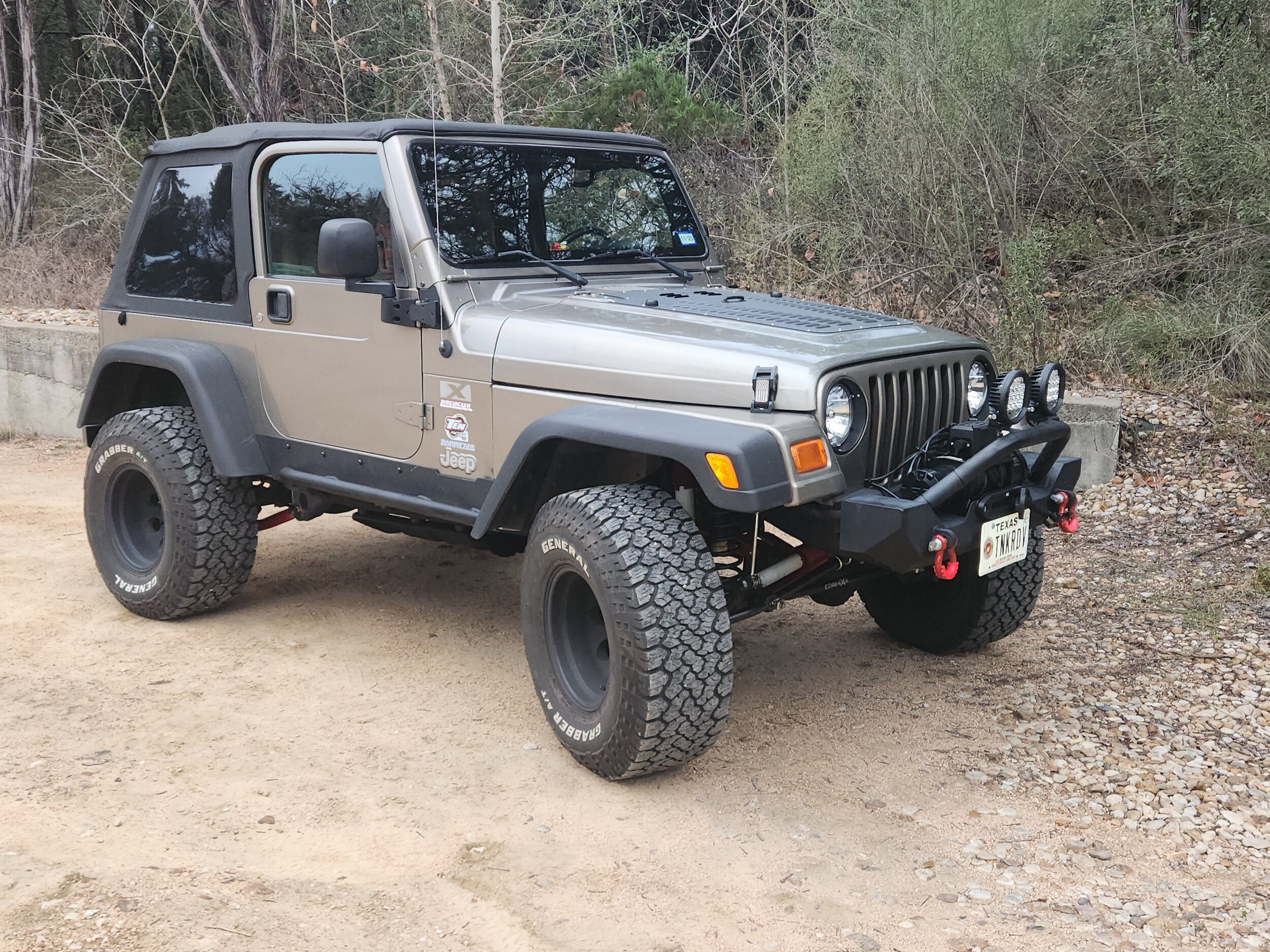

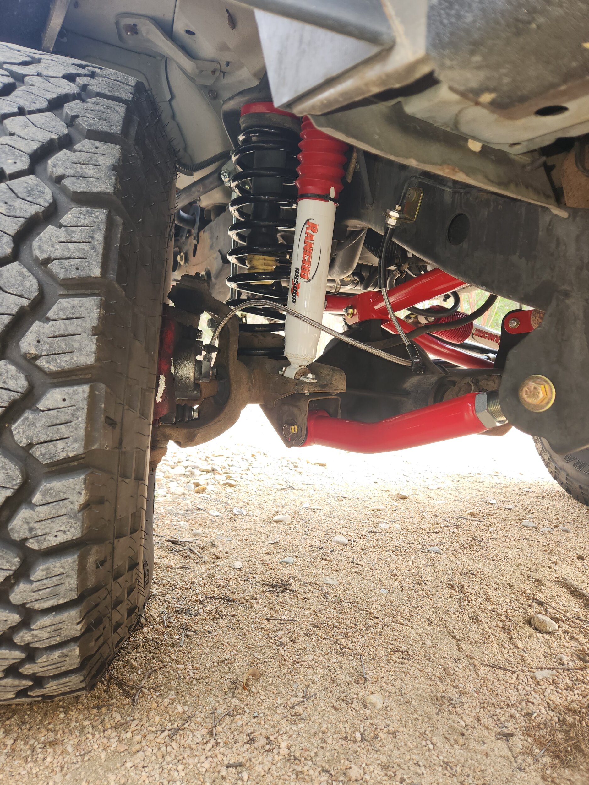

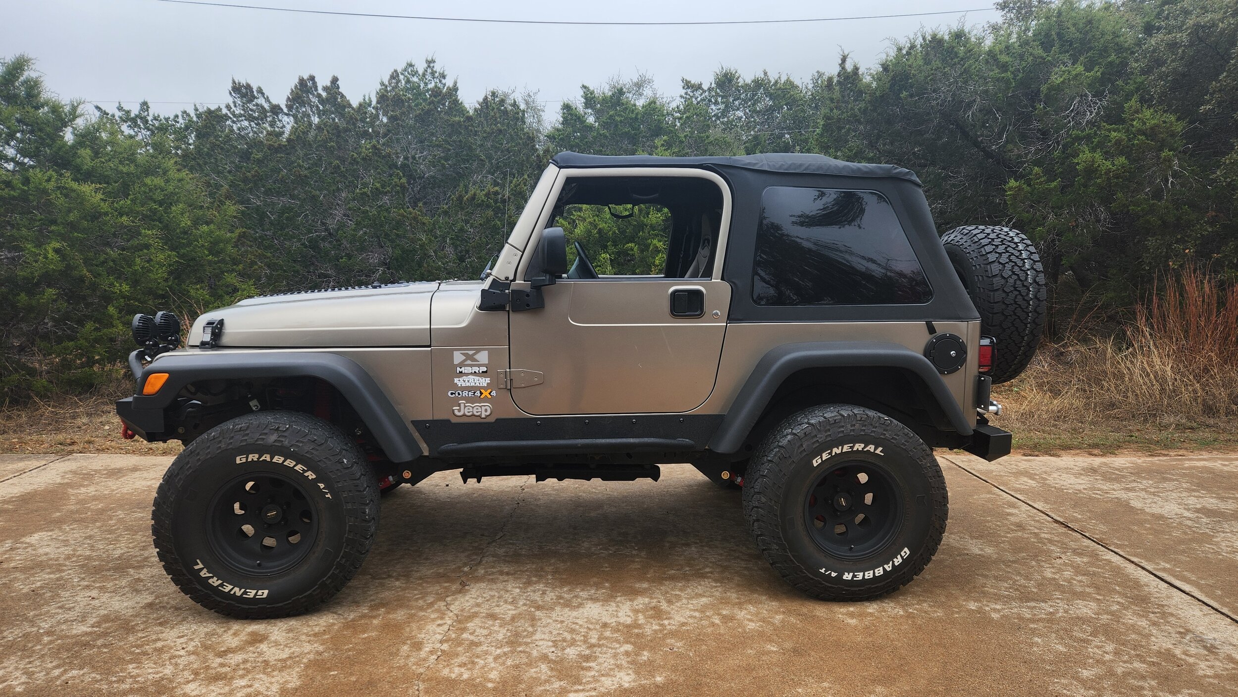

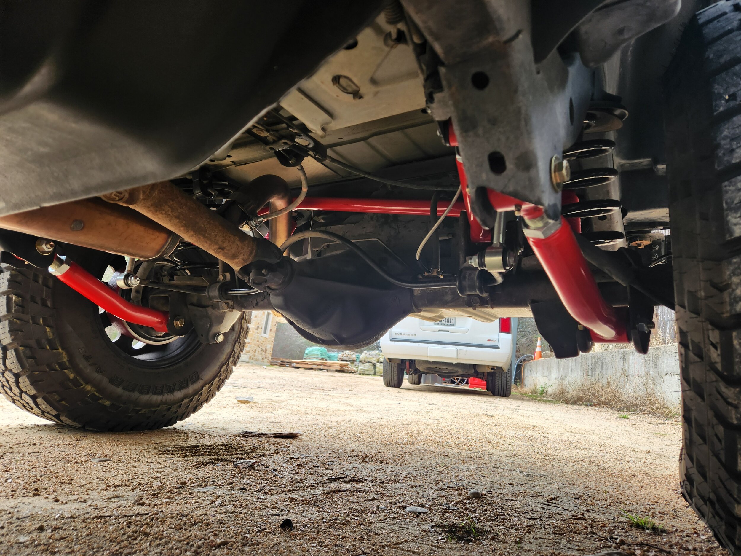

I have been upgrading my jeep over the last year and finally got to a point that I decided to work on my suspension. Yes I know I have a drop on my TC but a SYE is my next upgrade including 4.56 gears and a rear Truetrac. Currently I removed a crappy 2" lift that was a combination of JKU springs in the back and Rough Country springs up front. Never really rode well. Here is what I did. I installed Zone 3" springs, 3/4" spacer in front to level. Replaced all control arms and track bars with Core 4X4 Cruise kit which included the Currectlync by RockJock and adjusted my caster out to 6.2 to get rid of the float. I also changed the steering gear last year so that helped. I read many good things about all these parts. Yes I did save a little money on the springs but they are from BDS and American made. No I plan to take it out on its first run week after next and can't wait to see house she does! So far I am digging what has been done to it and can't wait until the SYE and gear work, but need to build more jeep funds up! The Core Kit is solid! This is sitting on General Grabbers 33x12.5x15.
