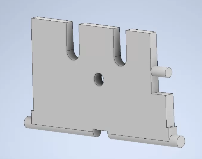

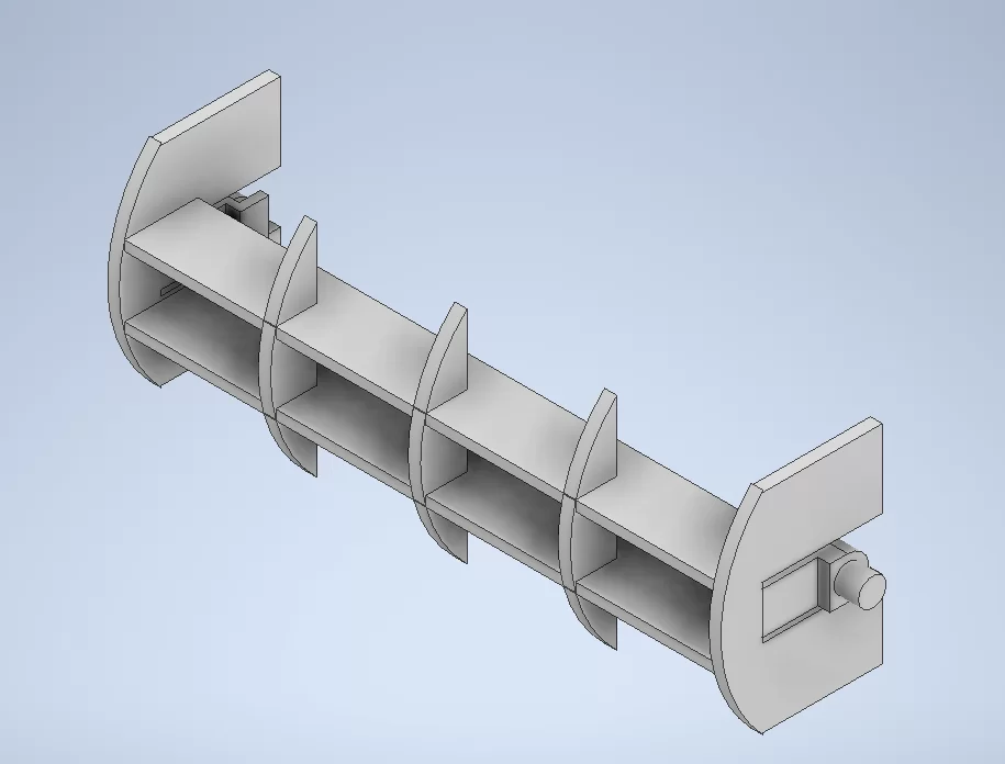

Been working on the dash cover and its almost done. Gotta finish gluing to the bezel. Going through the rest of my parts to finish the dash resto-mod, I noticed that one of my HVAC vent deflectors was broken...The adjustment flap was moving around vs moving all the parts and one of the pins that hold the whole deflector assembly was broken off. I modeled it up and printed them out.
After LOTS of trial and error, I just couldn't get the vent assembly back together. Not sure how it was done at the factory but I couldn't get things stable enough to reassemble.
So, because you can make things with a 3d Printer that you can't do with some other methods...I made an assembly that captures the little bar that pivots the deflector flaps (that was the issue trying to reassemble) and printed it out.

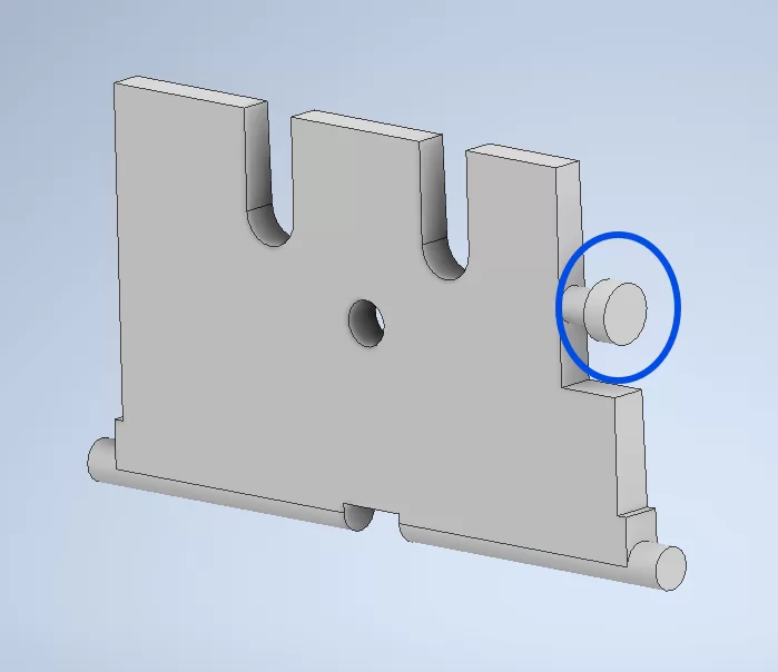

Circled is the "plug" to capture the link bar.

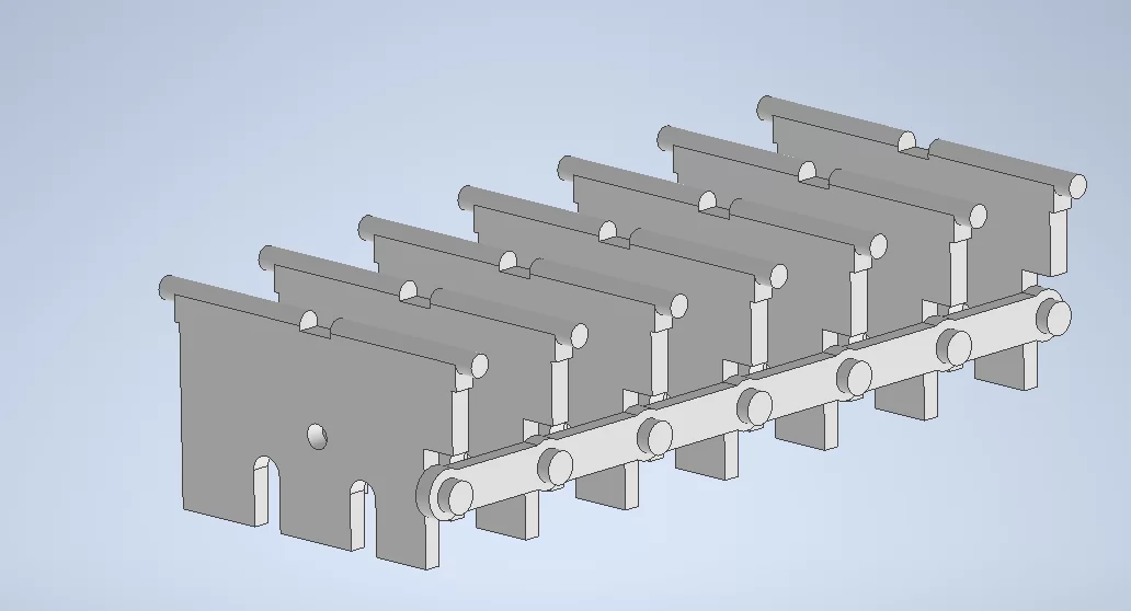

And the assembly
Giving enough clearance (I think I did 0.010 on the diameters) I printed the whole thing and once it was done, the link bar is now captured on the deflectors and it pivots perfectly. I don't currently have any pictures...Have to grab one later.
And the assembly

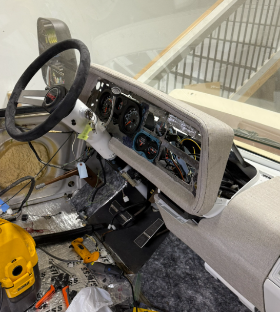

I hauled all the dash IP stuff back to the motorhome yesterday. Feels like its been FOREVER since I've worked on it in the motorhome.

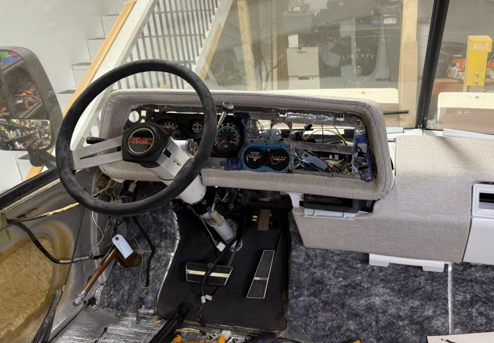

Getting the dash mounted...Had to adjust and drill a couple new holes, since I replaced the steel IP. Couldn't help myself, had to put the gages in and make sure the steering wheel was going to work.
Haven't posted it before, but I got the padded bezel covered too. I'm not even an amateur upholstery guy at best, but I'm happy with how it turned out. Sewing that was a whole ordeal...requiring me to tear the bottom end of the sewing machine apart, clean, and retime it. But, it works WAY better now. Gave me the confidence to try a top stitch. Its actually pretty straight, but the seam wandered on me a bit when I glued the fabric down. Like I said, less than amateur.
I have LOTS of wiring to do in the next couple days. My goal is to get this thing installed this week. We'll see how much time I get to work on it. December is always a busy month.

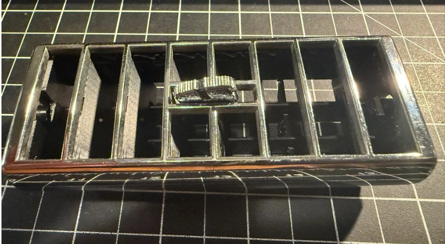

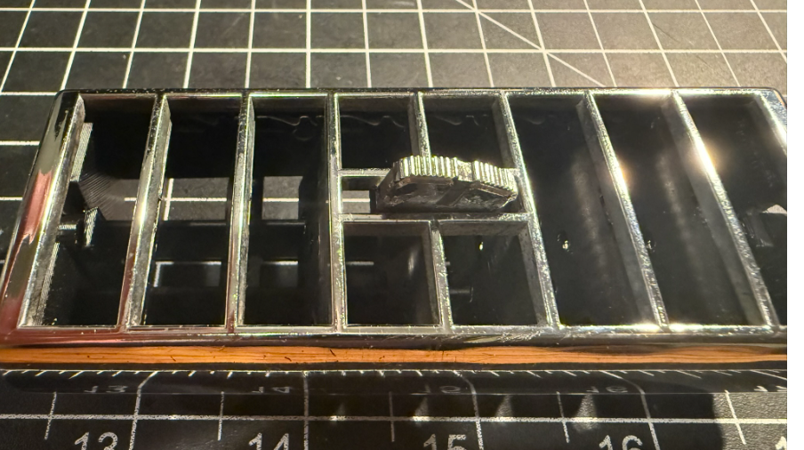

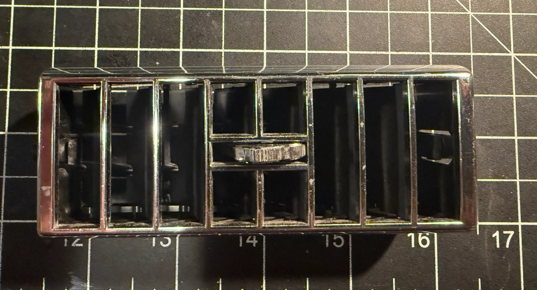

This is the factory vent. Two pics to show range of motion on the adjuster.
This is the one I made. The chrome is still the factory part, but all the "guts" are new. The biggest issue with it comes down to range of motion. It will physically go the same distance, but not with the adjuster. I played around with it last night and got it better, but its still not perfect. Good enough for me, but its not something I would want to market or anything. I took apart the factory one and don't see any major design differences, so I'm thinking its just the way the print came out. I could probably do something in my print settings to make it better, but like I said, it works well enough for me. I'm not going down that particular rabbit hole!

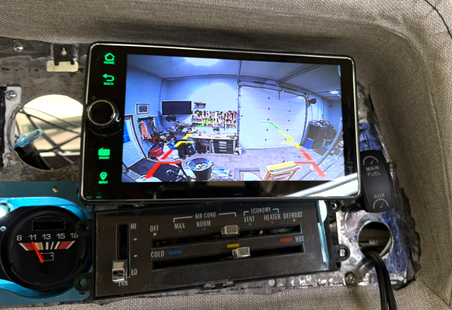

I was pretty excited to see this happen when I shifted the transmission into reverse though...This is going to be a REALLY nice feature going forward. Needs a little aiming (since its mounted high up), but honestly, if that is the final position, that should work too. You can't see the bumper, but the ladder in the foreground on the RH red line is the Ladder to get on the roof, so its close.
I can't quite see my rear bumper either (camera is fixed) but what I did was lay something on the ground at exactly 3 feet from the back then put a small piece of red pinstriping tape on the camera screen in the cab. Do you have side cameras too?
