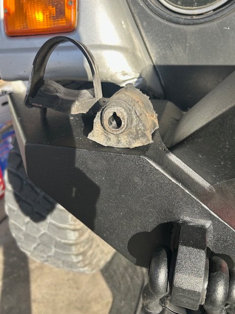

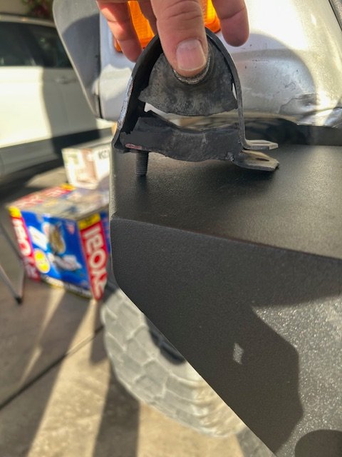

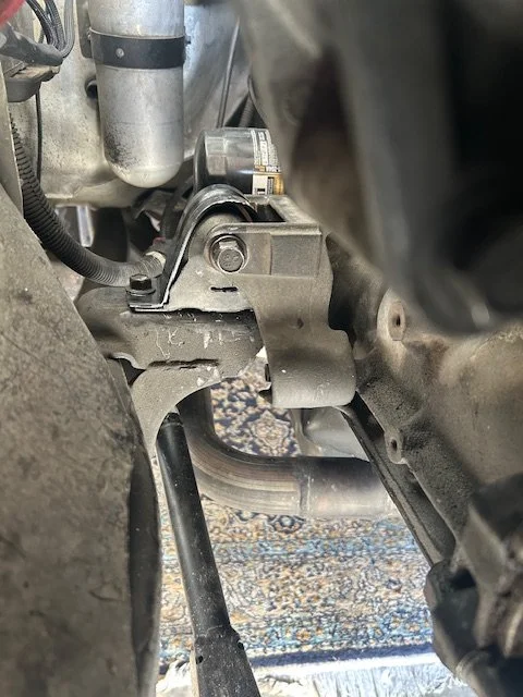

Well, I narrowed down the dash vibration to worn motor mounts. This weekend I crawled underneath the Jeep to have a look and realized that the driver side will be somewhat challenging. Any helpful hints on how to attack this project?

Ran into same problem scroll through bottom 1/2 this thread post #9 and it was my fix. Pushed the bolt out as far as I could, cut it with a grinder and replaced with a new bolt from other side. I couldn't figure out any easier way

Remove the bracket from the engine block on that side. Take the bracket and motor mount out the bottom. That will save your bolt. When you put it back in put the bolt in the other direction.

You need them if you go the other route and remove the intake and exhaust for better access. I did it this way but was also installing some headers at the time. It's still easier to unbolt the bracket from the block if you have AC.

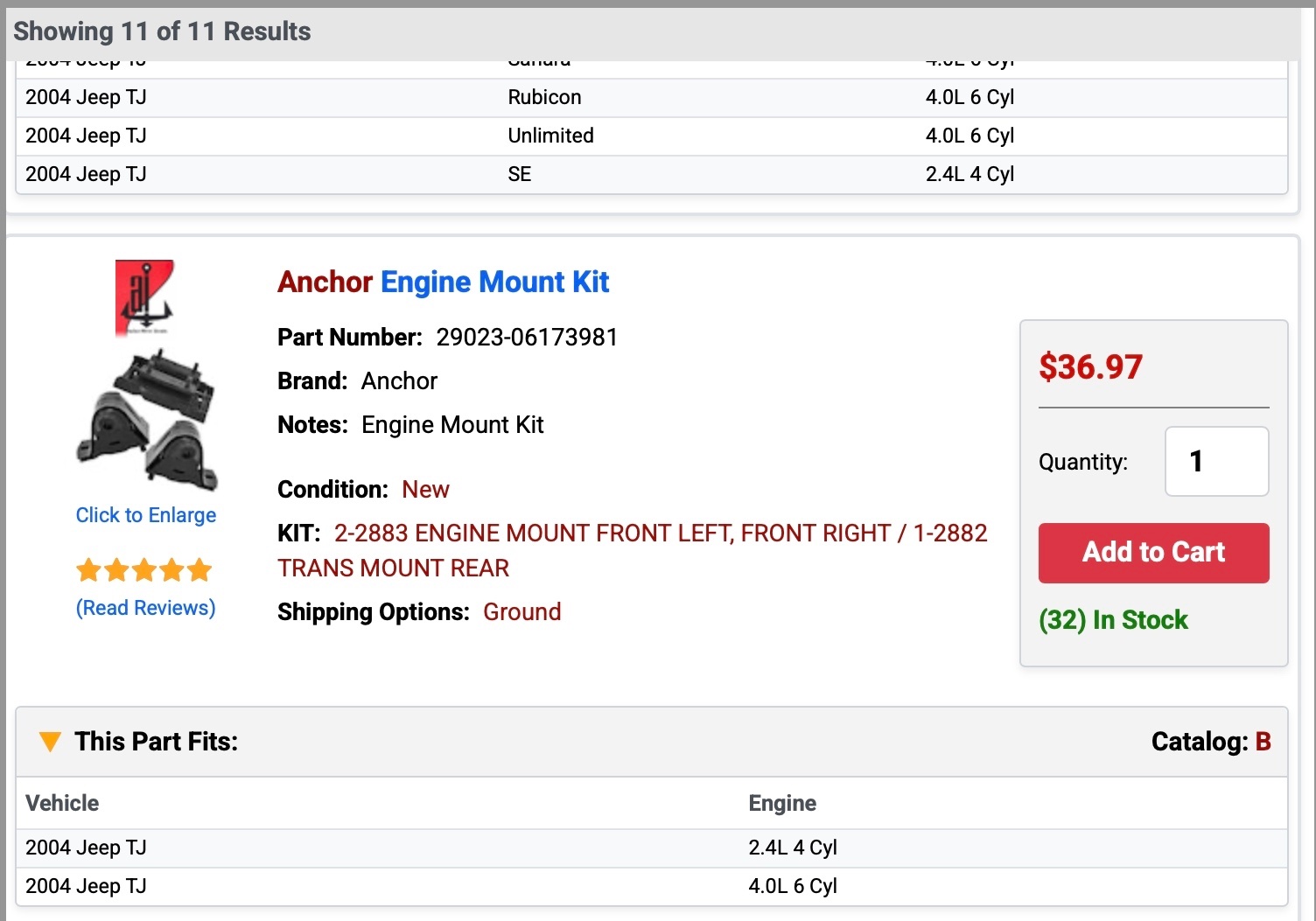

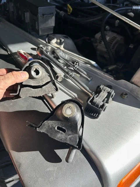

And if you haven't already done the install, get the Anchor brand mounts. They seem the best at the current time. The ears on the OMIX ADA ones from India are too narrow.
