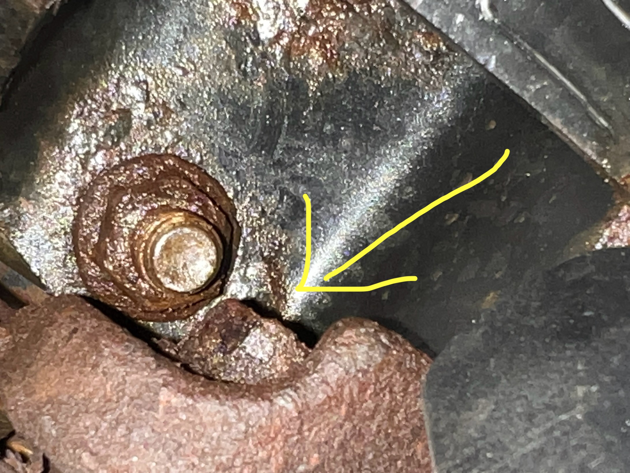

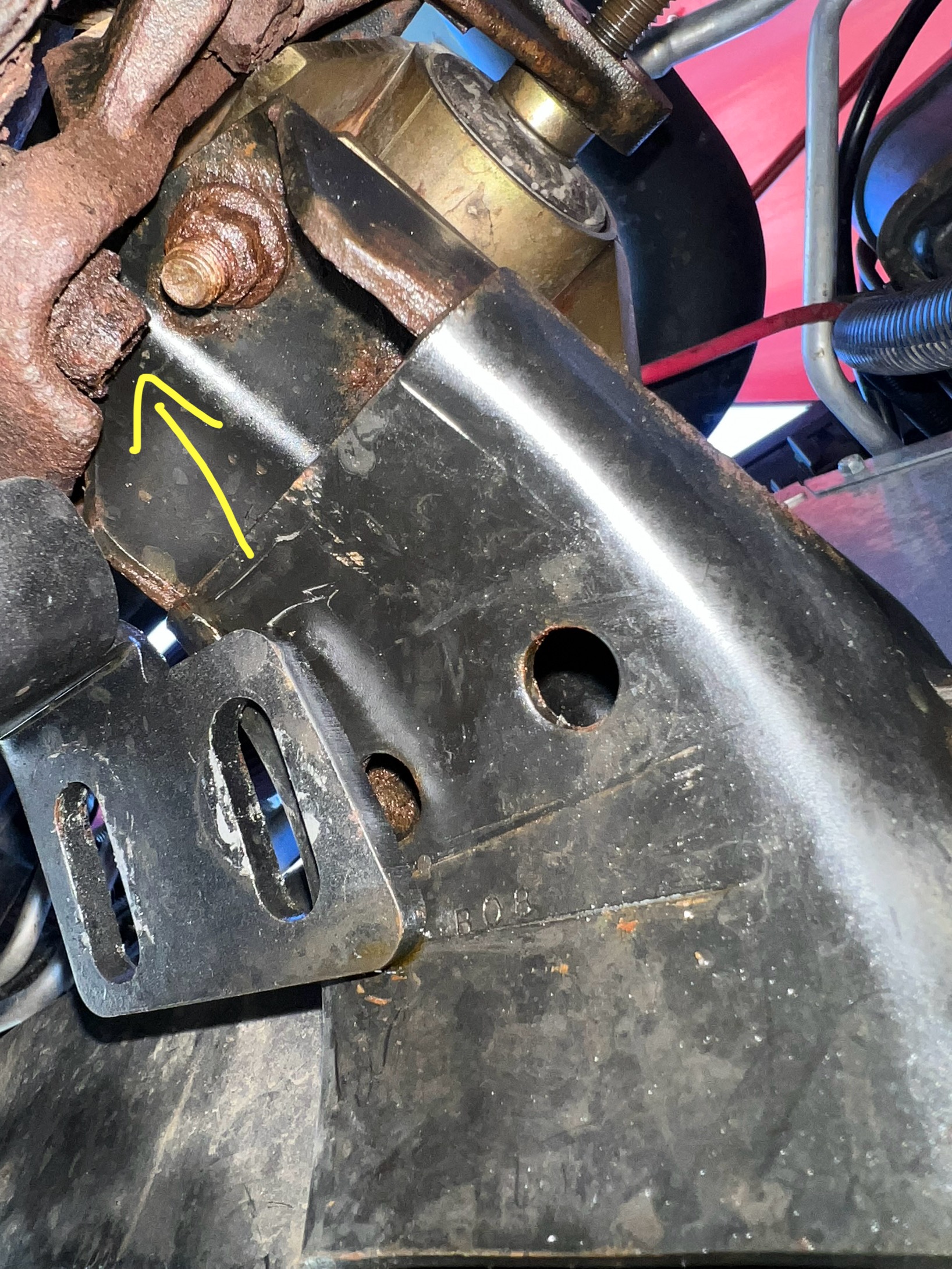

I am in the process of replacing my motor mounts. How do I get this nut off?, there is another head bolt in the way of allowing me to sit the socket flush. What are my options here. This is on the passenger side 2003.
I removed that bolt first, then the nut. Put the bolt back in after the MML. Torque bolt to 45 ft lb (if you can get a torque wrench and socket in there).
