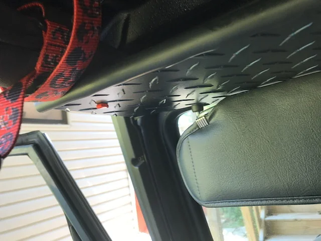

Here you go. I used a piece of 1/4 inch diamond-plate, [came out of the 4x8 piece that my tonneau was cut from] notched it out for the visor ends and visor clips. Had to add an extension to the clips. Bolted it on the side rollbars through holes that were already in the bars, glued a piece of thin rubber to the top [smooth side] and a piece of slit hose for the front edge. There’s a nylon strap in the middle to hold my firearm. I can get my Marlin 1894 and Marlin Model 24 pump to go up there in a pair of lightweight gun socks. And of course it holds small stuff too.
