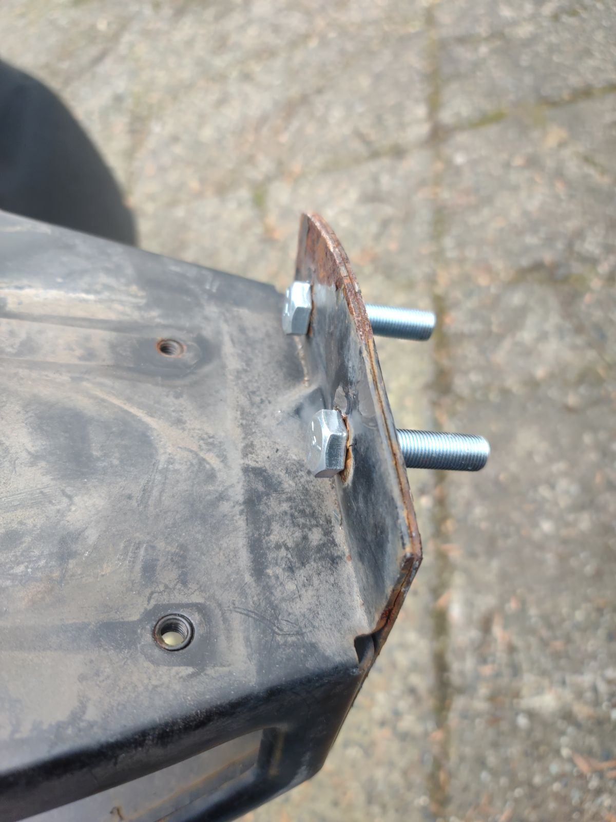

Instead I decided to grind off the spot welds on the stock studs and add some new 2" long bolts (I think - maybe 2.5" - verify for your case). I then tack welded these on (so they don't spin) and cold galvinized them before a coating of tremclad on all the sides that needed it.

Didn't take great pics but have some attached. The pics just show the concept and the result - the result is underwhelming as it looks like the stock look - but that was exactly the point here. Note the black spacer is 1" as I wasn't sure what I needed and cut both a 3/4" and 1".
