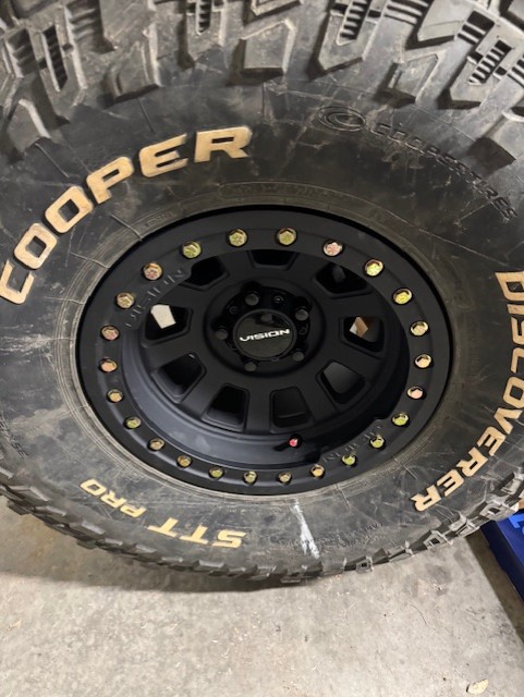

Sold the coyote boltless beadlocks that sat on my shelf for 2 years and the 4 wheels I bought from quadratec.

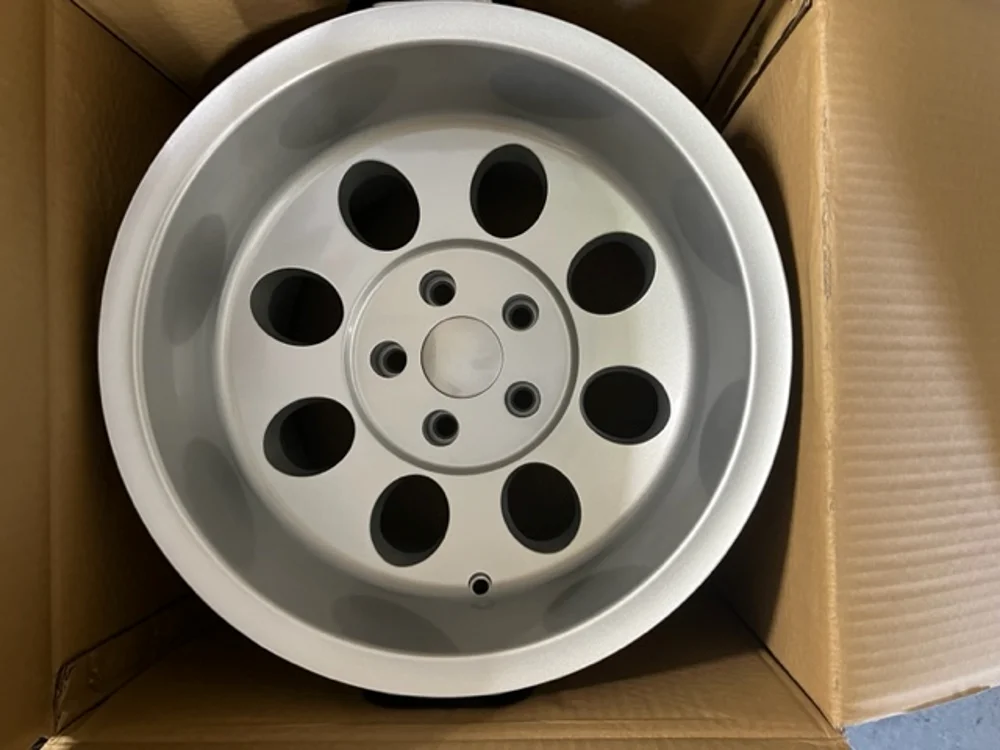

Bought vision beadlocks. I wanted to go with 17" but it would have been 50% more expensive for the wheels and then $2k for new tires. If I ever get tired of the 15" I'll just sell them.

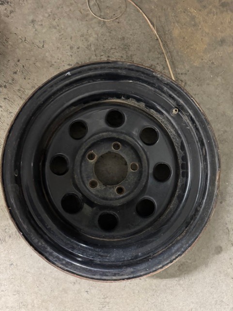

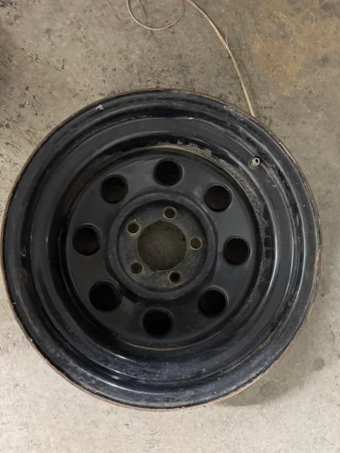

Old steel wheel weighted 25.5 lbs
New Aluminum beadlock weighted 28.8 lbs. I'm pleased the weight wasn't more. I installed the first one today and it was easy getting the tire on the rim and I didn't even need to use screwdrivers to get the bead set before installing the ring. I think both of those are due to the tires being used and not new. I drove the tires to discount tire and paid $100 for them to remove all 5 tires from the wheels and I was back home in under an hour. I was a little worried they wouldn't give me my space tire back. It's from 2012. I'm on the fence whether I should go ahead and replace it or just wait until the 4 used tires need replacing.
