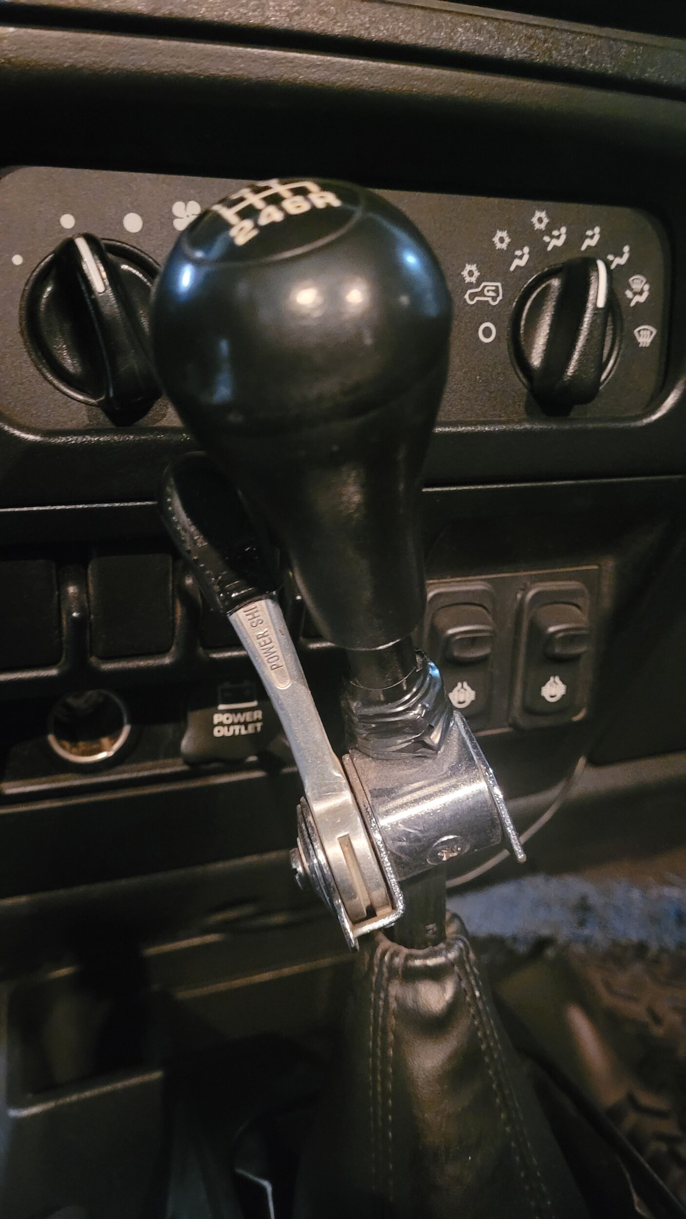

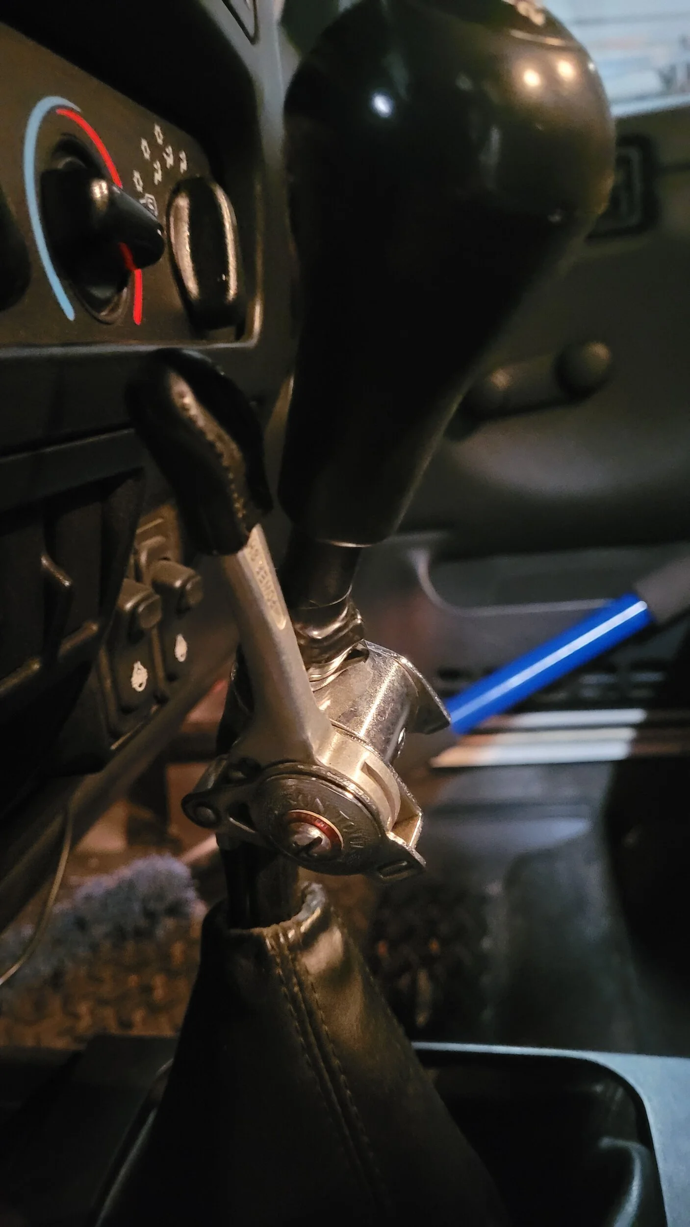

Here is mine made from an old 10 speed bicycle friction shifter I had in my pile of bike parts. I upgraded the 10 speed to a flat bar 14 speed with a granny gear for hills.
I run it with my index finger and thumb when my hand is on the shifter. First gear is tight and don't pull the Jeep out of gear messing with it.
At Moab, in 4lo, 1st gear, I could do everything I tried by setting the RPM and leaving it along while driving. Usually 2300-2500 RPM and goose the pedal if needed. But I never did. It didn't take more than a couple hills to guess the RPM needed before starting. Then clutch and brake were free to operate, but barely needed.

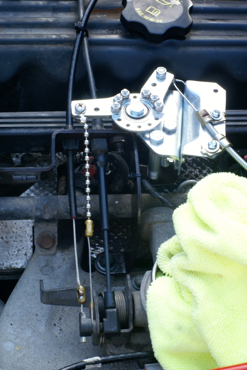

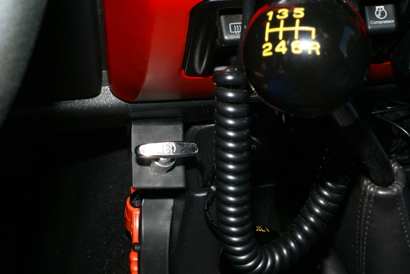

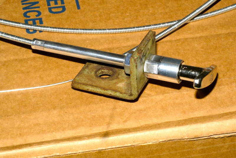

That is basically what I did, although what I used *is* intended as a hand throttle:
It works well for a trail jeep, I really like it. With that said, the cable isn't as flexible as a bike cable would be as it has a solid interior wire. That necessitated use of a bell crank:
