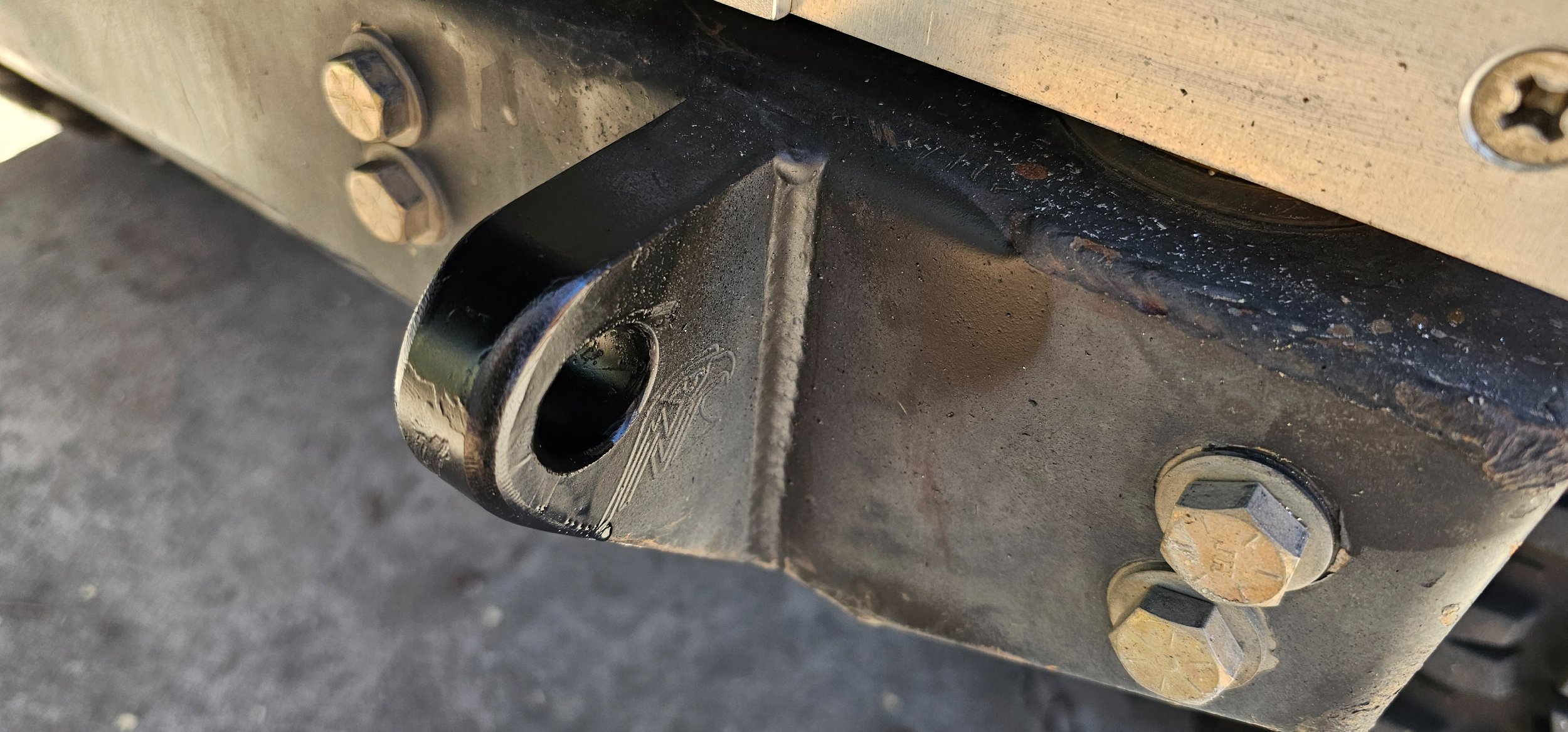

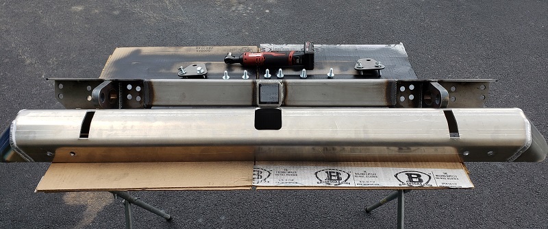

I picked up a UCF rear bumper with the Black Friday deals and was curious the best way to round out the d-ring mounts to be a bit more friendly to soft shackles.
Still waiting on my bumper, I found the image on here a while back. My apologies on not giving credit.

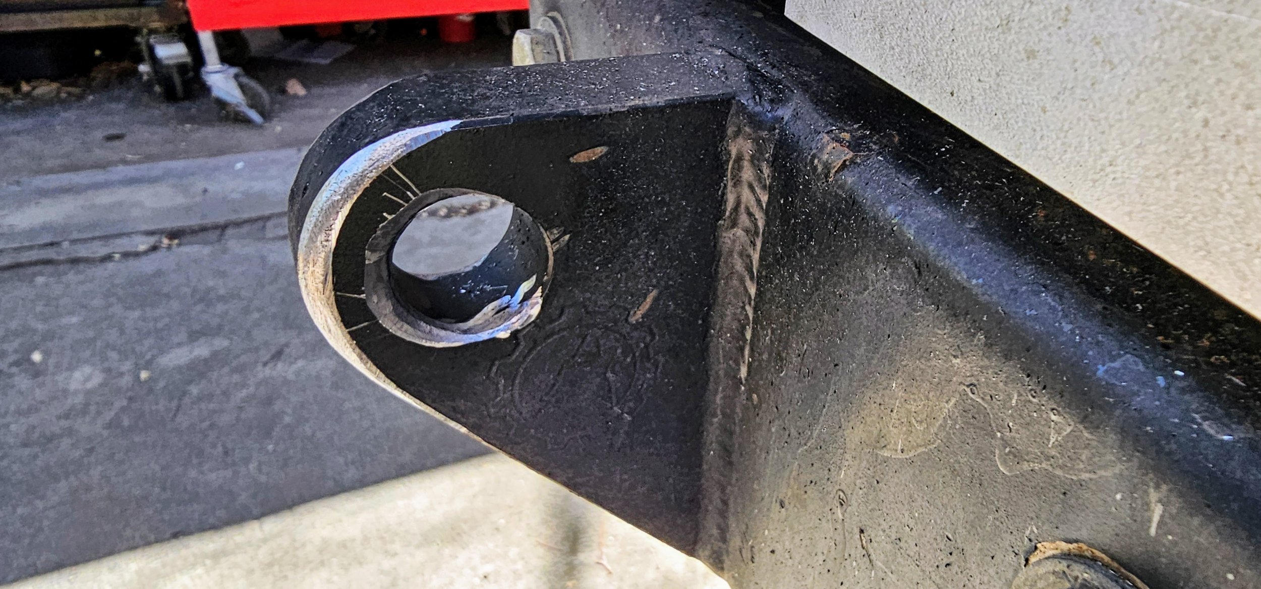

Flap disc on the outside. Die grinder with a carbide burr on the inside. The only parts you care about rounding over are where the rope contacts the bumper tab during a pull.
I started with a big step bit, moved to a carbide bit on a die grinder and finished everything smooth with a little 1/2" flap disc sander bit and a 2" roloc.
-Mac

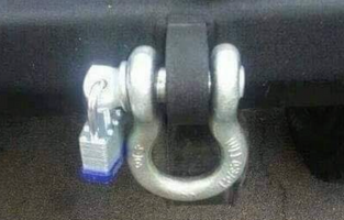

I personally use a standard shackle then put my soft shackle onto it. I don't have to worry about scrapping the side of the soft shackle. I know a couple people who's soft shackle wouldn't fit into their bumper anchor points for one reason or another.
In your usage, what is the purpose of the soft shackle when it is attached to a steel shackle?
So I don't have to take the steel shackle off the bumper or feed a soft shackle through the 3/4" hole in the bumper. It makes the connection and disconnecting go faster.
It's honestly been a while since I've used a point in my bumper that needed a short shackle. The last time a point was used was going over a steep rock face. Then we just hooked the winch of the Jeep behind me up to the steel shackle. This allowed him to ease his winch out as I went over.
