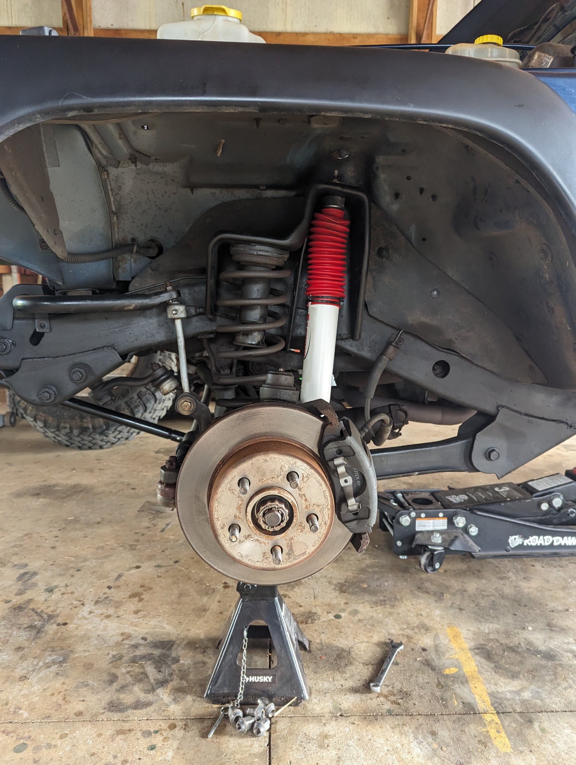

Put on ranchos yesterday, drained the transmission and removed some rust. Today I have some people around to help so will be dropping t case and transmission. Was kind of wondering if I should take off more of the shifter, seems to be fine to drop it how it is. See photo.

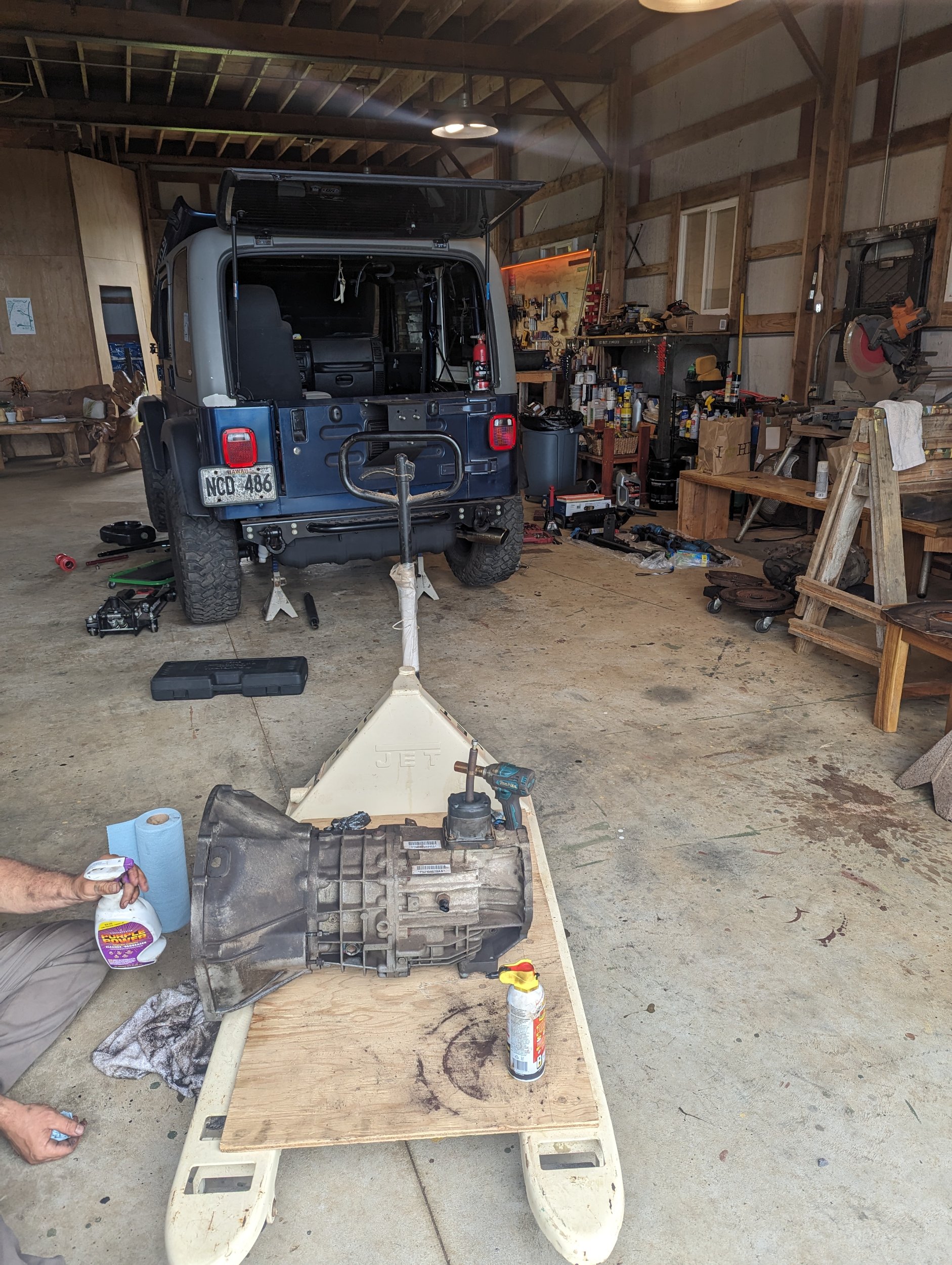

Of all days, we are getting a tsunami here as I'm dropping the transmission. T-case out, transmission out. Tob, pressure plate, clutch and pilot bearing were all shot. Glad I did it! Retaining clip for fork was fine. Flywheel is fine, probably replacing it anyway. I know not to resurface it. Install on schedule for tomorrow. Thanks everyone.
UPDATE*
Everything went on smooth today, definitely helped to have someone with me who knew what they were doing. He tackled slave side, I tackled the starter side and then pulled it off behind on each side no problem. Without the transfer case this was very doable. Which also honestly took both of us to get from under the jeep and back on. Conclusion on the clutch kit was the luk. If you are in a pinch I think the power torque is a good option though and you get the all metal tob.
