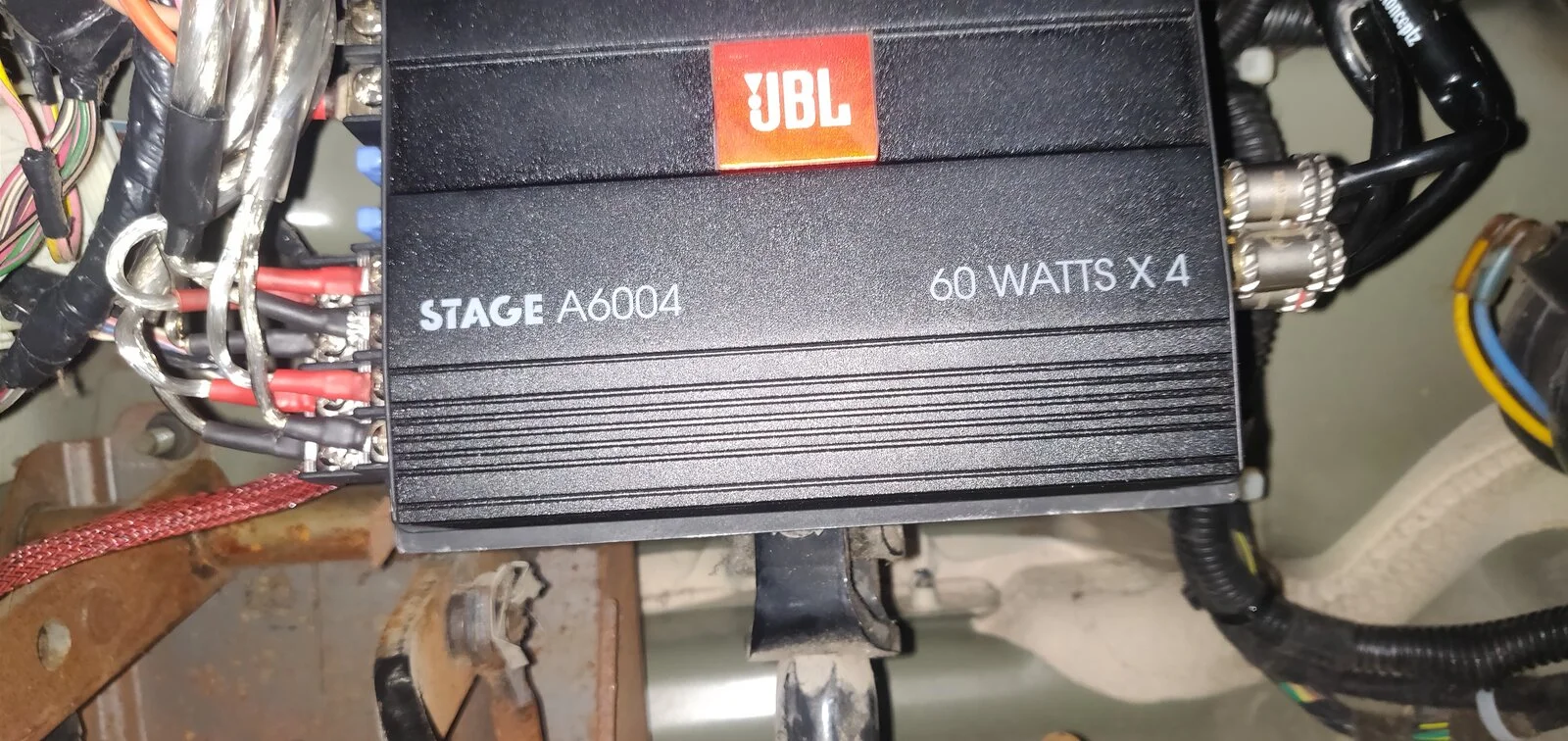

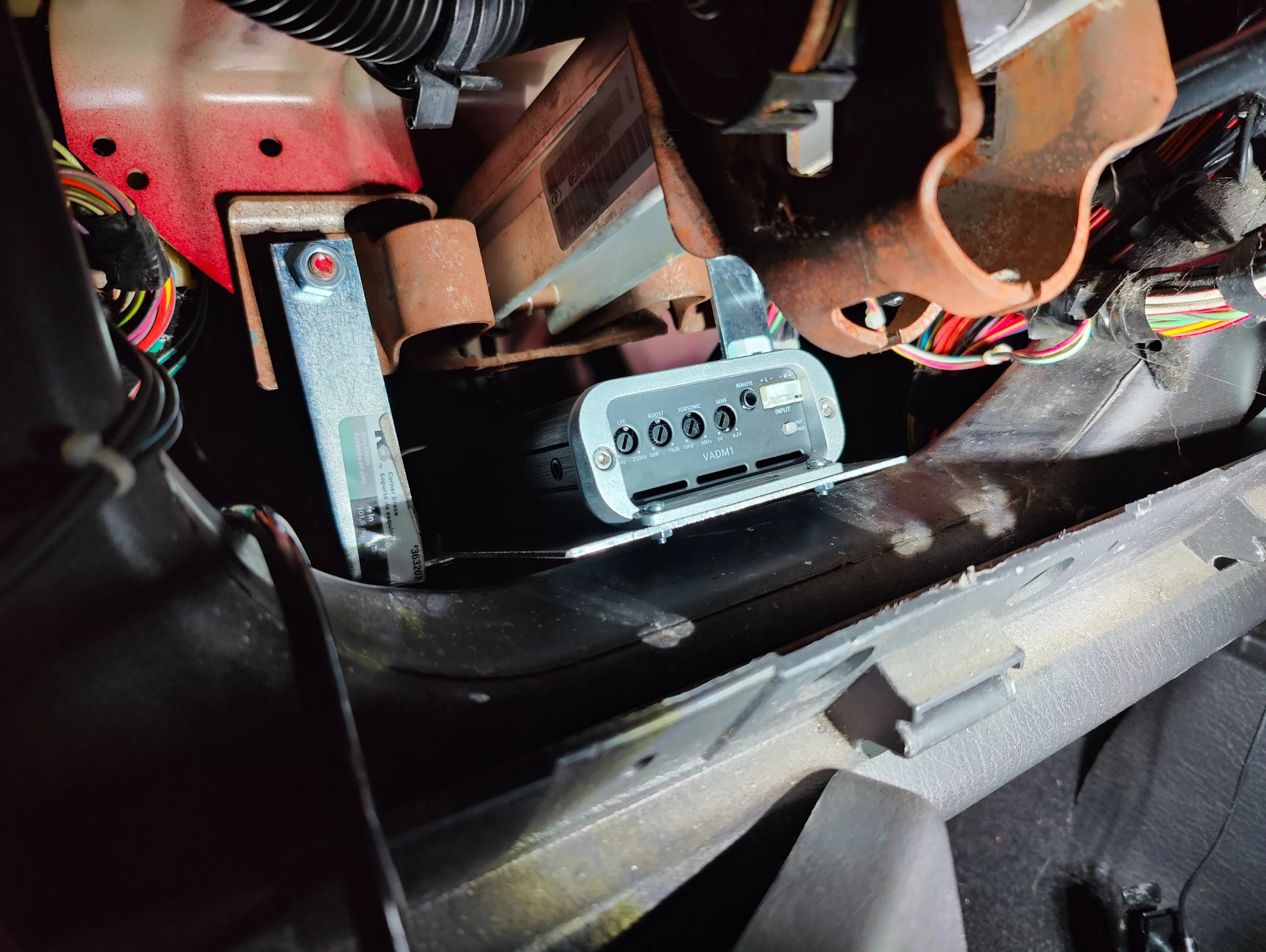

I did the same thing you're talking about. Used a JBL a6004. You just need a plate that will bolt it to your steering column.

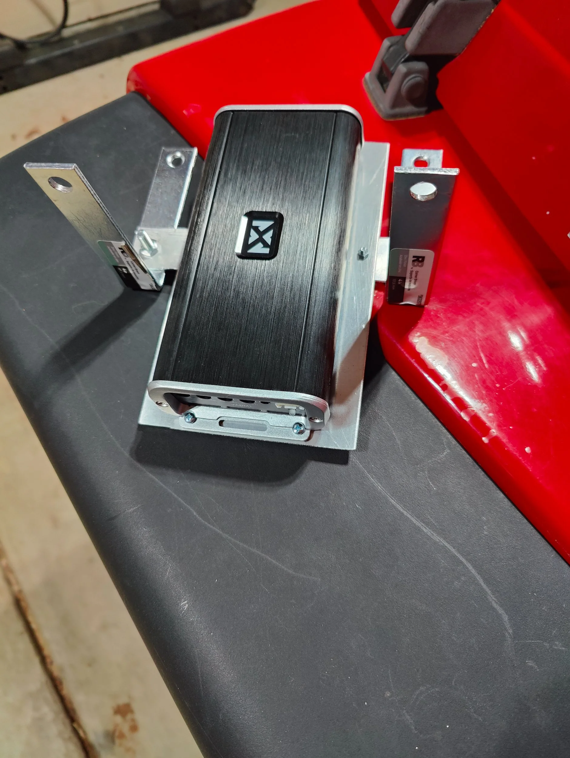

I ended up getting the NVX VADM1 to power the Kicker Comp RT 6.75. I used a Skar 8ga amp kit to wire it. The headunit is an Alpine ute-73bt. One problem I am having though is the sub isn't very loud unless I really turn up the bass on the radio. The 5.25's in the dash are louder and they are powered buy the headunit. I went to adjust the gain on the amp with a voltmeter and I couldn't get any reading on my voltmeter when set to 200AC while playing a 60hz tone. So, I decided to check the voltage on the RCA cables and jacks coming out of the headunit, and I still got nothing. Maybe my voltmeter isn't good enough to measure the 1-2V AC on the RCA jacks, but I would have thought it would have read the 20+V AC on the amps speaker outputs. My other son has the same headunit, so I am going to try and measure the voltage on his RCA jacks next weekend. I guess it could be a bad headunit. It was bought new back in December. Let me know if you think of anything to try. Atleast the amp install looks nice.

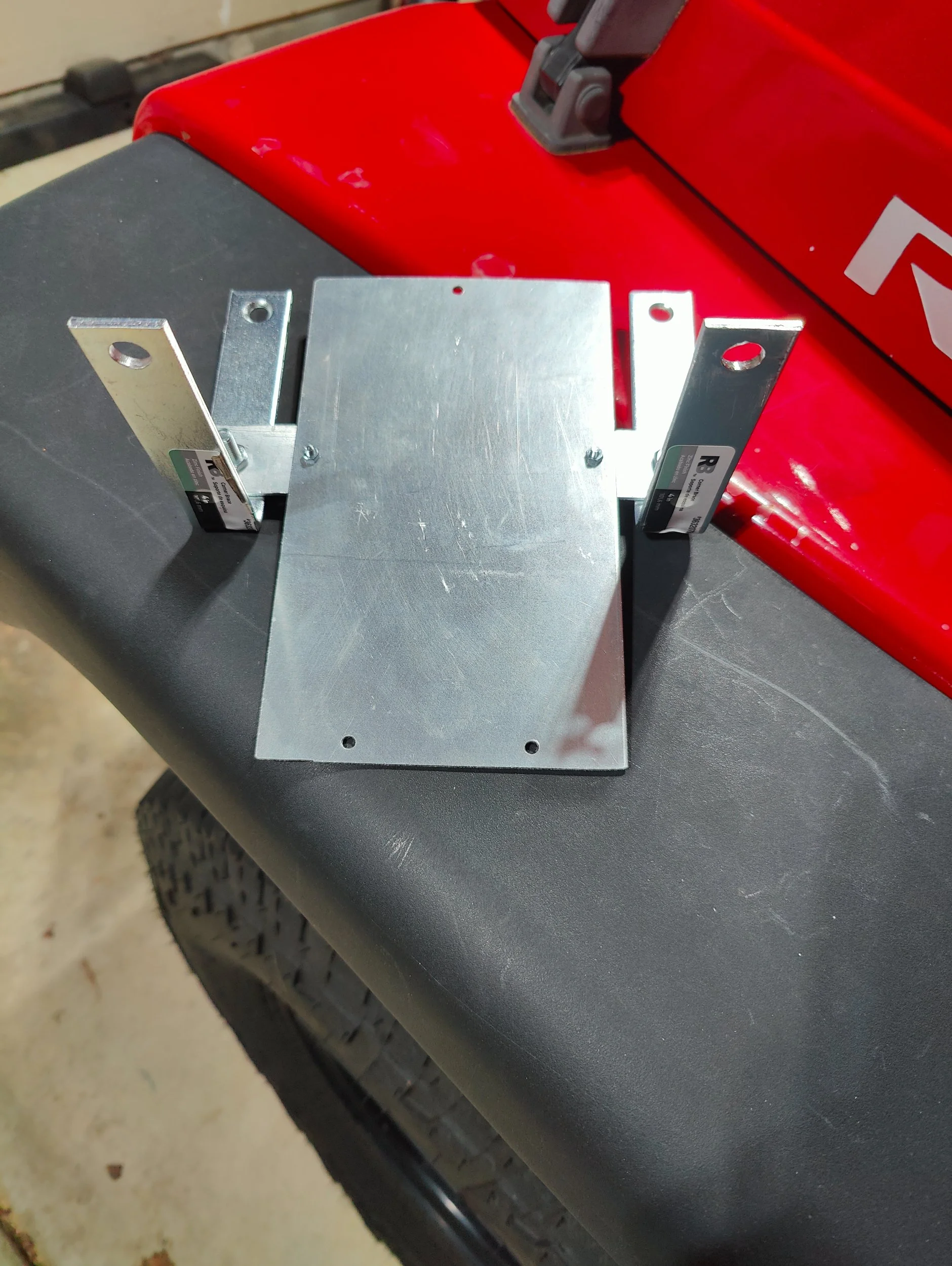

Bracket I built for the amp.

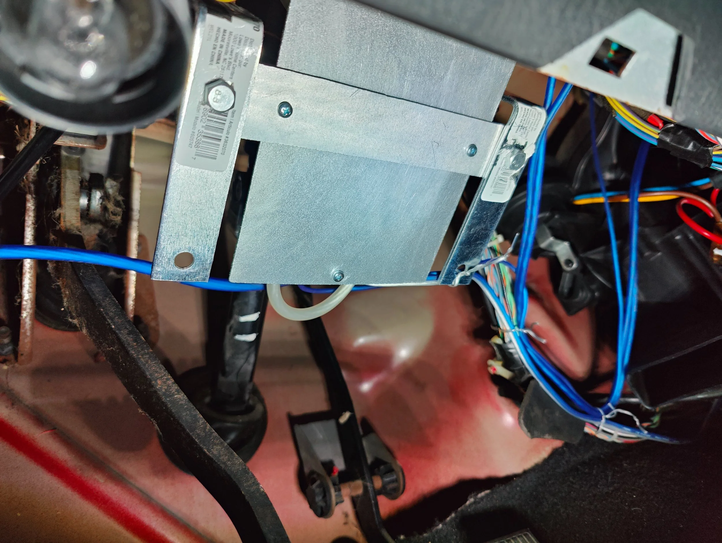

Test fit.

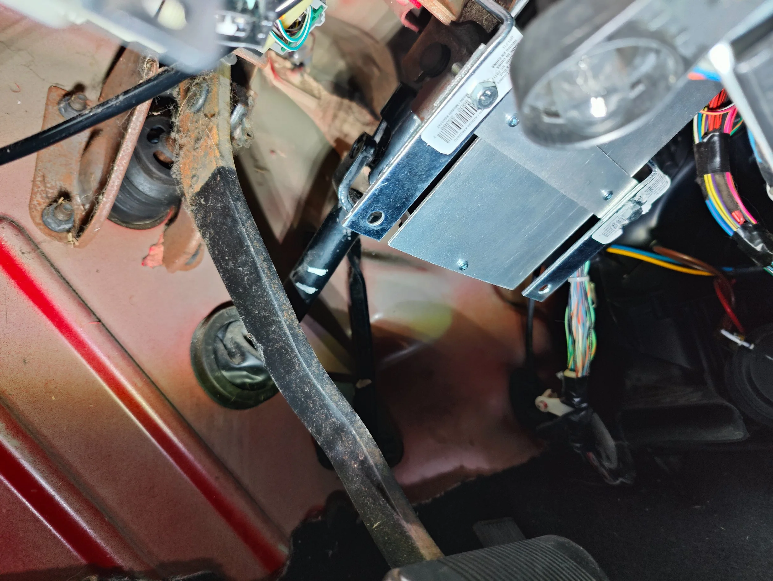

Wired up.
