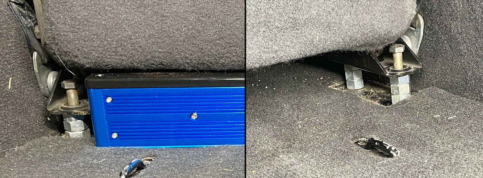

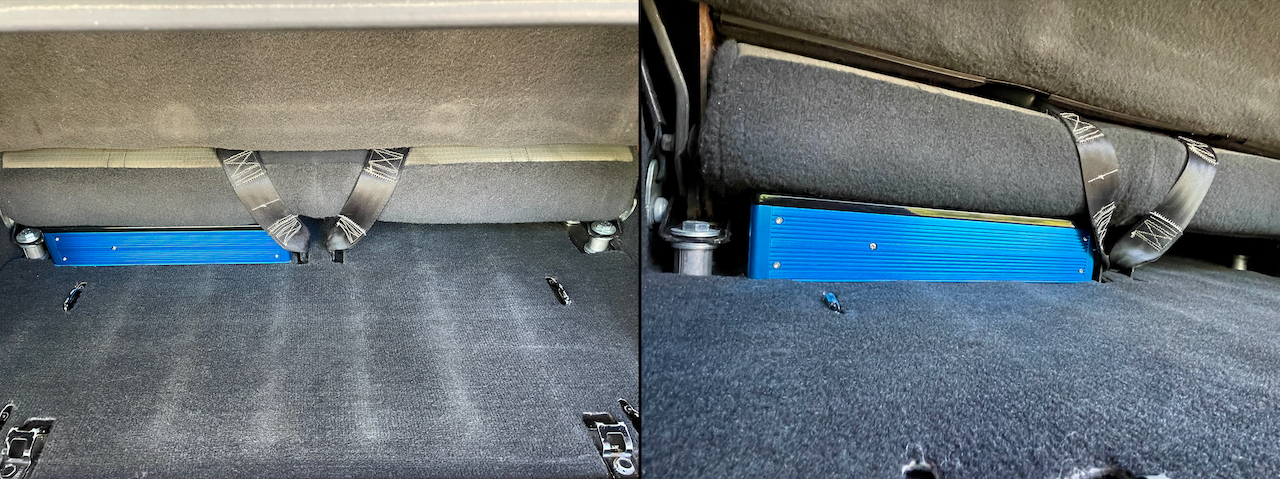

Also, where did you source the spacers??
Had them from another project but any big box HW store or Tractor Supply will have what you need. I just stacked hardware temporarily to get the right height, then used similar sized spacers and longer bolts.
  • Wow
Reactions: CreepinDeth
I’ve got 1/2” aluminum block spacers under my rear seat to accommodate my 8” sub in a sealed enclosure.
Currently setting up 1 1/2” blocks under my sons rear seat to accommodate his 10” sub.
