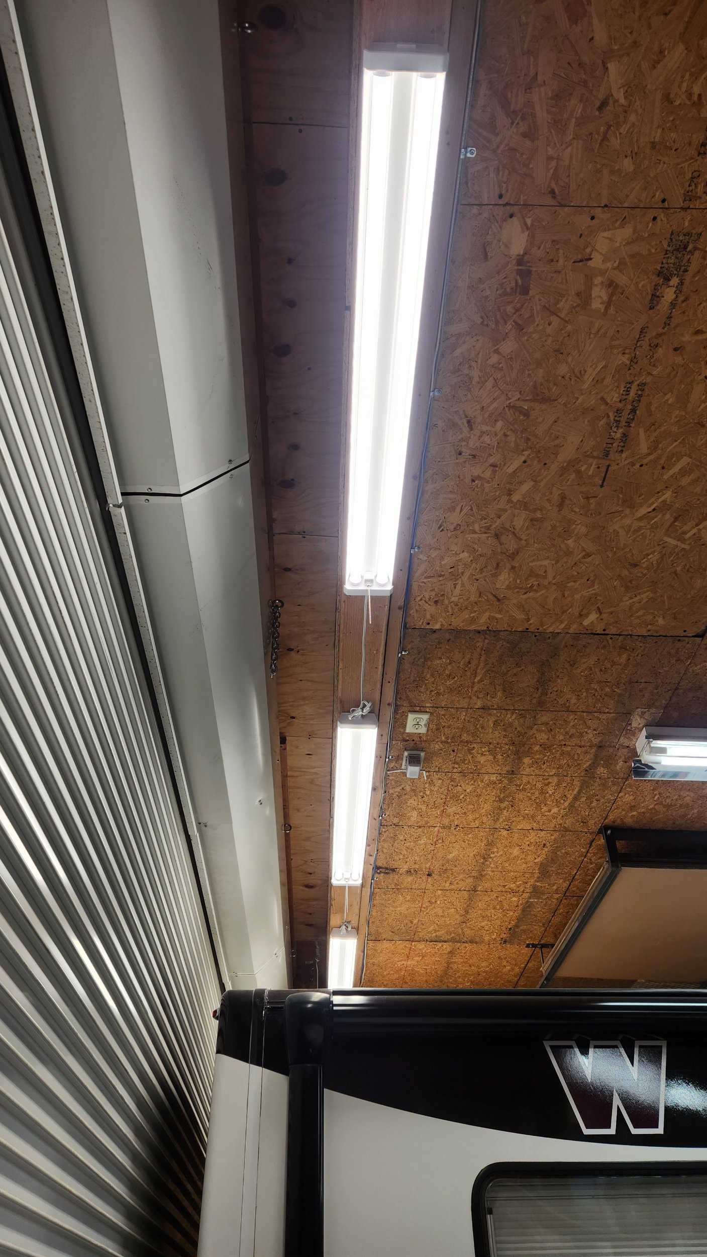

excellent fix. I could probably do something similar since i have the garage door receptacles close by to provide power.
I actually fished some wire over there from the main lighting circuit so they come on with the main switches but I also installed another switch on the wall so if I want to keep those 3 from coming on I can. They have chain pull switches but too high up and in your case they would get hit by your overhead door.
At my old place, I mounted 8' lights on the inside of the garage door (just below the window line), and I ran SO cord along the track w/ enough slack to allow the doors to fully open & close w/o any binding.
This provided exceptional lighting w/ the door up.
