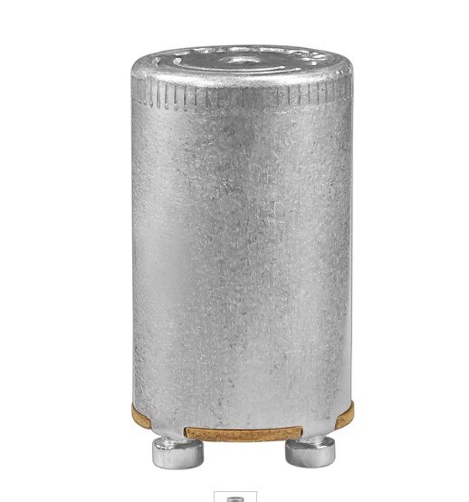

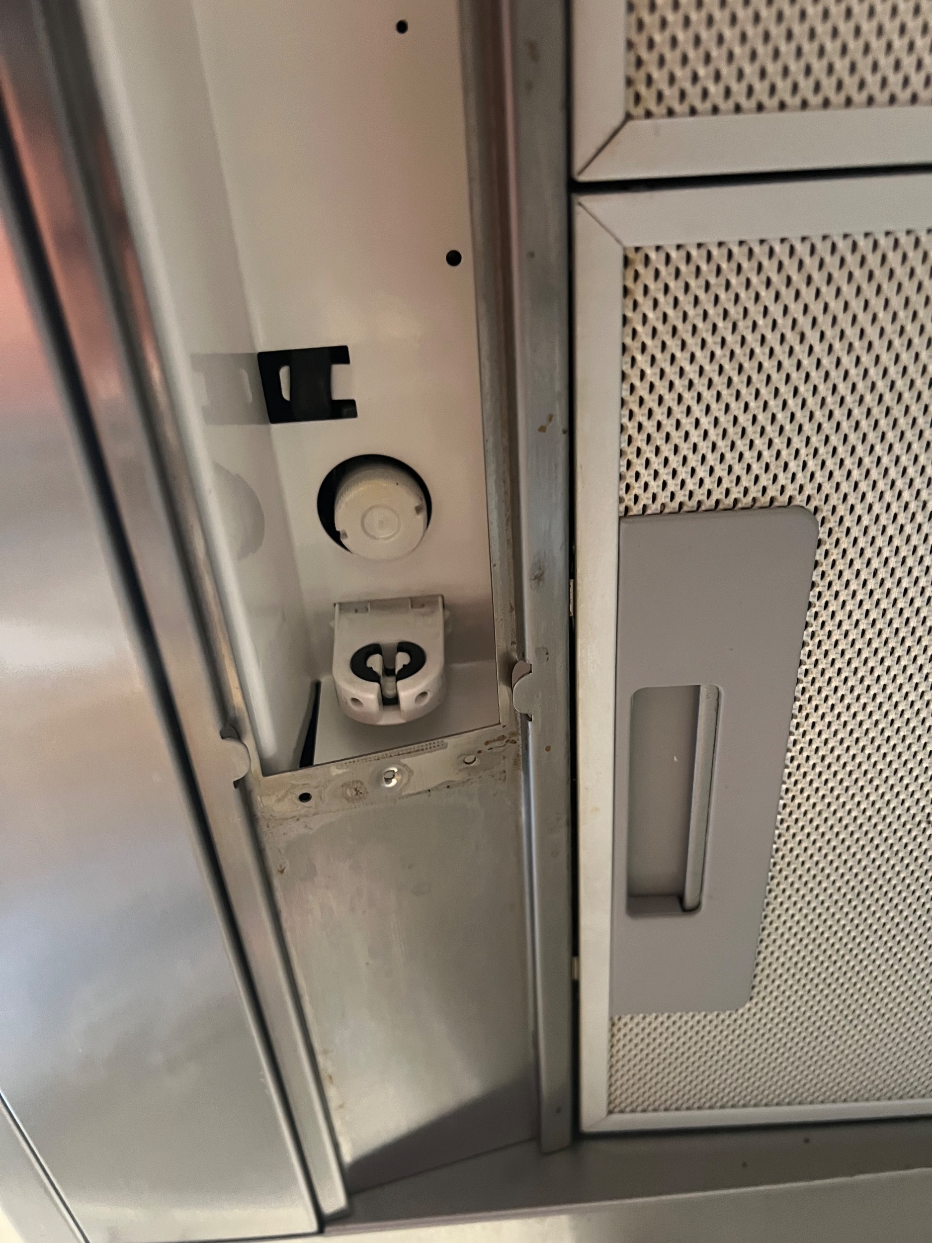

There is not much room to be doing re-wiring. Is the starter what I see in picture #3
Yes that's it! Push it in and twist, it will come out. Then replace with an LED "dummy" starter if it's too hard to open the fixture and bypass. It's possible the new LED tube is damaged from trying to use it with the fluorescent starter.
