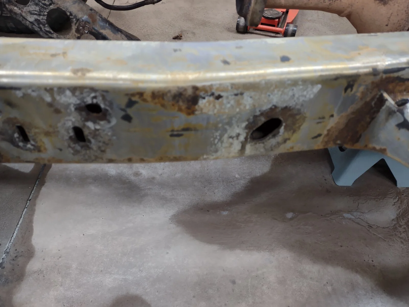

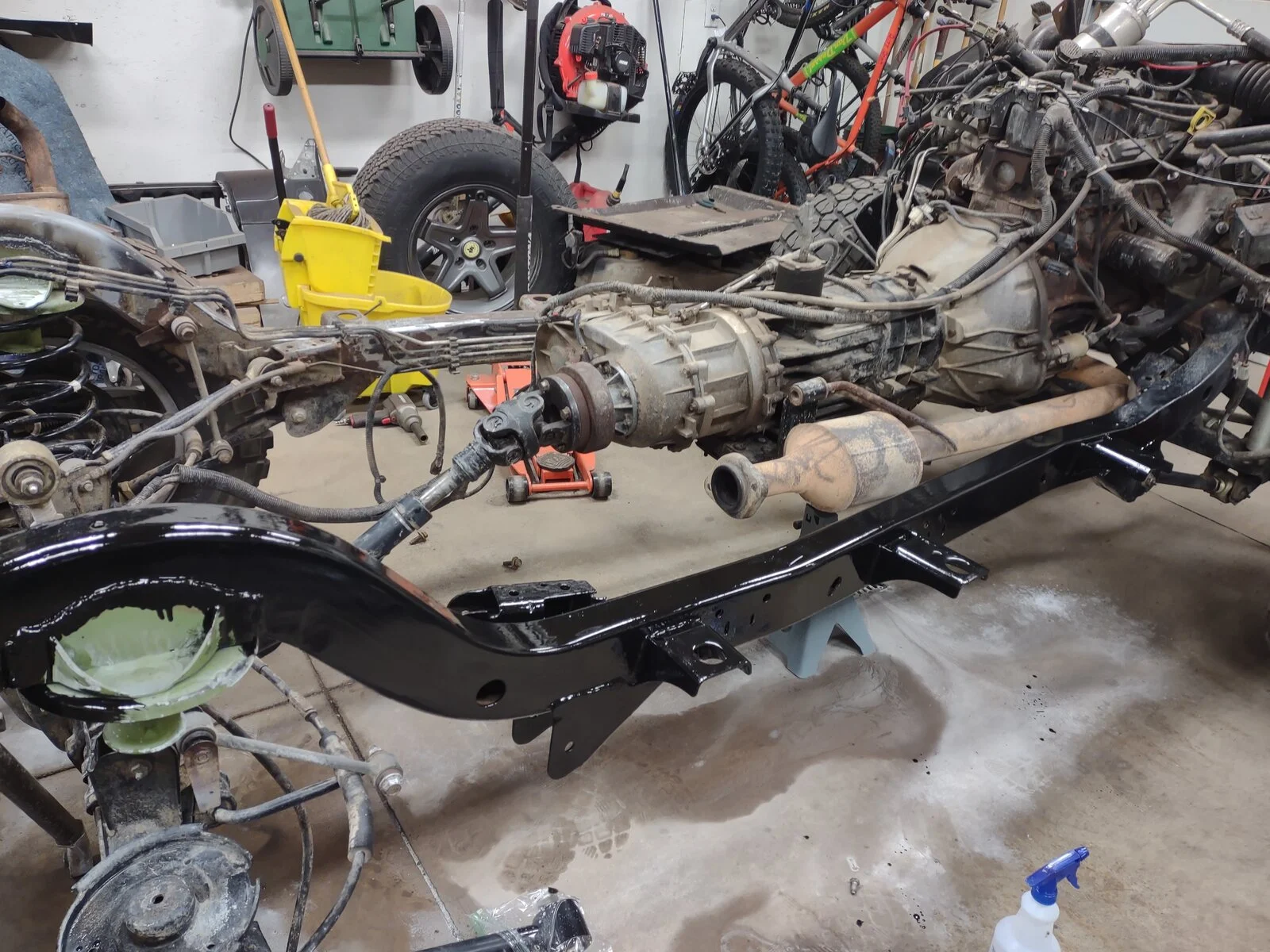

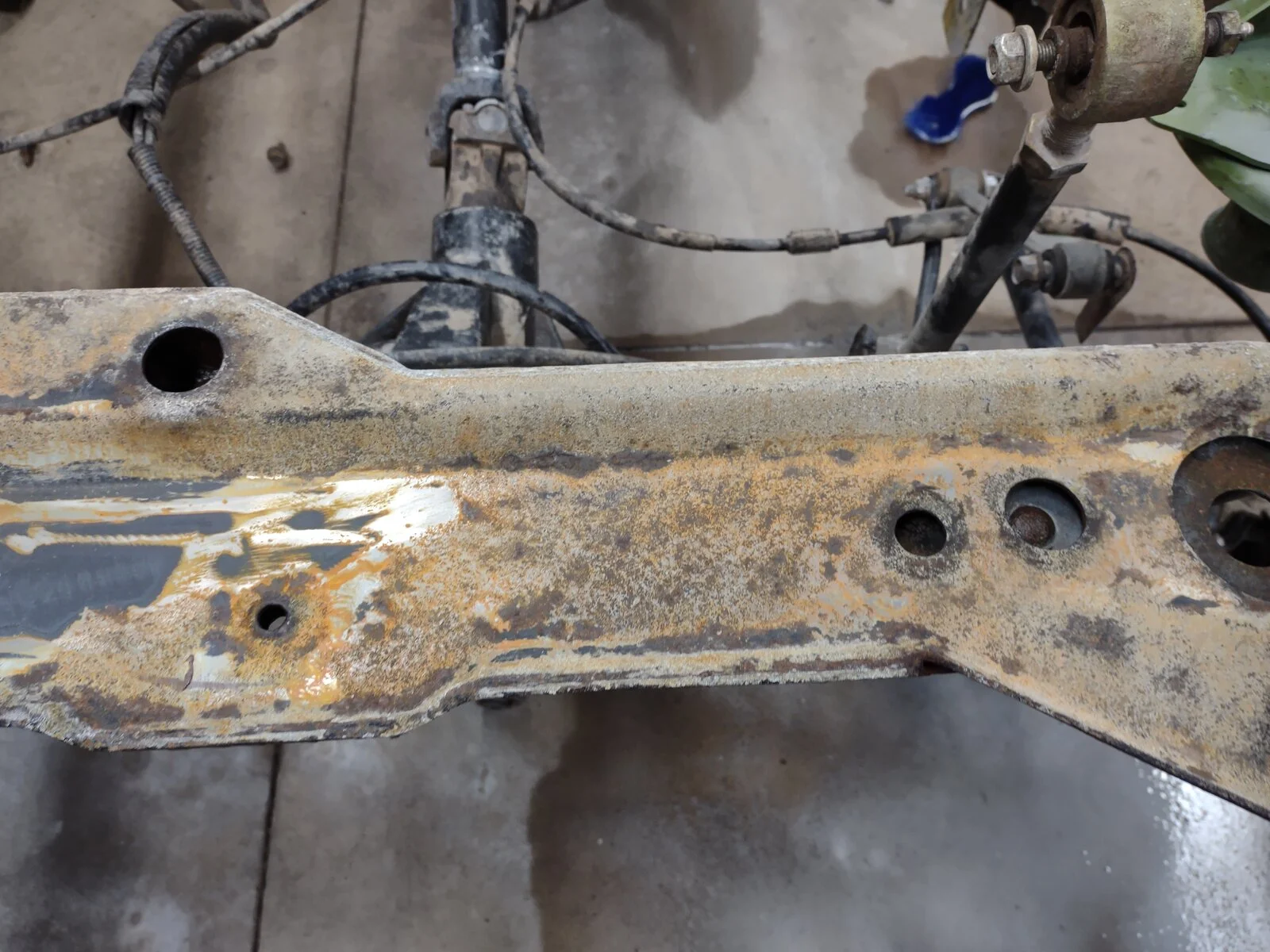

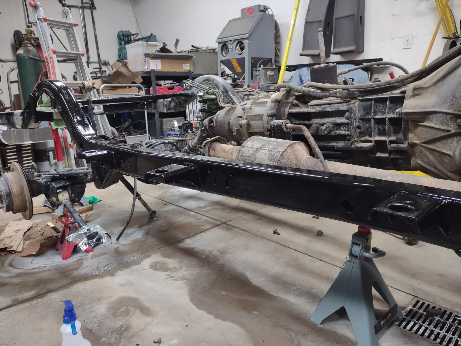

I thought it worked really well. Here are some pictures of my project. The ones that look rusty are the ones I took after the cleaning and acid etch process.
