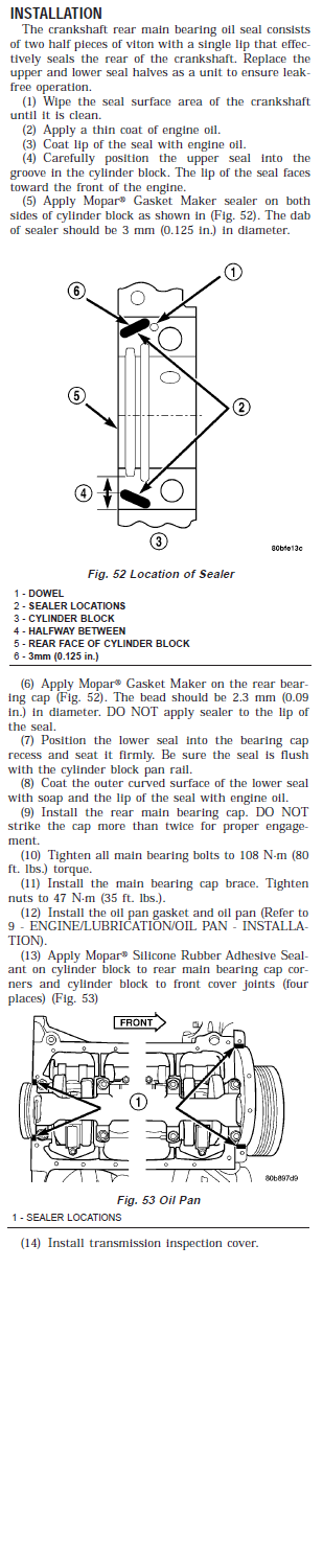

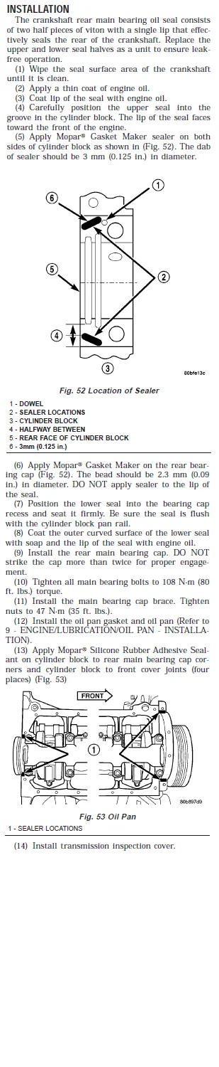

As you already know, cleaning everything and following the FSM instructions is key to success. In terms of the RTV, I use Ultra Black, but only use that sparingly on the front part of the pan where the timing cover gasket and oil pan gasket come together on the corners. The back part of the pan also gets a couple dabs of Ultra Black on the outside corners of the pan. The RMS itself gets a thin coat of Anaerobic gasket maker, applied on the corners where the two halves come together. The factory calls for Mopar, but I've used Permatex with good success.
The seal gets anaerobic sealer? That stuff hardens and has to be chipped or scraped off. How's that going to work in the upper channel, and it it gets on the flange part of the seal?? I think I need a deep dive redo, and I'm wondering if the FelPro RMS is the culprit, it seemed to be a little too long on the top and had excess exposed on both ends when centered.
Oh, yea well that got the sealant, but that's a lot different than the "seal itself"
Yes, it is. I missed that part. @Irun, you really put the anaerobic sealant on the seal? I wouldn't recommend that. That seal, which is stationary, contacts the crank journal, which is rotating. Anaerobic sealant, like RTV, is not meant to be used in a sliding interface.
Only on the mating surfaces, where the two halves join. Edited the post to make that clear!
