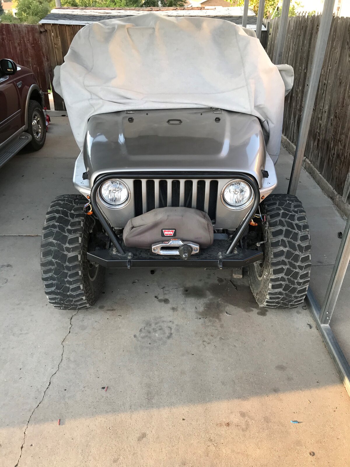

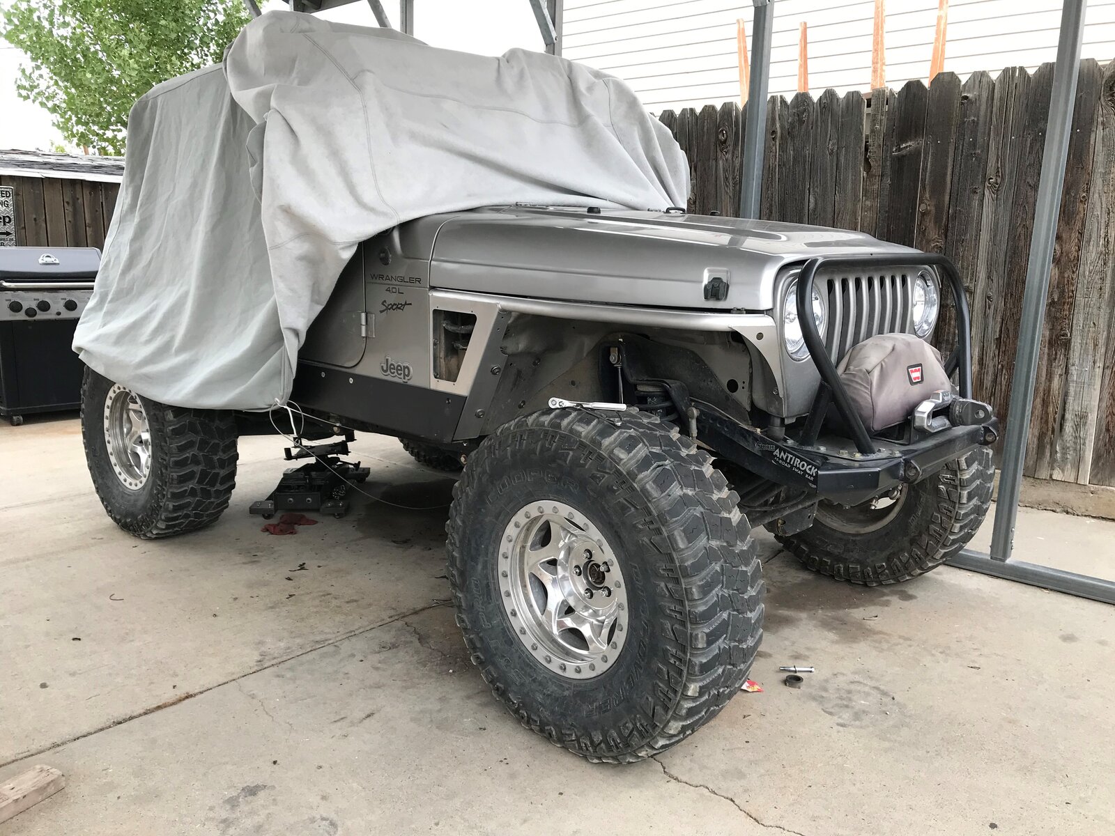

Been wheeling the TJ as it sits for a couple years now with anticipation of eventually going tons and 40’s. The opportunity arose sooner than anticipated.

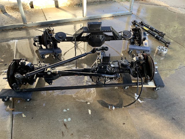

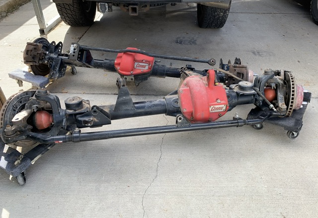

Scooped up a pair of Currie 60’s off a JK. They’re JK width, 5.38’s, Detroit Front, Elocker rear, and semi float. Some might raise an eyebrow on the semi floats, but for this rig weighing 4,000 lbs wet with the old axles I think these new Currie axles will be plenty stout. Plan is to use the Genright Twisted Pitman arm and stretch the front as far forward as possible while retaining the steering box in the stock location. I’m hoping I’ll end up around 105”-106” wheelbase.

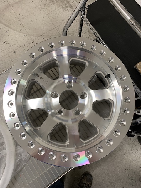

While at TH, I got a new set of Raceline Avengers, and a Yukon Zip from Dustin Sexton at Sexton Off-road, both items at super good deals. I originally planned to get an ARB to replace the Elocker (bad previous experience with them) but the deal was too good to pass up. What I’ve learned, the Zip should do just fine.
I’ve ripped out the old axles and sold the front G2 Core 44 to a friend. Just now needing to sell the rear 8.8 and 37’s KM3’s.
