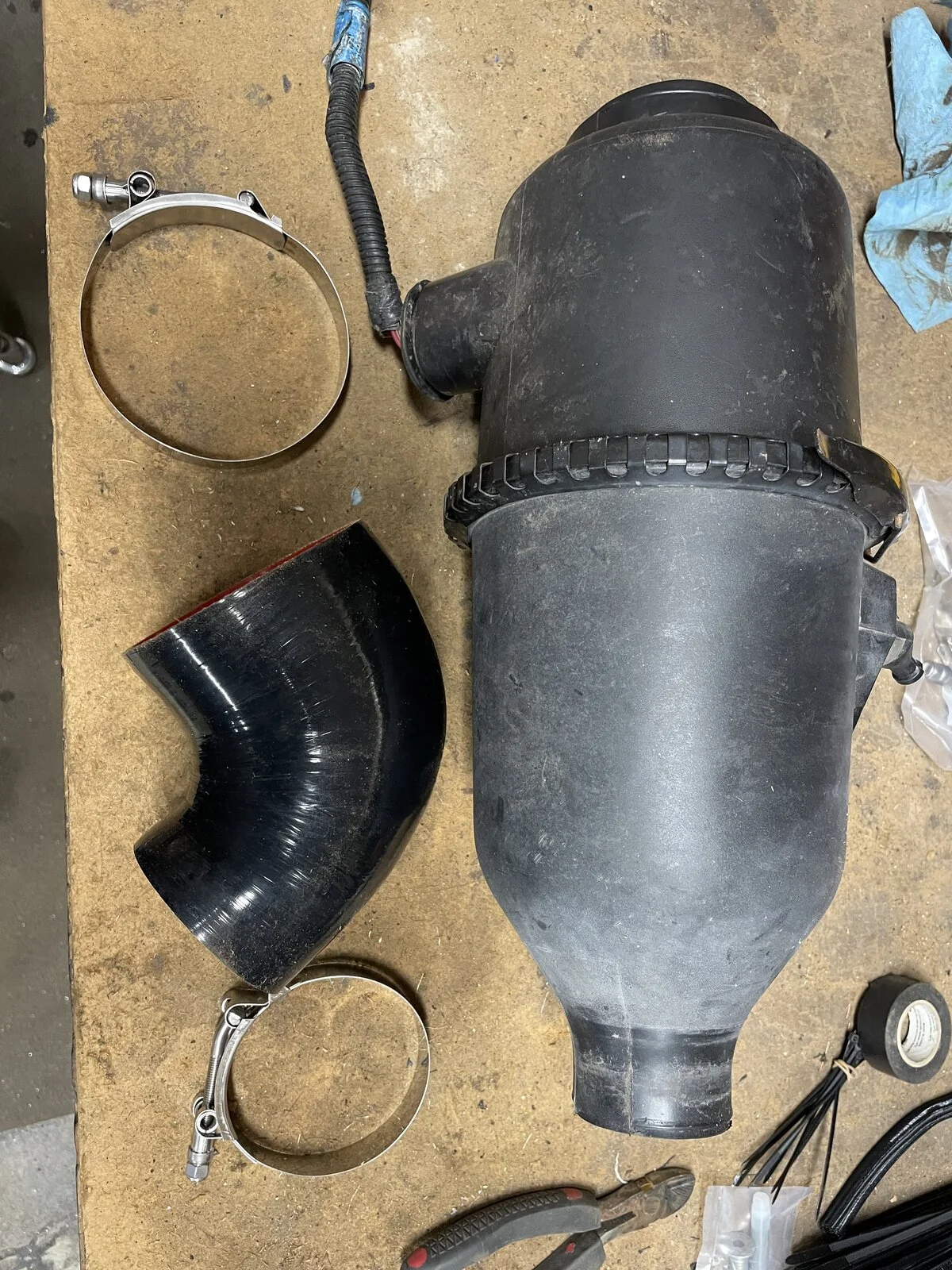

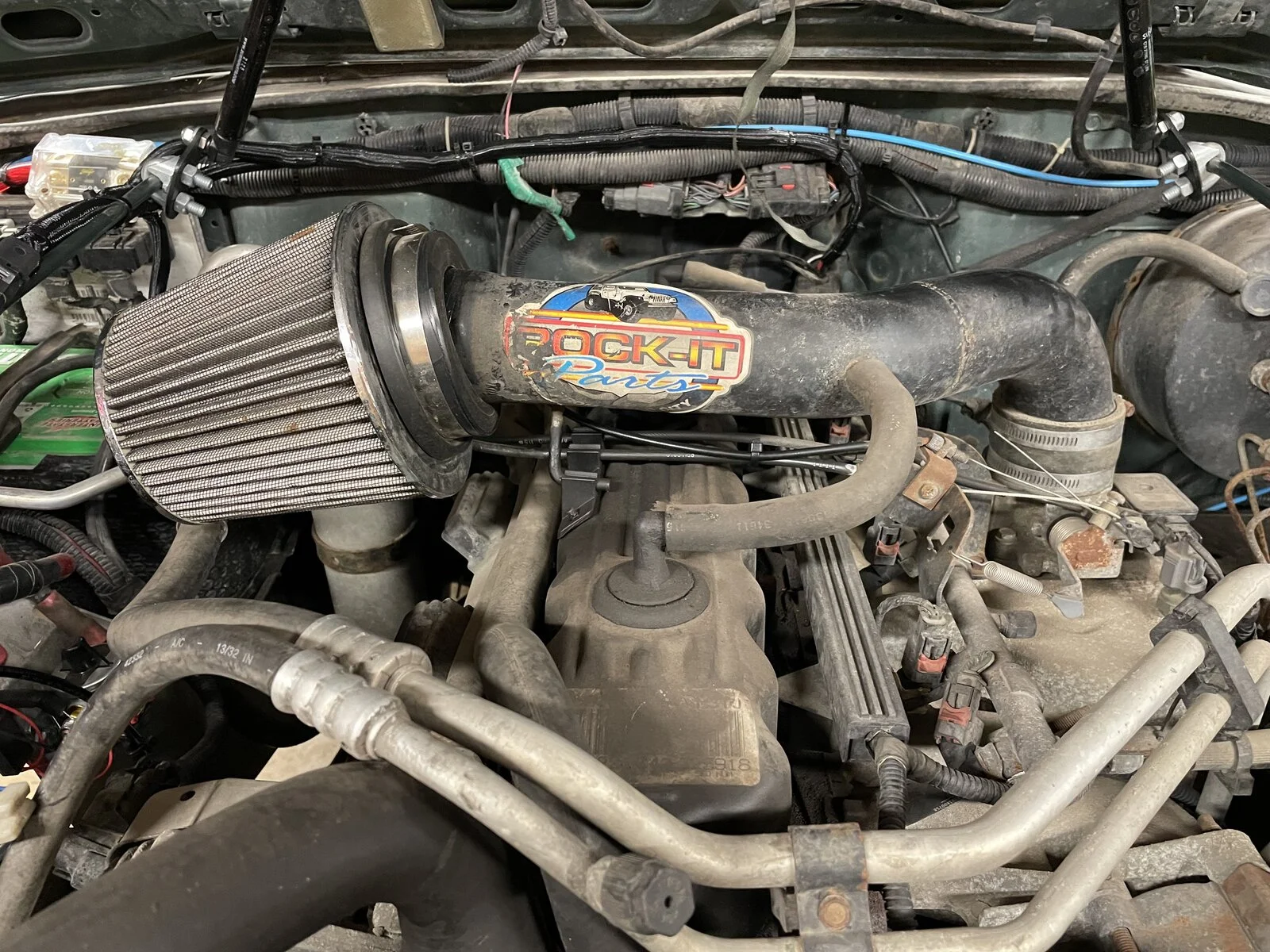

Parts are finally starting to roll in for my windstar intake upgrade. I'm not really doing this upgrade for the "cold air intake". I am doing it because what the PO did with the intake is dumb and has always annoyed me.
I've not known what to do about it until I got on this forum. Started hearing people talking about the Windstar intake. I finally stumbled across @jjvw 's build thread where he had done it on his jeep, and that cleared everything up for me. I started ordering parts:
The attentive eye will notice that I am missing the snoot/gromet that goes on the end of the air cleaner housing. I knew that wasn't a part of what I was buying on the ebay listing and figured I'd figure out another solution. I considered maybe turning it up and having a mushroom style cap coming above the cowl, but scrapped that as That would defeat the purpose of hiding the intake in the cowl in the first place. I ended up calling the seller that I got the housing from and asked them to send me the factory part. That is now on its way to my house.
I may do this project in the next couple of weeks. I haven't really decided yet. I'm not in too big of a hurry.

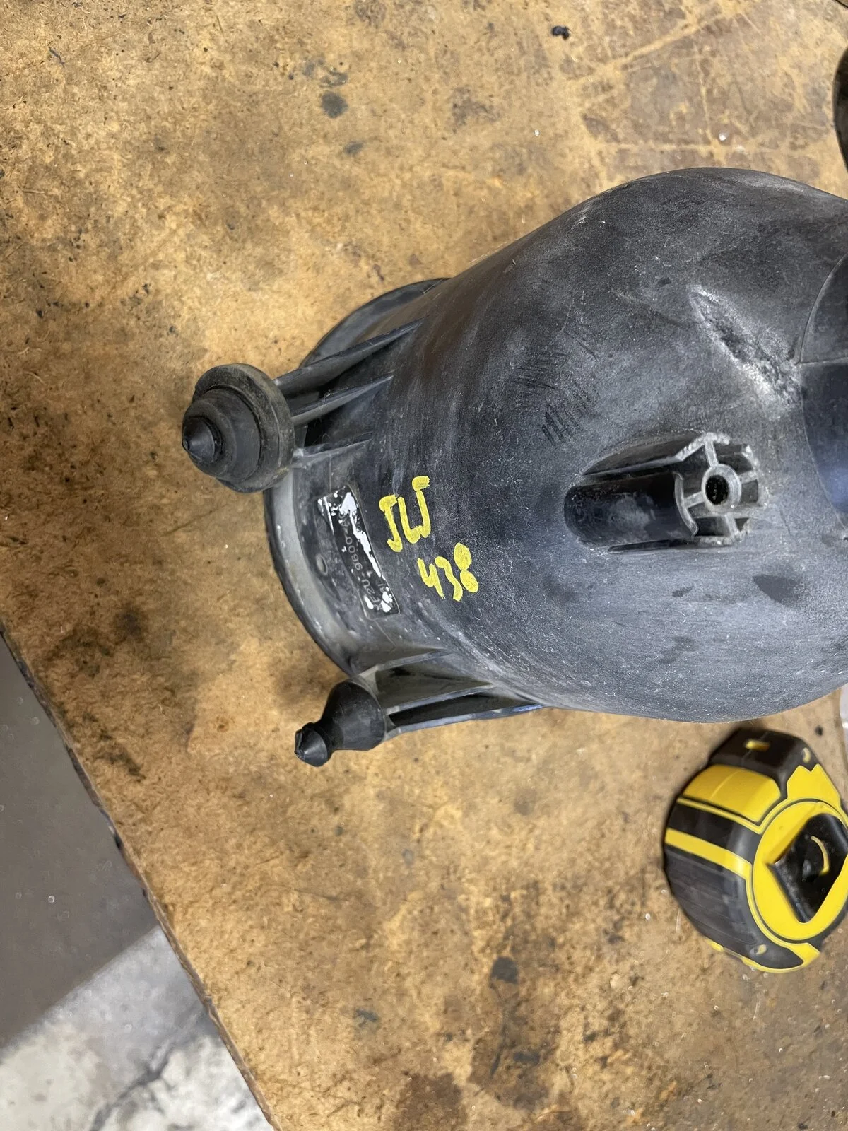

@jjvw or @tworley Did you guys cut these mounting brackets off of the air cleaner? I don't see any use for them and was thinking I'd cut them off to keep a clean appearance...

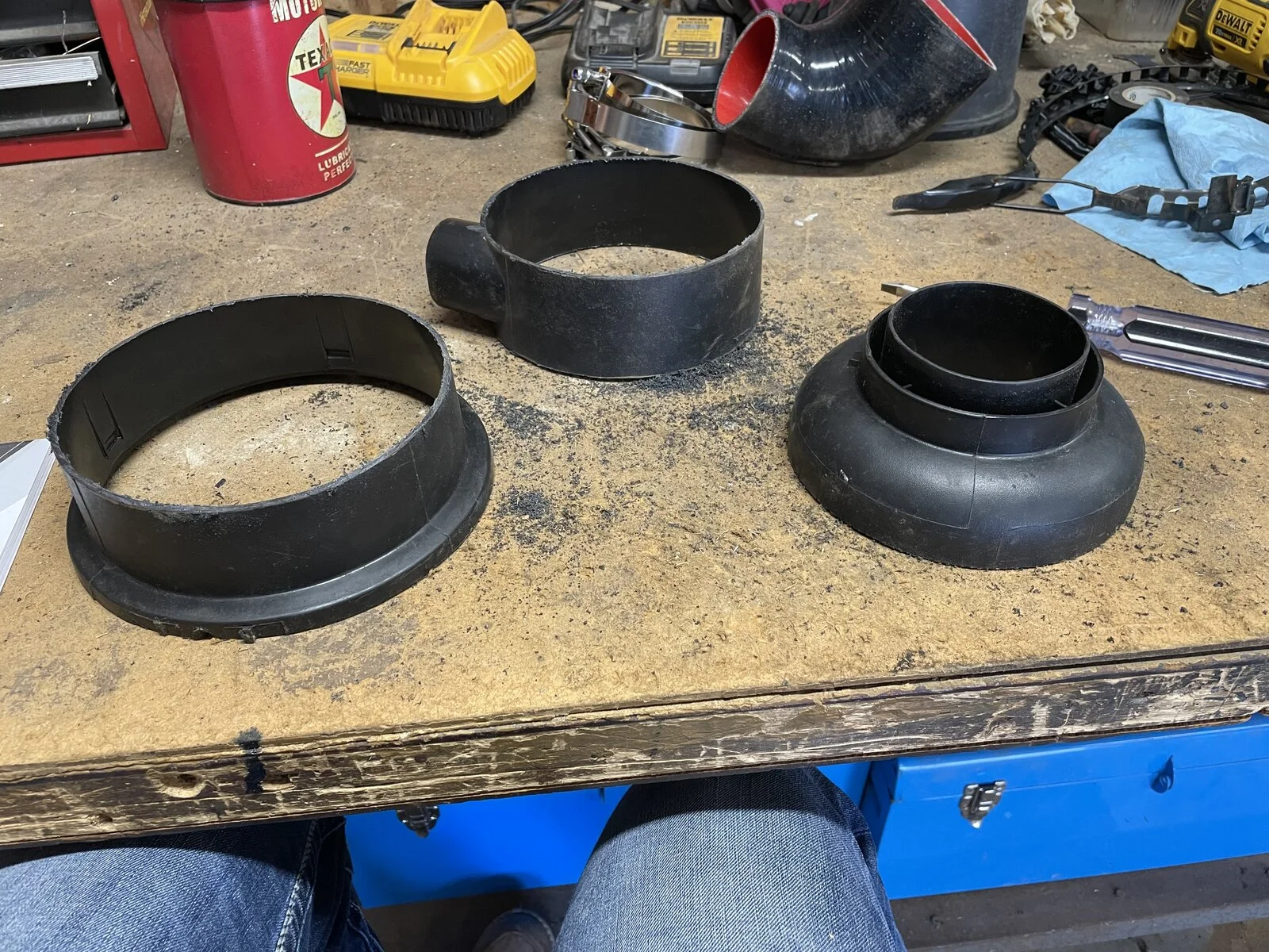

I had a little extra time after work today and decided to cut down my Windstar intake to get it ready for install. I followed a thread that showed the process, but I can't find the original thread anymore. Otherwise I would give credit. It may have been on another forum.

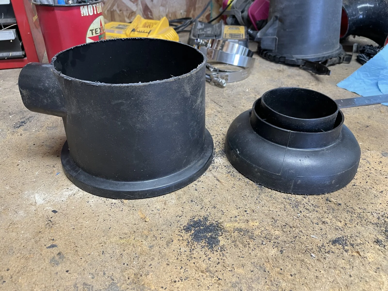

Anyways, I started by removing the mass air flow sensor from the portion that would need to be cut down. It was very easy. Two bolts, and unplug the wiring harness. Then, I marked a line and cut the top portion off:
I then marked a second line, and cut off the main body section that I was trying to eliminate:

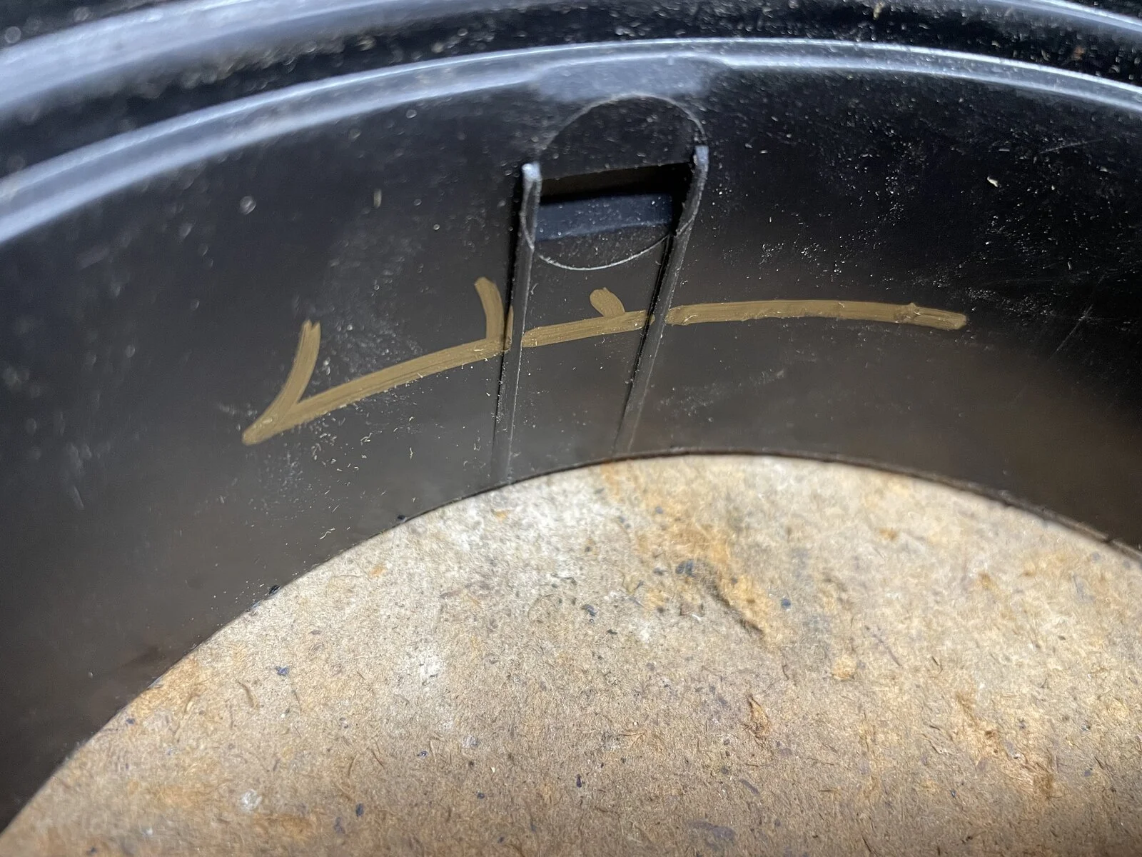

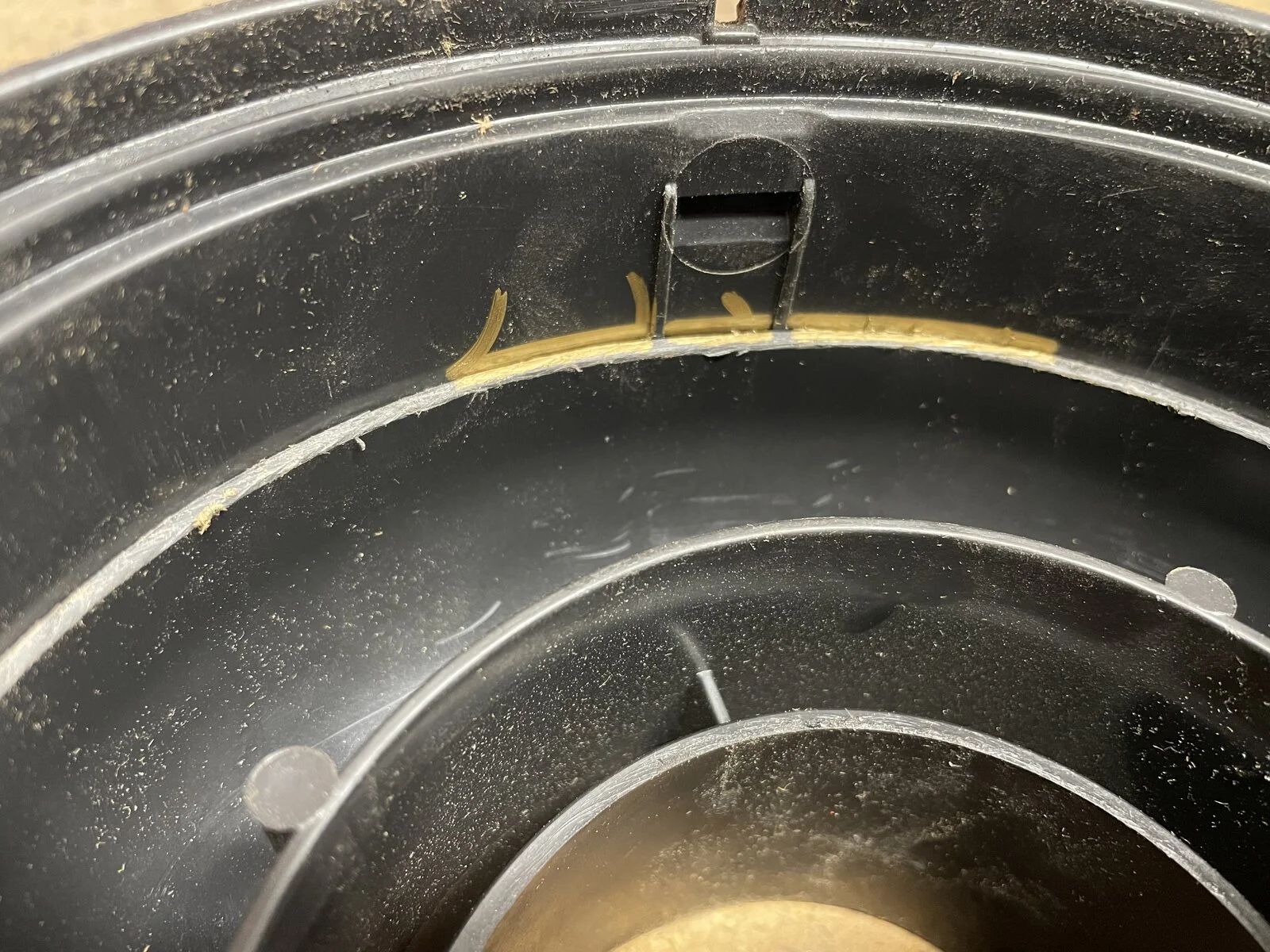

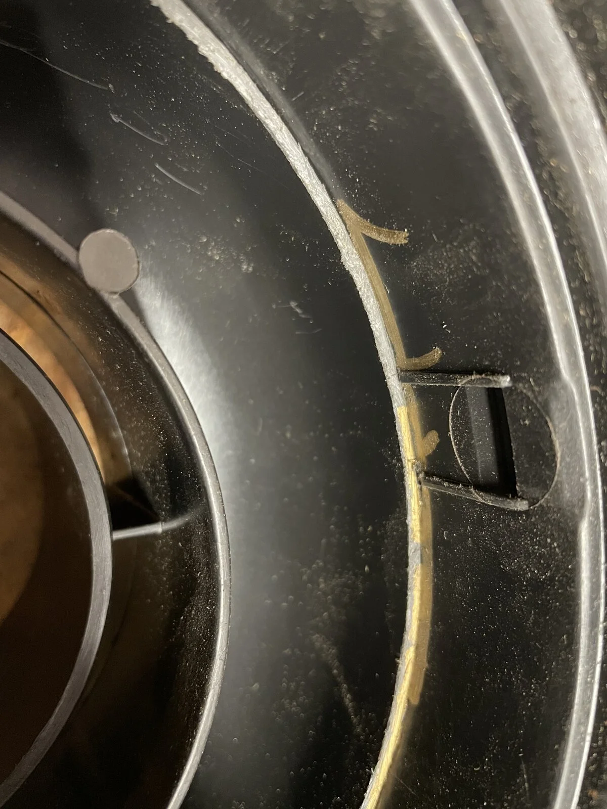

When I slid the two pieces together, I didn't care for the fit around these sections of molded plastic:

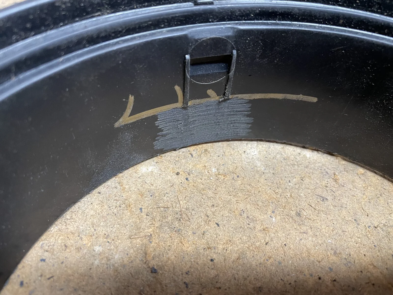

So I marked them, and shaved them down with my dremel:
This worked out pretty well, because the inserted piece kind of clipped into place after that:

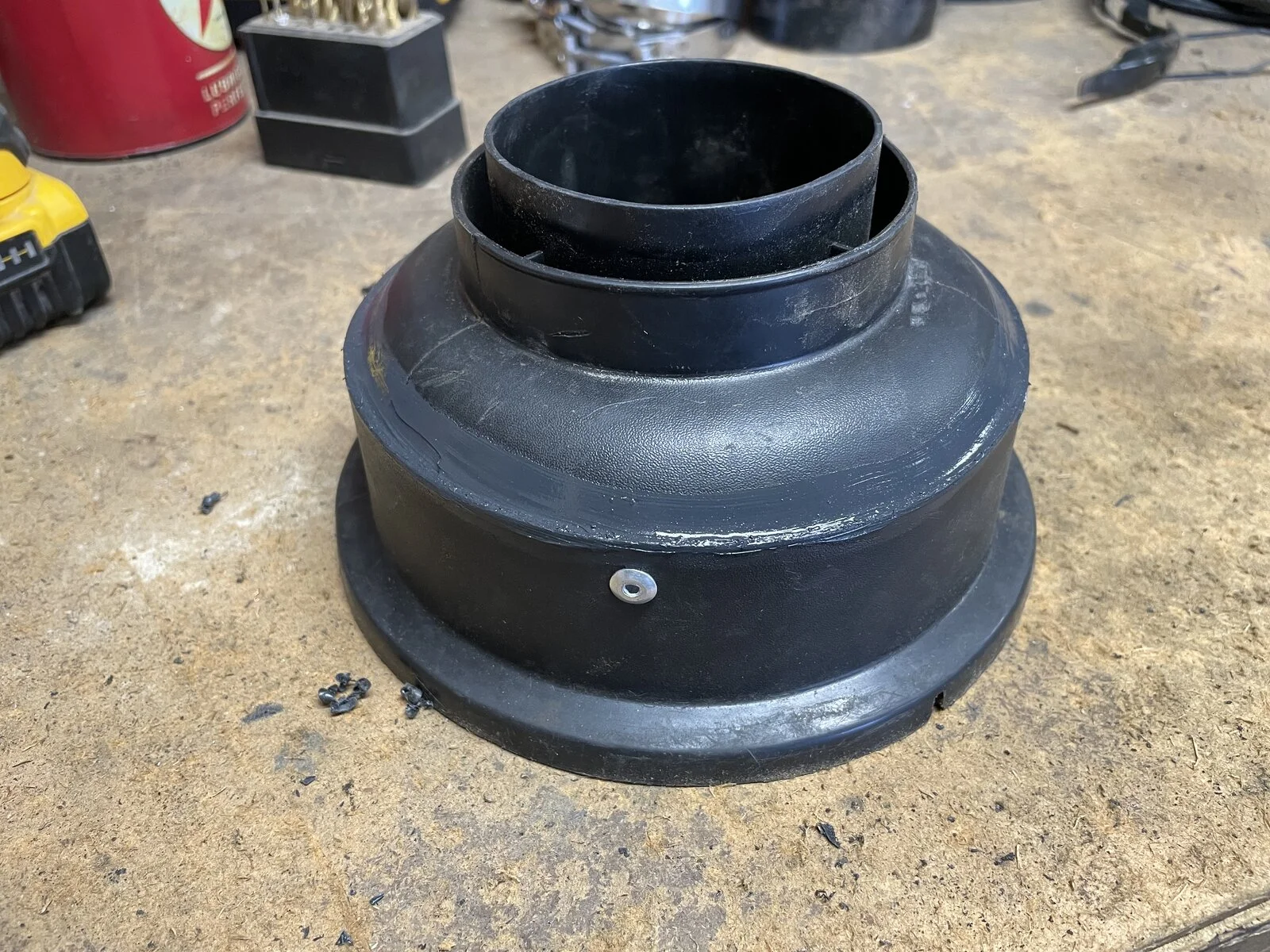

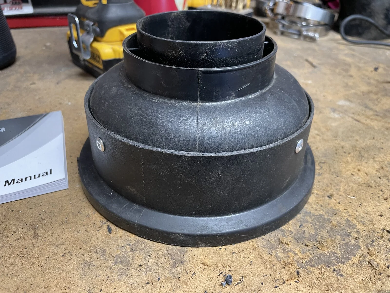

I used four rivets to fasten it together:
And then I sealed up the gap with some RTV. Really, I just wanted it to look a little prettier...
And, that is the point where I ran out of time. I'm still waiting on a part, so I'm unsure when I will get back to this. It was kind of a fun little project.

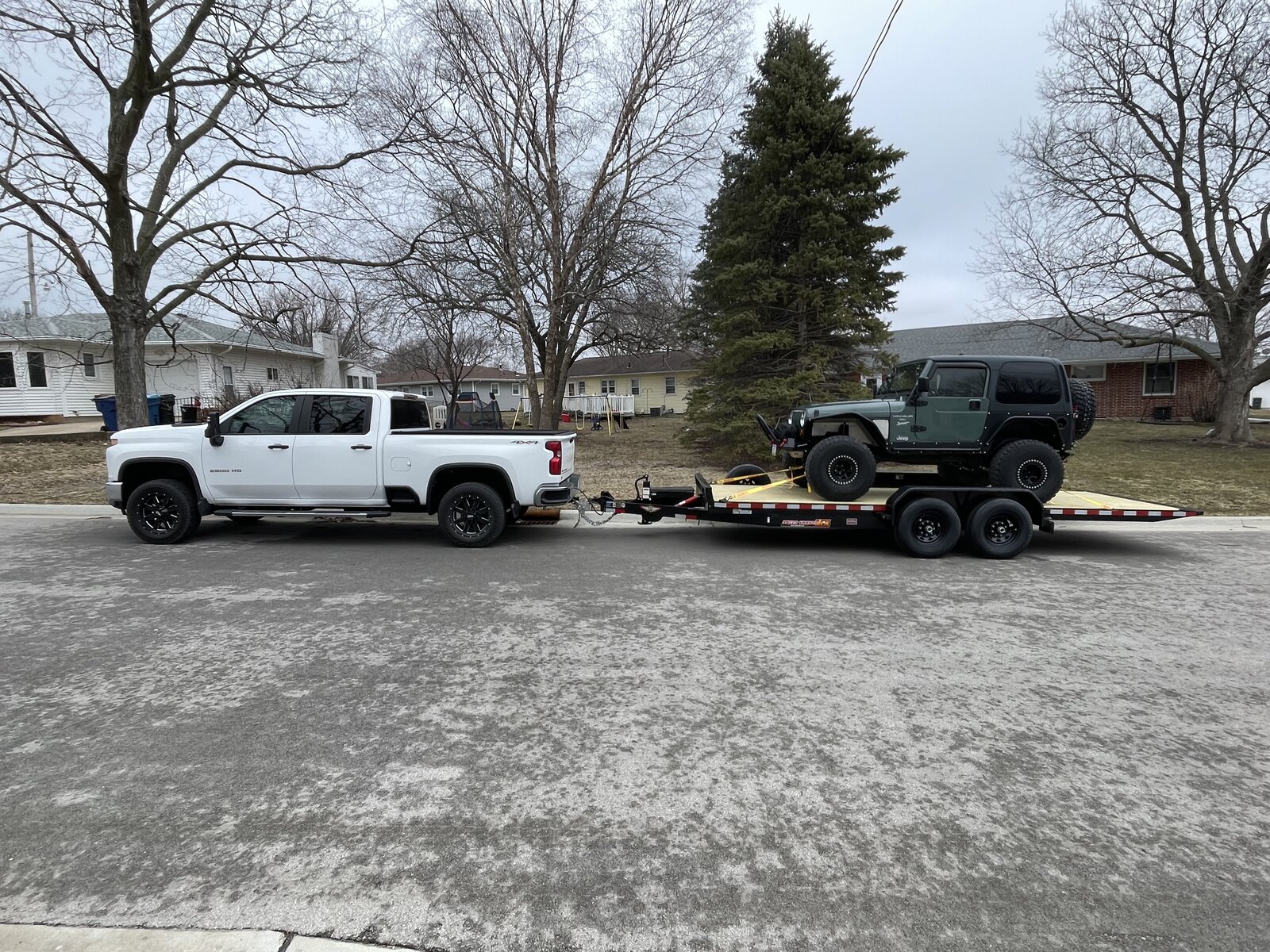

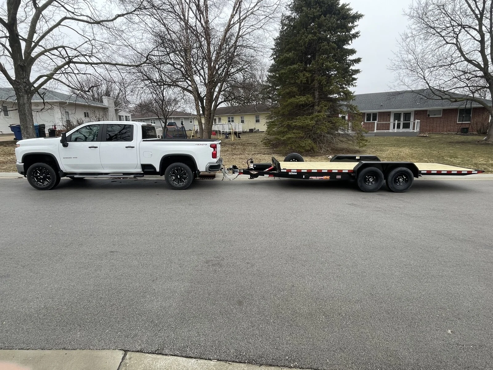

This post is mostly just a data entry for me to keep my built timeline in order, but this is what I posted in my trailer advise thread:

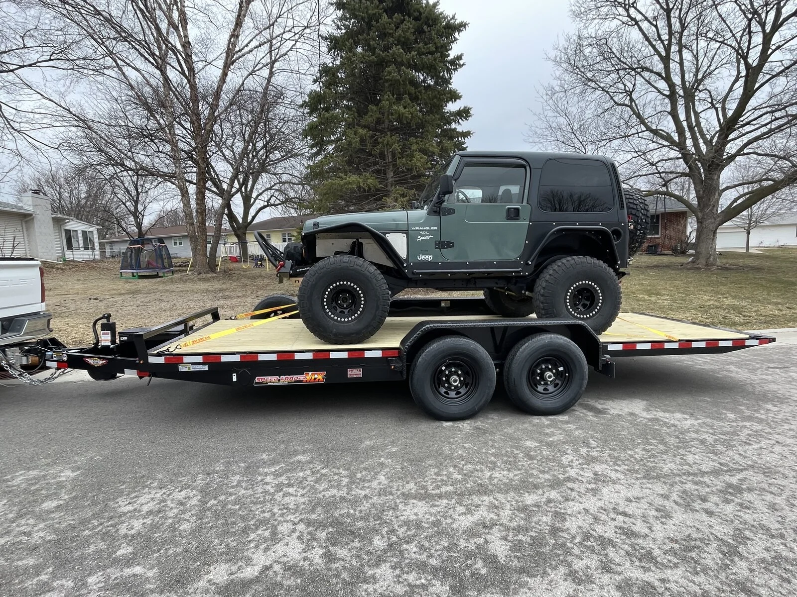

I made the purchase this morning. When I went out there, they didn't have the 10,000# trailer in stock. It was marked wrong in their records. I ended up getting the 20' 14,000# manual tilt. It cost me $700 more to get the larger trailer, but I feel like the benefits that I got made it worth it. This trailer automatically comes with 16" wheels and 10ply tires, plus of course the added weight capacity. Now I can haul just about anything on it. It took virtually no time at all to load and strap down. I am quite pleased with the purchase so far.
My only gripe, is the room between the fenders isn't great. If I wanted to go with a wider wheel base, it wouldn't all for more than 4 1/2" additional width. You guys know better than me, but that might be plenty. IDK. Of course, there are ways around this, and I'm not actually concerned about it.
Cost was $7,093 pre tax.

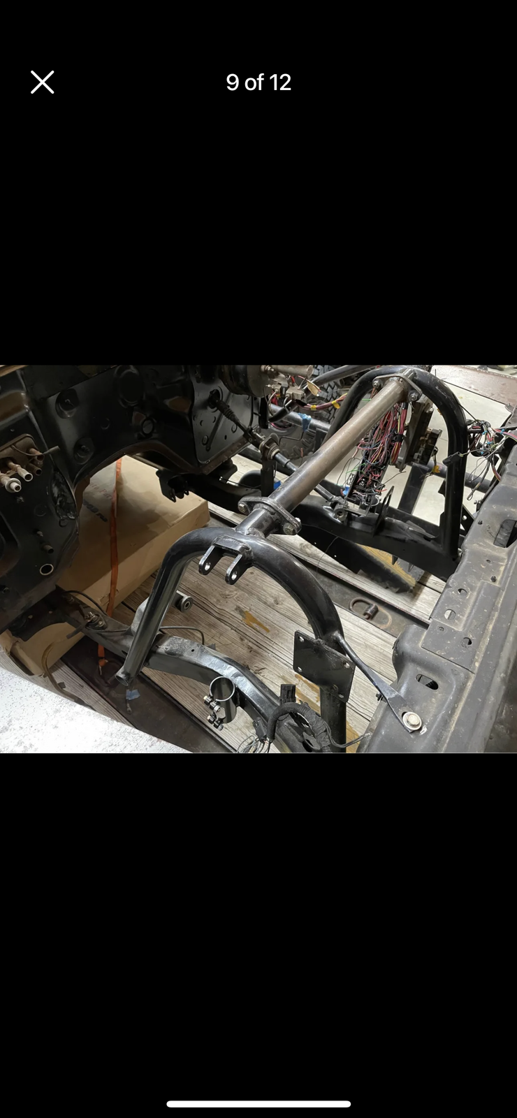

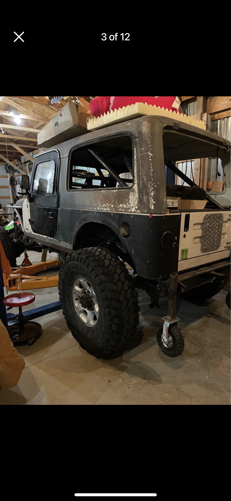

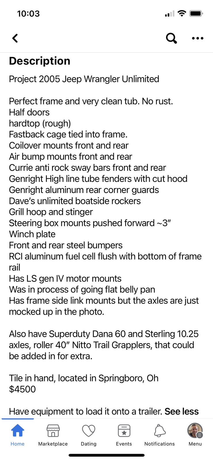

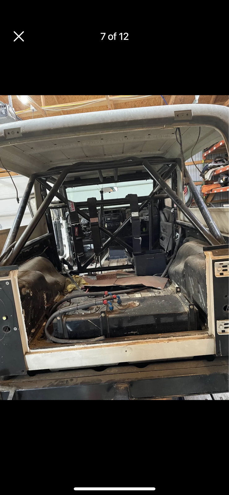

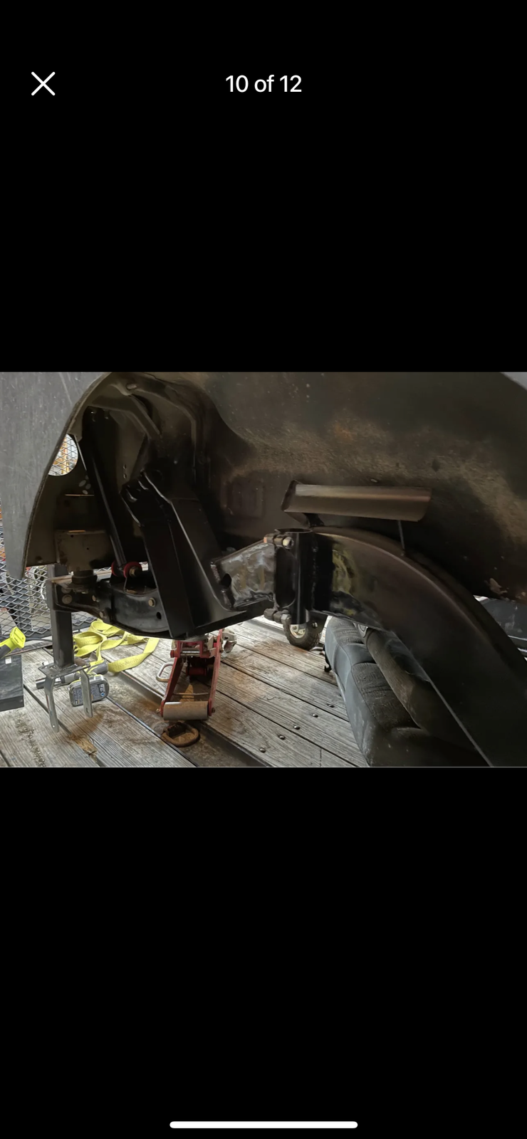

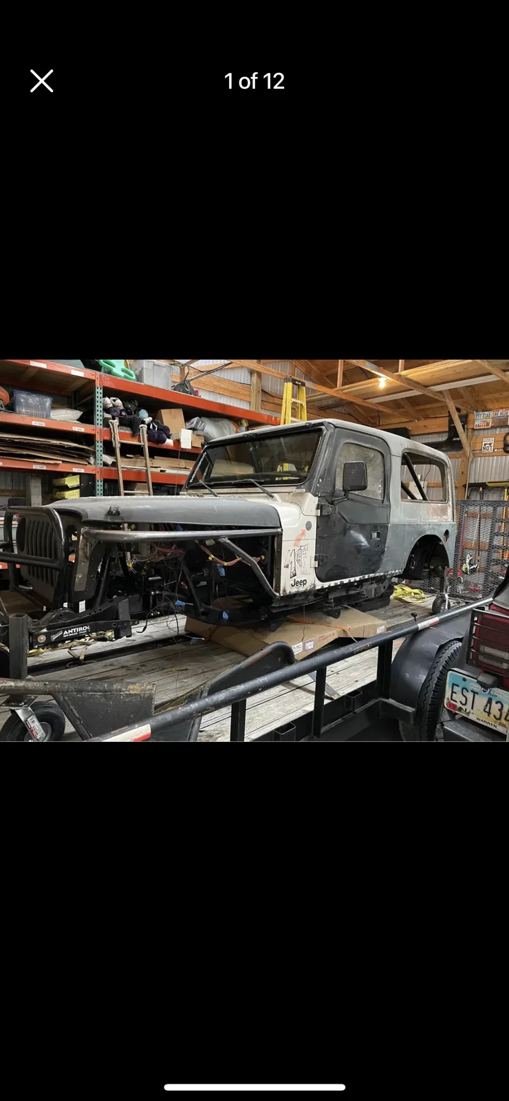

I've seen this posted on marketplace a few times over the last week. I'm curious what you guys' thoughts are on taking on someone else's build on something like this. There are a ton of obvious concerns or things to think about on something like this, but I thought it might be worth snatching up as a future project once I'm 'finished' with my jeep. It is an 8 hour drive from me...
I know nothing more than what is in the post. I have not contacted the seller.
Reactions: JMT and Wildman
