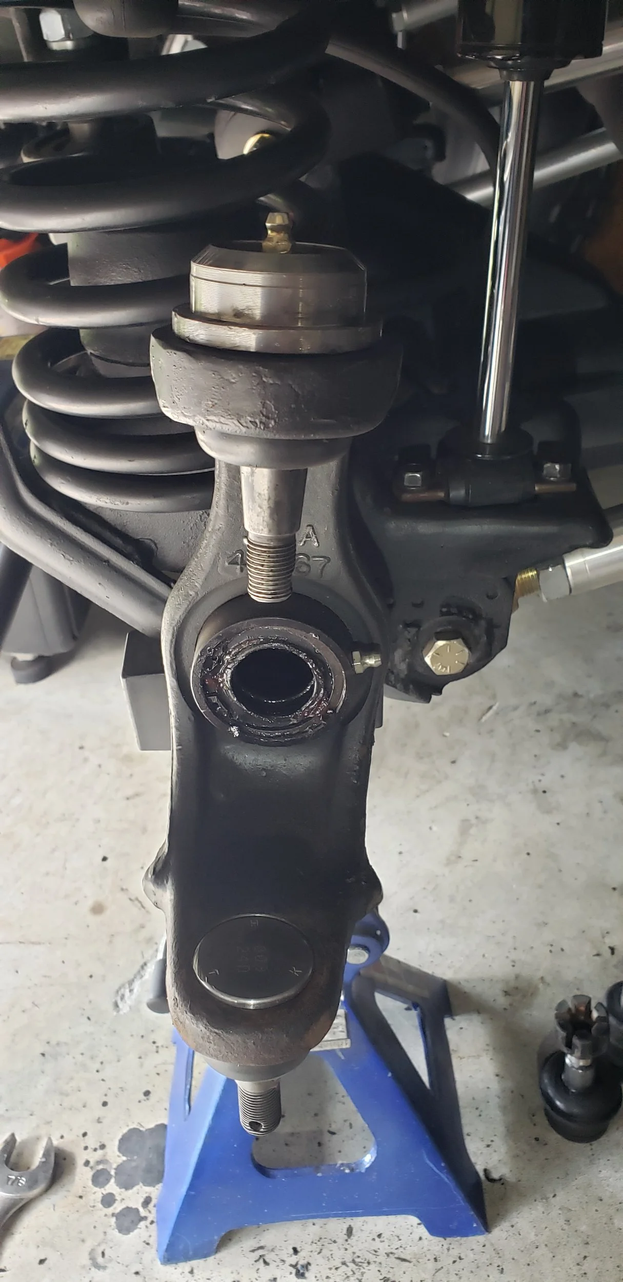

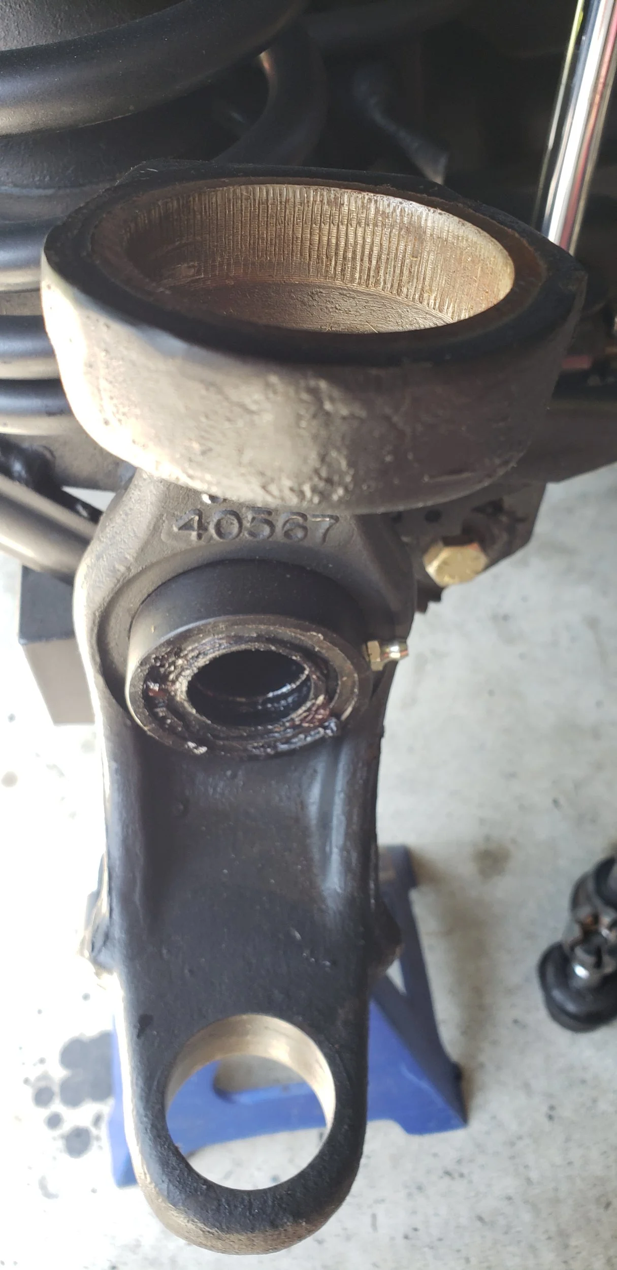

Removed the ball joints that were on driver side of the front 44 I bought, which were new, and wow. I could barely turn the knuckles by hand. Now, I can easily turn that knuckle. Once I get to the passenger side done, I'm confident my return to center, and steering issues, will be gone.
As suspected, the new ball joints in it were splinned. The stock Spicers would drop right in, so I spent 20 minutes dimpling them. After that, they pressed in with some Red locking compound.

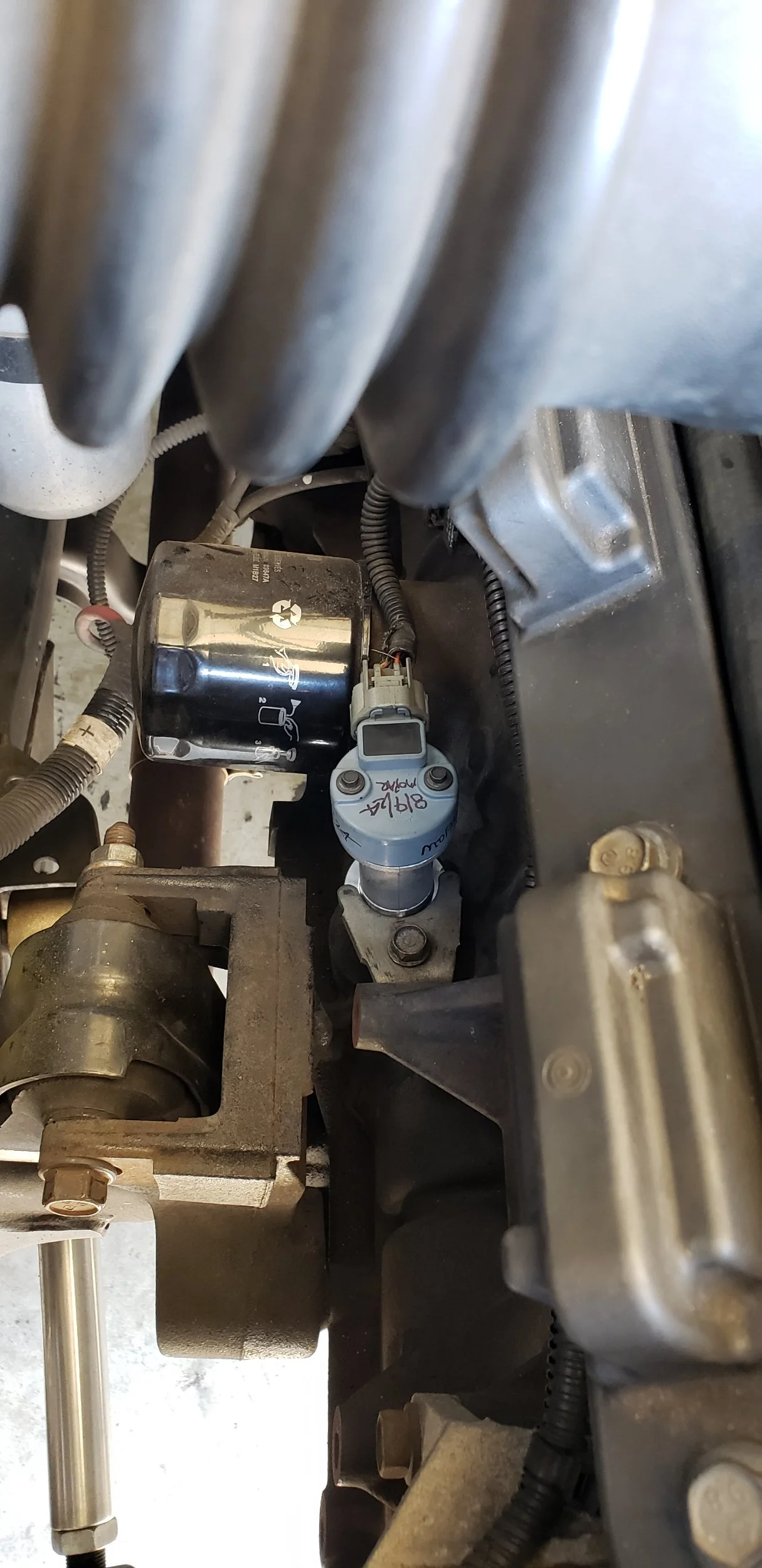

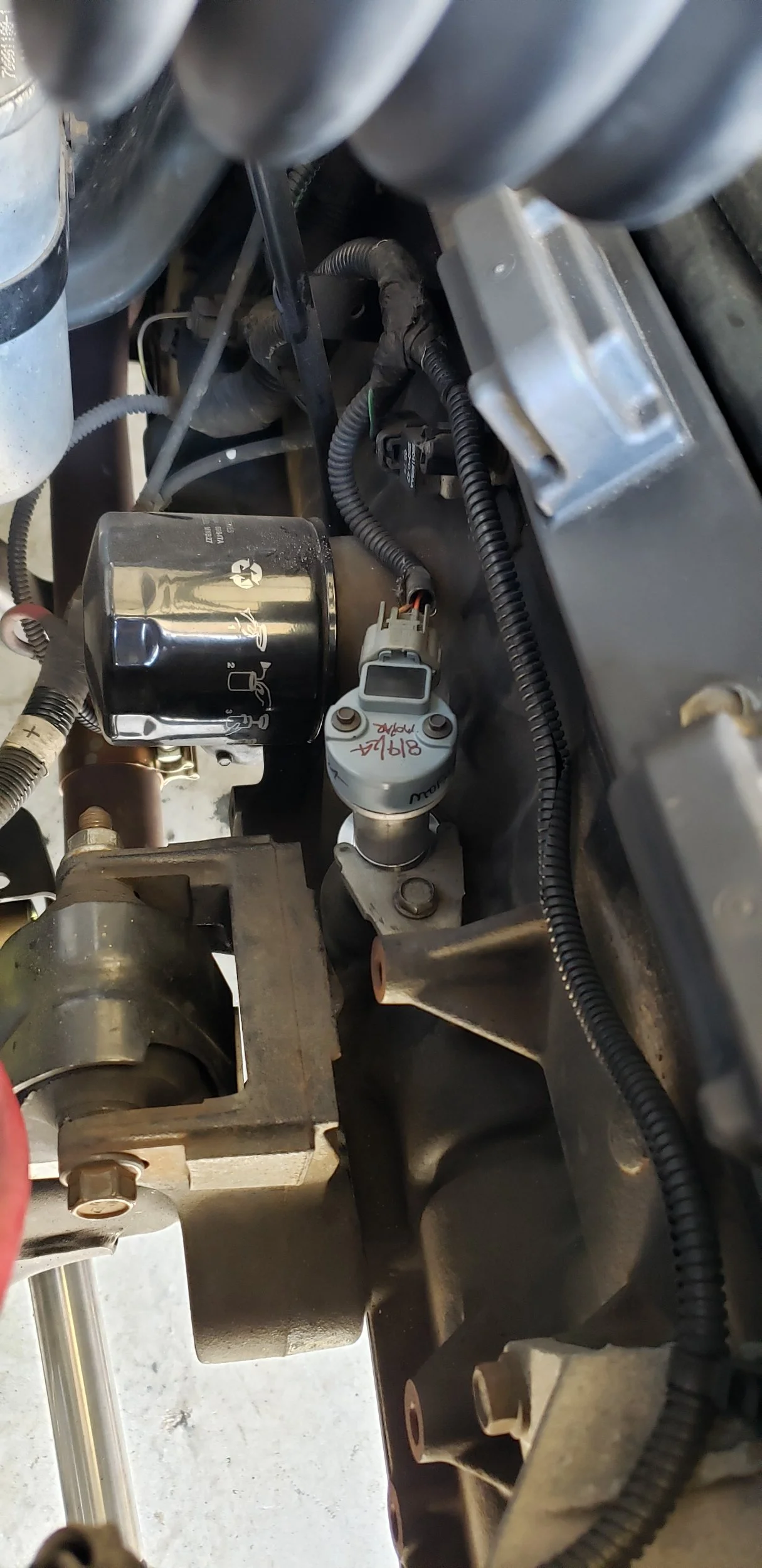

First, I've discovered the code issue that has plagued me since I bought the Jeep. Second, I obviously suck at trouble shooting. Prior to my ownership someone had removed the synchronizer. When they put it back they set it one tooth off. When I put the new synchronizer in, I set it to where the old one was, not thinking about it. As I was looking at the Jeep the 6th time and running down the list of things to check, bam, there it was.
The first picture shows where the synchronizer has been since I bought it. The second picture is where it's supposed to be. I'm still waiting on a new bi-directional scanner, so I can dial in the signal sync. However, after a little computer relearn the Jeep no longer has the poor throttle response and the noticeable misfire is gone.
Curse you, PO!!!
