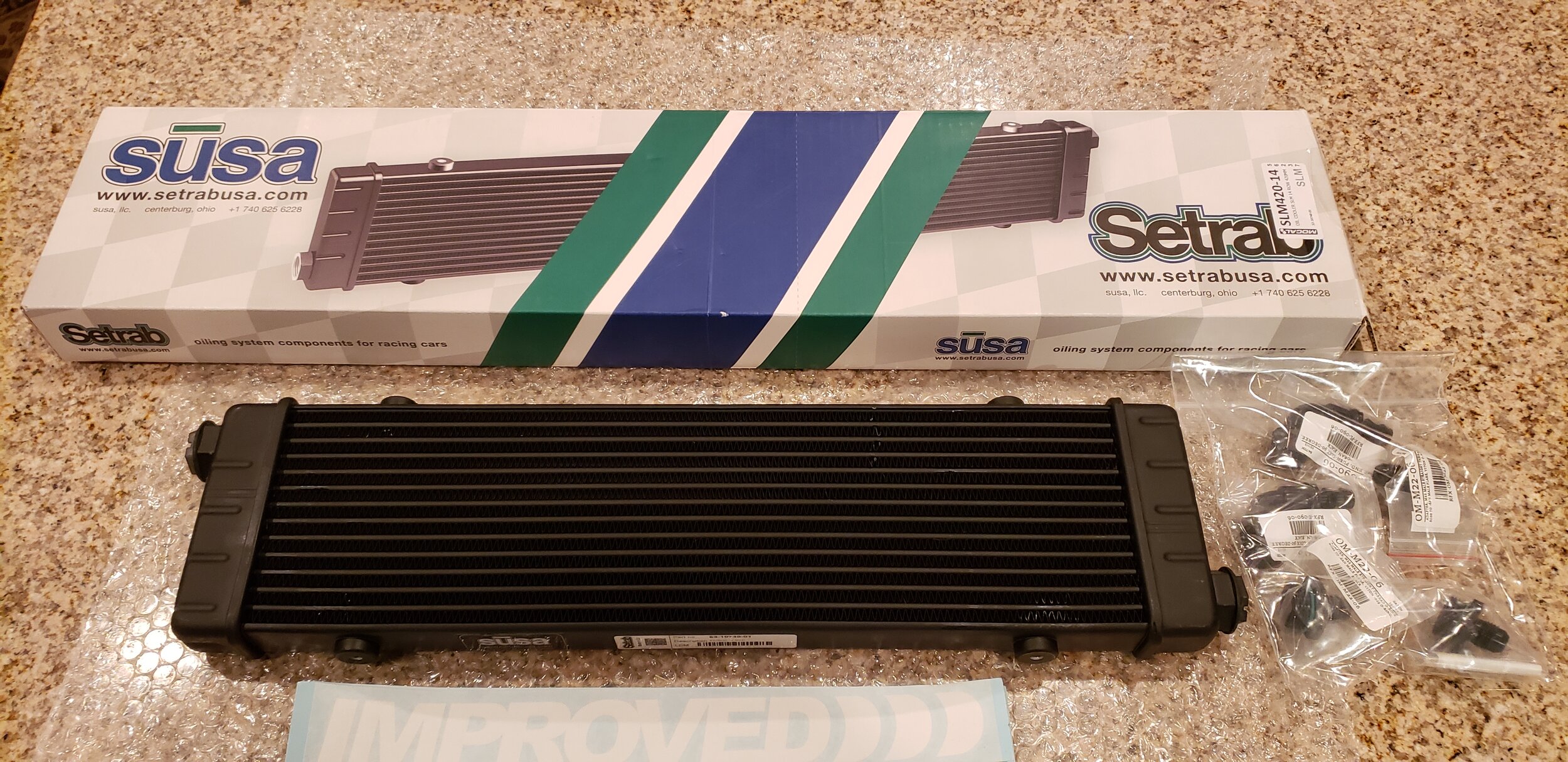

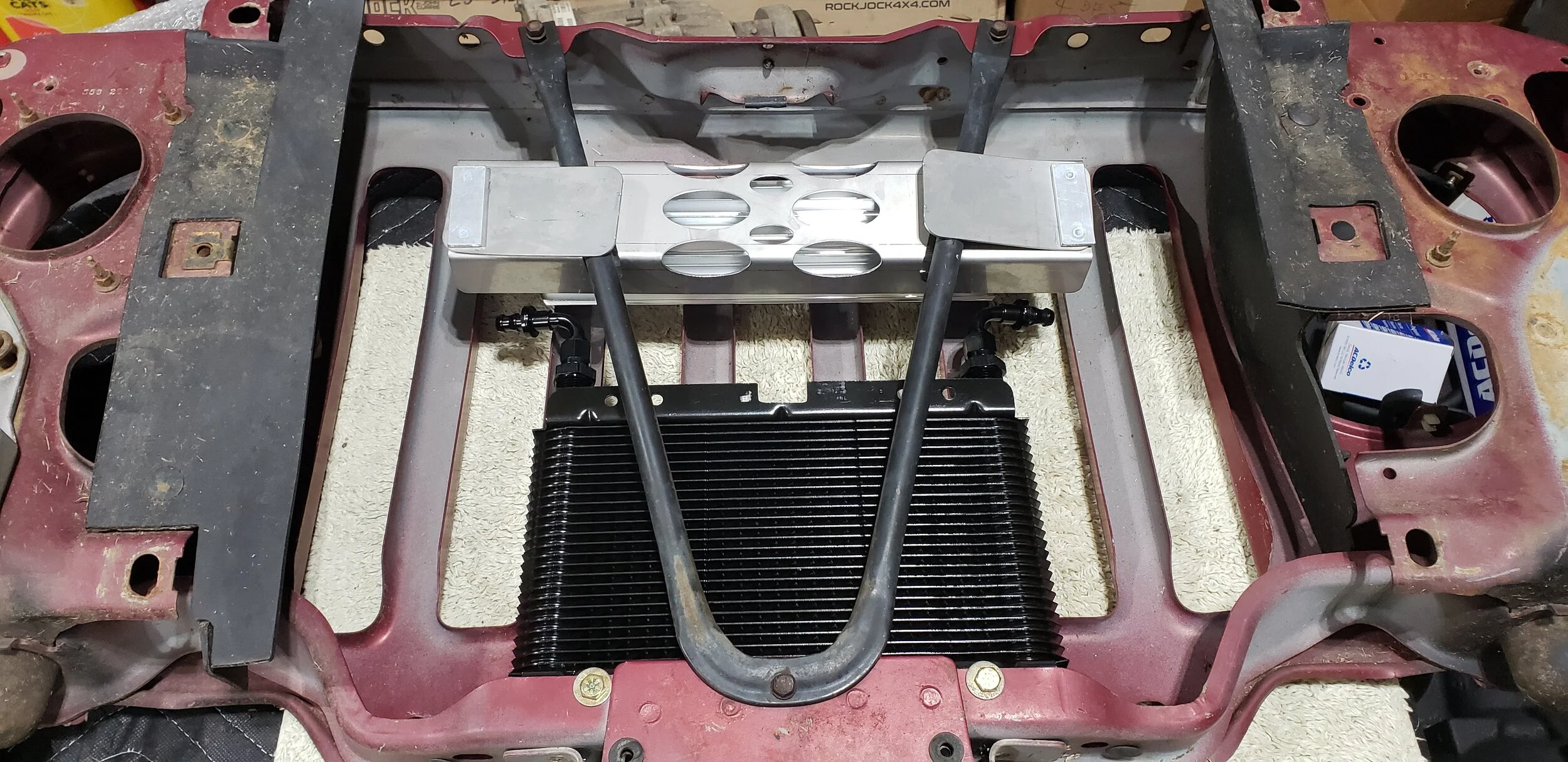

Having a spare grill made it easier, so I spent some time mocking up the steering and transmission coolers. There was absolutely no way I was going to come up with anything visually appealing with the B&M cooler. It also made it crystal clear why Blaine uses the Setrab cooler for the transmission. Improved Racing had the best price I've seen in a while, $319, so I broke down and ordered one. Placed the order 1/29 and it showed up at my door on 2/1.
https://www.improvedracing.com/setrab-14-row-slm-420mm-oil-cooler.html

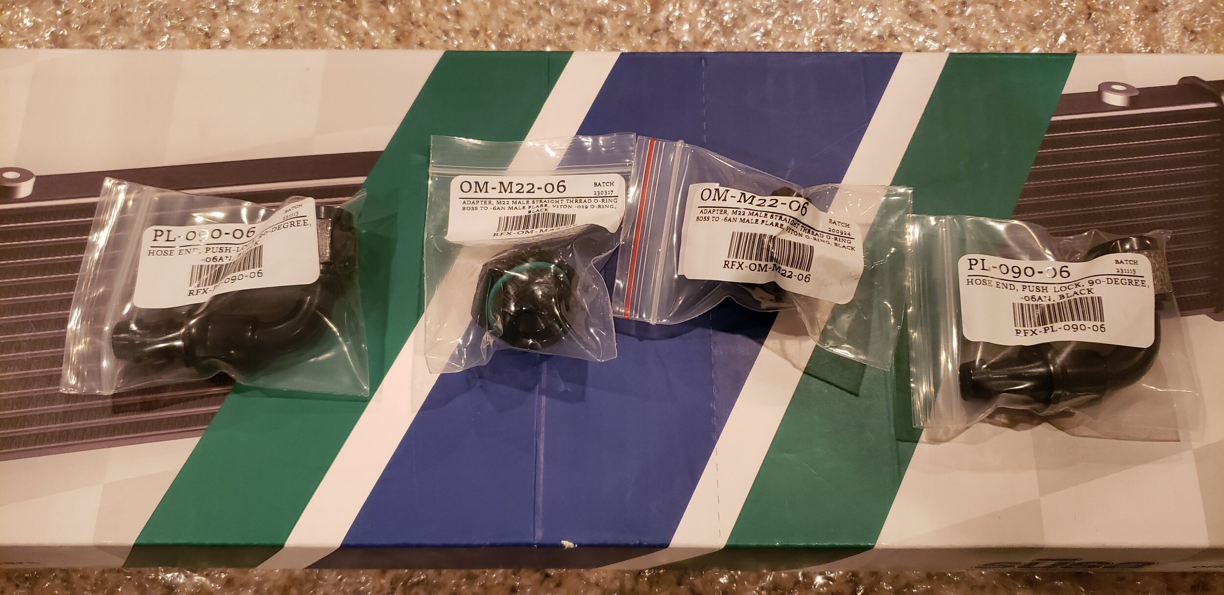

I've ordered from Improved before, so I added the M22 to 6AN adapters and 90° pushlock fittings.
The two tabs on the cooler go on the other side under the bars, not behind. I may have fallen off the design truck at night, but it wasn't last night.
In my defense, I'm an idiot and not afraid to admit it!

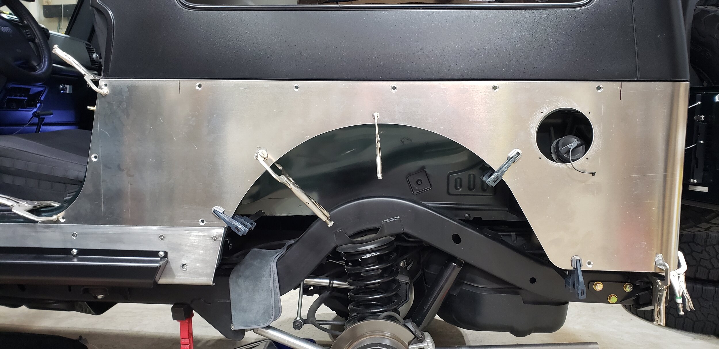

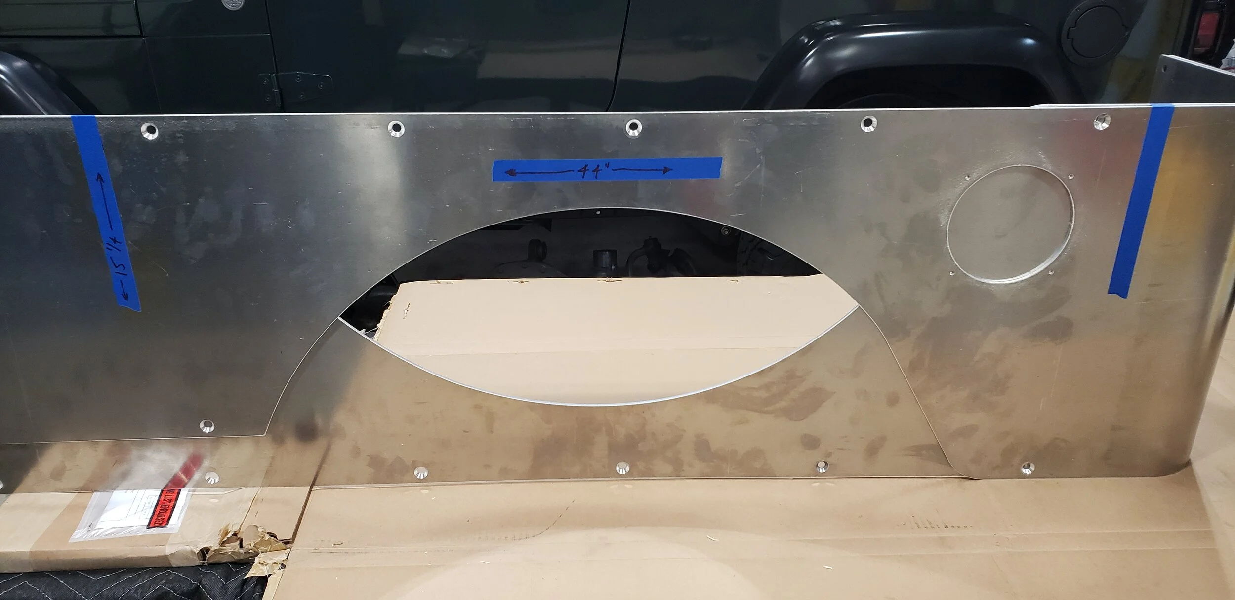

Since Savvy corners weren't available, Genright will have to do. I didn't order the interior reinforcement bars because Genright's are steel, and angled. Unless there's a reason not to, I'll order 6061 aluminum flat bar. The measurements I'm going with are .375" x 1.75" x 44".
This means the area between the vertical blue tape is where the reinforcement bar will sit. I'm also going to have to order Phillips head stainless steel bolts and serrated flange nuts. Genright ships Allen head bolts and lock nuts.
On the plus side, the Genright corners look like they will be a near perfect fit, at 15.25" up front, with the Savvy sliders.
Did the driver side mockup of the Genright corners. All I can say is they took a lot more work to get everything squared up than the two previous Savvy corners I've installed. Also, the gas filler holes aren't even close and the tail light holes are about 1/2 a hole off. On the plus side, the match to the Savvy rockers wasn't off by much at all.
hmm. Maybe I should get blanks?
