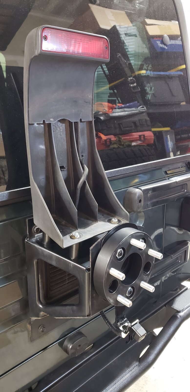

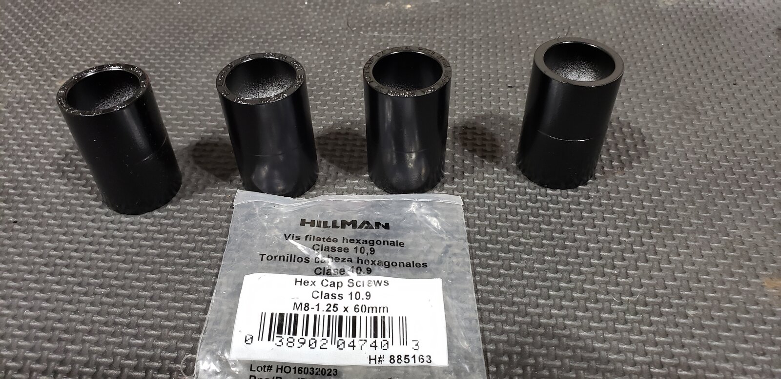

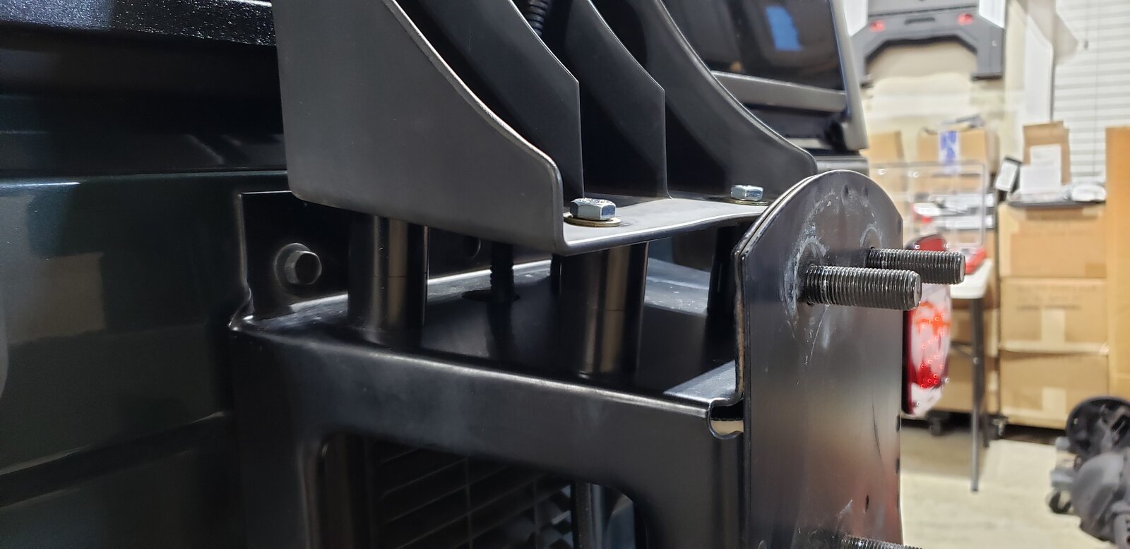

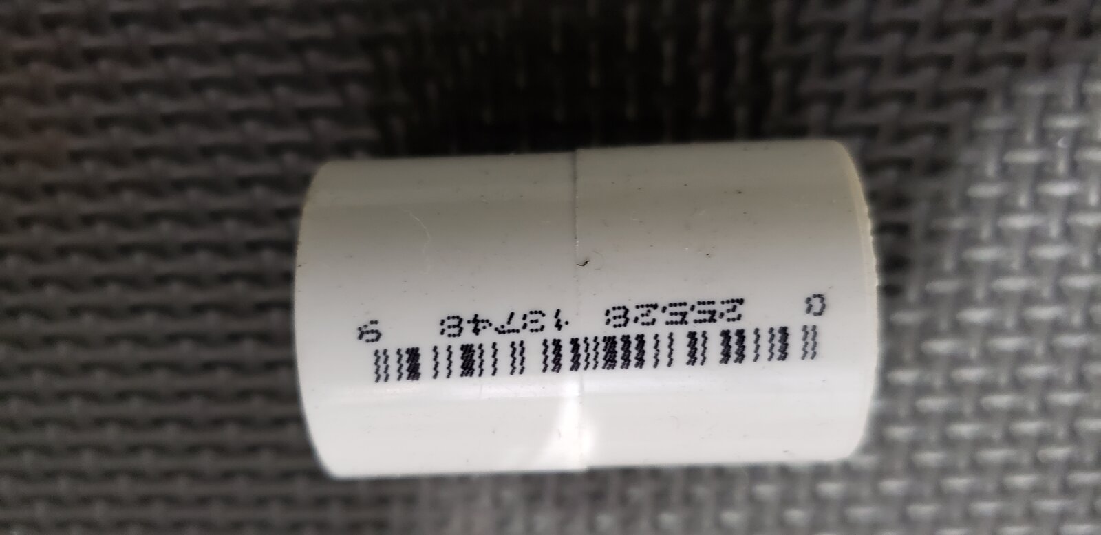

Had to raise the 3rd brake light to accommodate the larger spare tire. Used 3/4' PVC pipe couplers and M8-1.25 x 60mm bolts. Scuffed the PVC connectors and painted them black. It worked perfectly, looks good, and was an inexpensive modification.

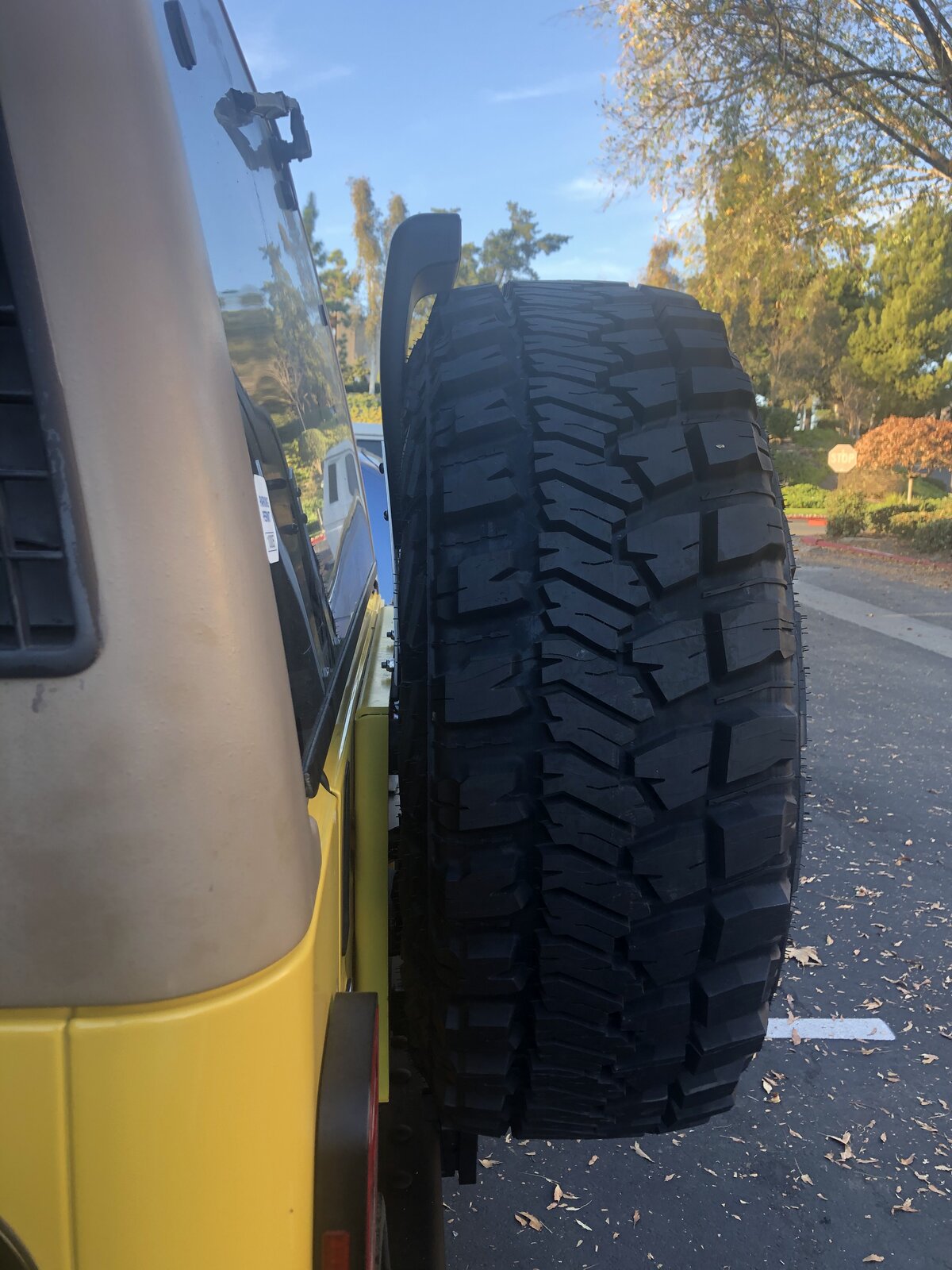

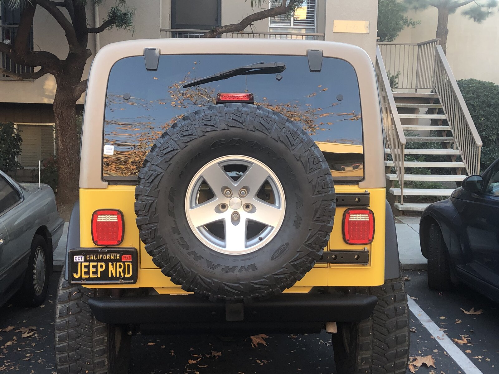

Are you able to grab a rear view mirror pic or express how it may affect your view? With my 35" tyre, MORryde set up, I kinda like the stock-ish look this could bring.

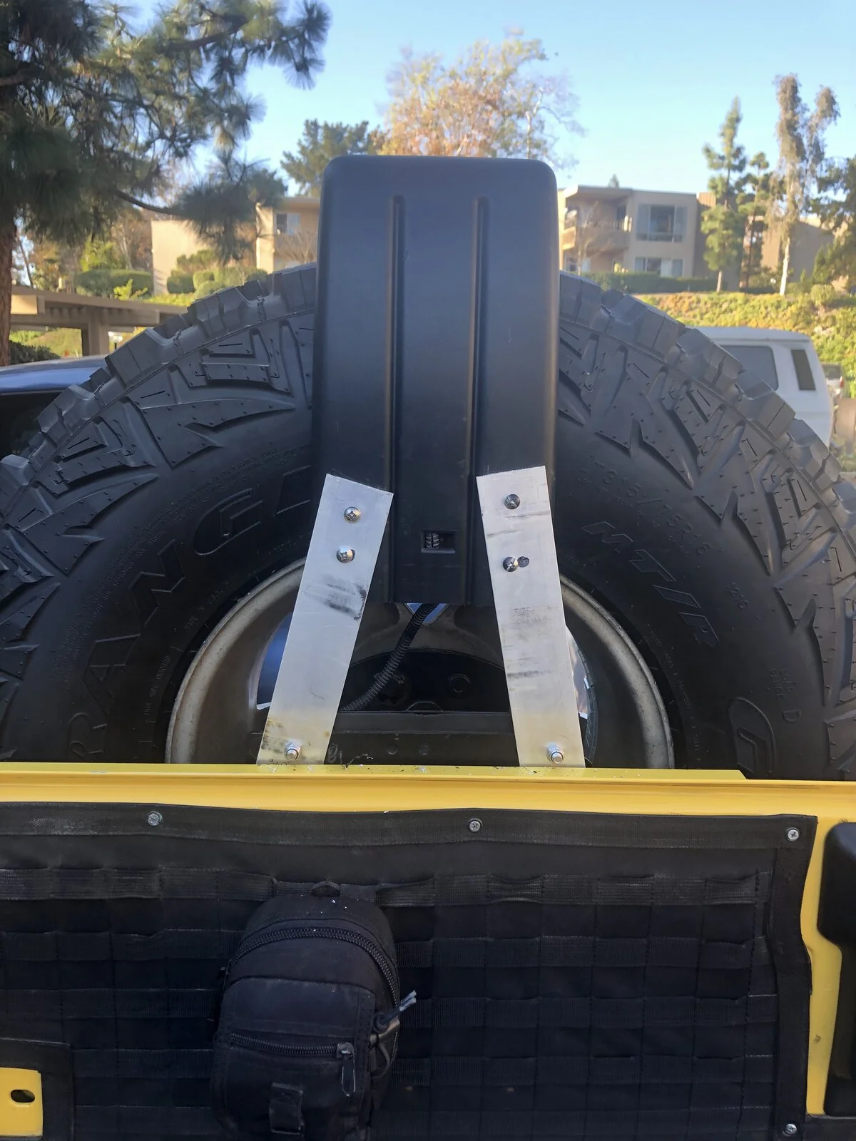

I had done a very similar thing to my stock third brake light but the angle of the spacers and the 35 inch tire caused the bottom of the third brake light to hit the glass on my hard top with bumps and whatnot so I ended up doing this… I have the MORyde as well

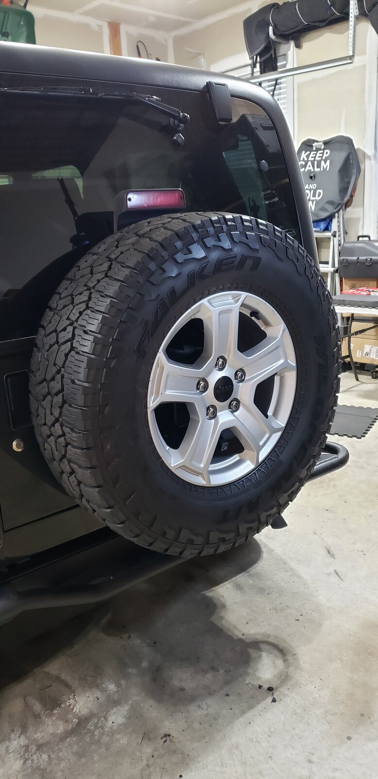

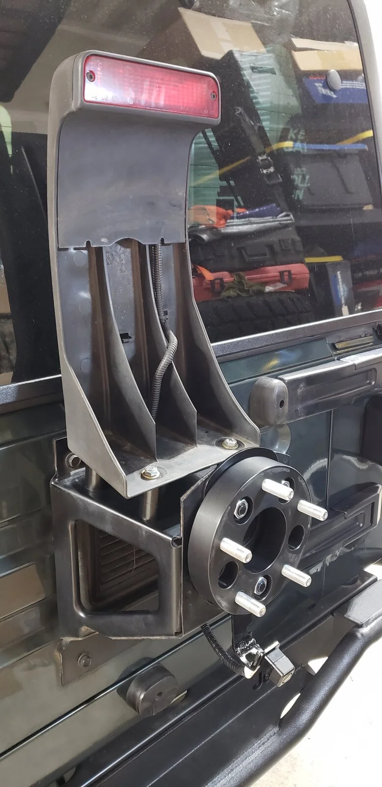

All I wanted to do was install the spare tire and it turned into a 3 hour job. 😕
First, had to raise the 3rd brake light.

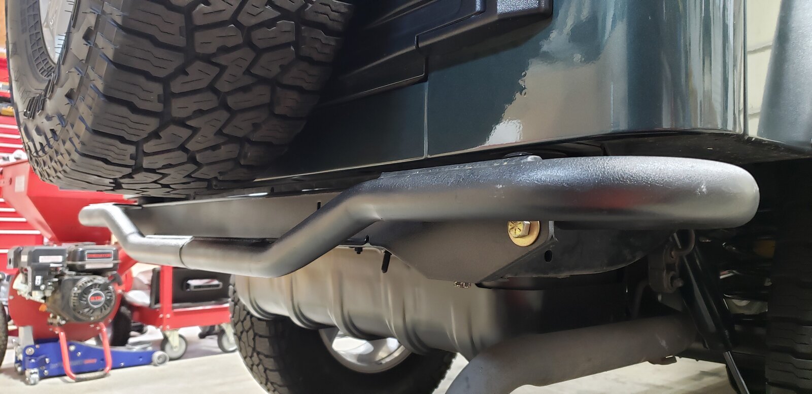

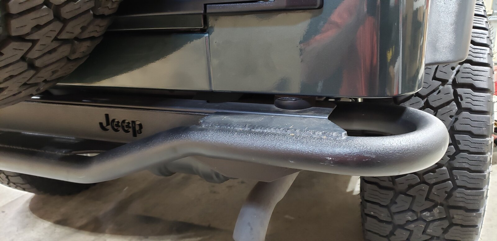

Second, the stock bumper had to come off to get enough clearance room for the larger tire. In went the Mopar Rockcrawler bumper I took off before.

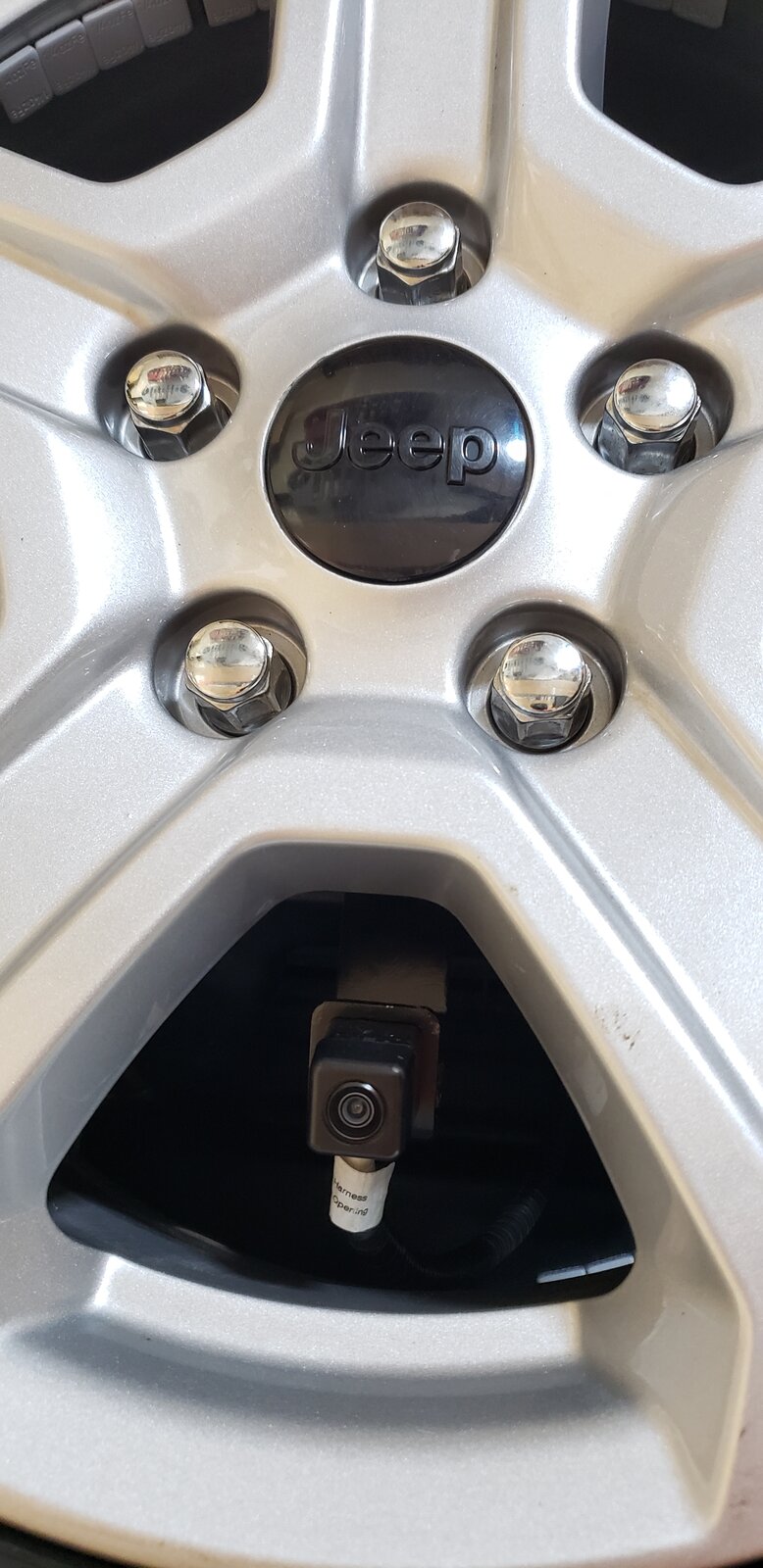

Third, with a stock TJ tire the bracket for my backup camera places the camera at the top.. However, once I put the Wheel adapter on, the JL wheel spoke was in the way. This meant cutting off the bracket part where the camera attached, then flipping and welding it on the bottom. Of course I also had to clean up the bracket and paint it.
All done now!
All done now!
Tire snubbers make good contact with that spacer on there?

Haven't forgotten about you, just haven't had time to pull the Jeep out of the garage and snap a picture or two.
