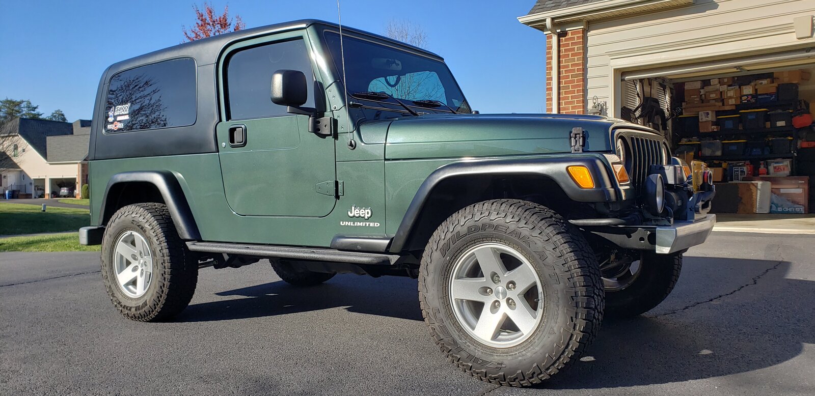

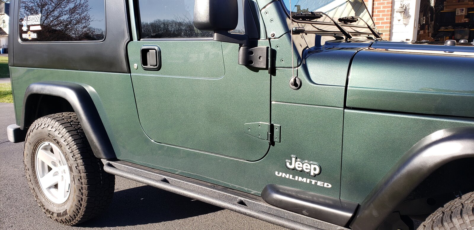

what brand of sliders/steps are those?
I'm not sure, they were on the Jeep when I got it. That said, they're mounted via the body mounts and not something you'd want. I do have Savvy sliders, but installation of those is on hold.
Reactions: SubLime
Thanks, really my TJ is a pavement queen and the wife really wants a step. The LJ is for the trails.
That's exactly the reason why I've left them on there. My wife uses them whenever she gets in-and-out of the Jeep. Very handy for that!
