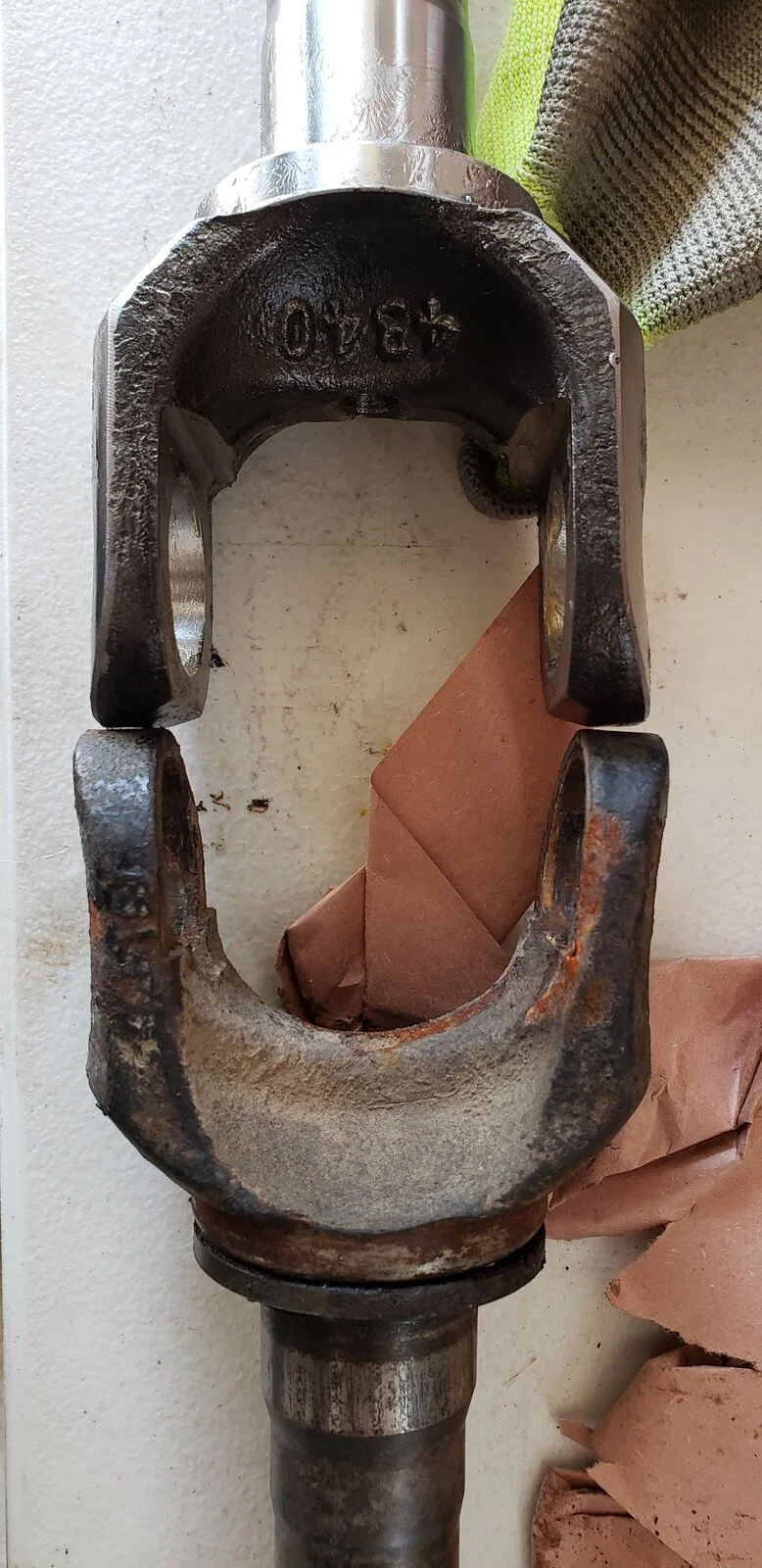

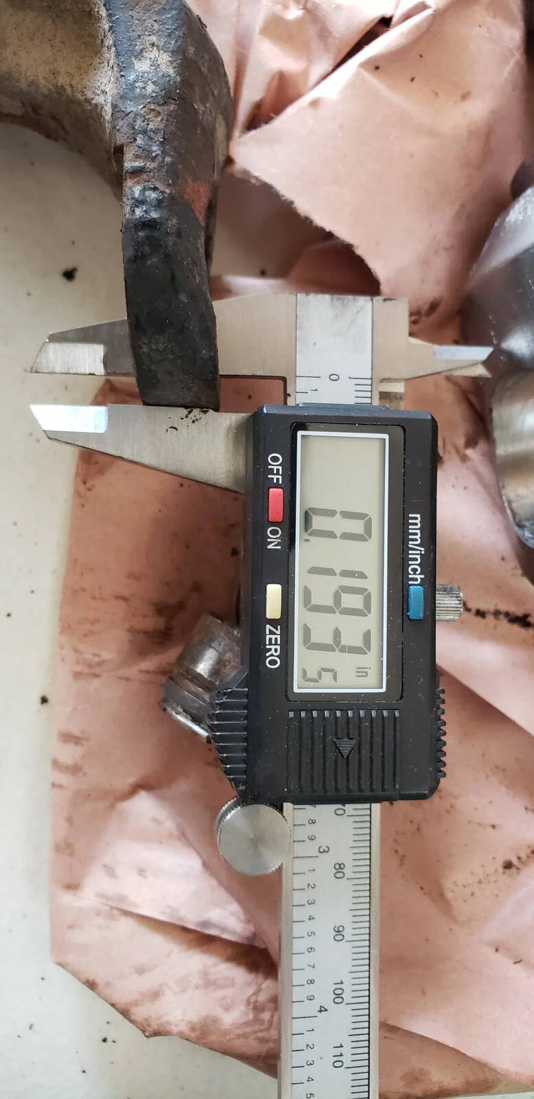

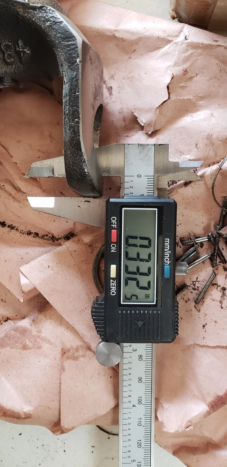

Want to see what happens when excessive tourqe is applied at the stub shaft? Before, the measurement at the ear was 3.254. After the u joint blew it was 3.378.
When did this happen?
Yeah, what he said
My apologies, I should have clarified this earlier. This is from some used parts I pick up to begin a more serious build on the LJ. In a disassembly and clean up of them, I'm trying to get smarter on why things happen and how to prevent them from happening. Because I'm not "educated" in that area, there are some things that seem counter to what I've always been told. Blaine helped correct my ignorance here. I'm also now leaning what he means when he says, and I'm paraphrasing, you don't build in fuses, you fix the weak link.
Bottom line, I may be old, but I'm not fixed in my thinking and am willing to learn. However, it does take a little bit of investigation to get smarter. This is an exercise to do just that!
