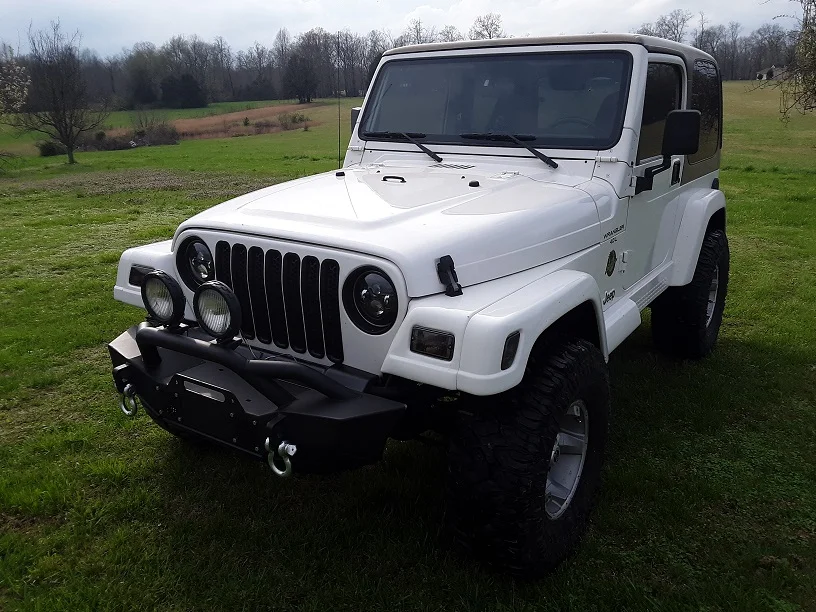

I've got LED headlights so these fog lights are nothing more than offroad lights which is why I want them on the same switch.
The reason for smoked out lights are for aesthetics obviously. They are no less visible than the factory lights.

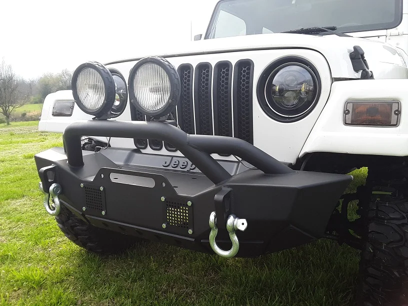

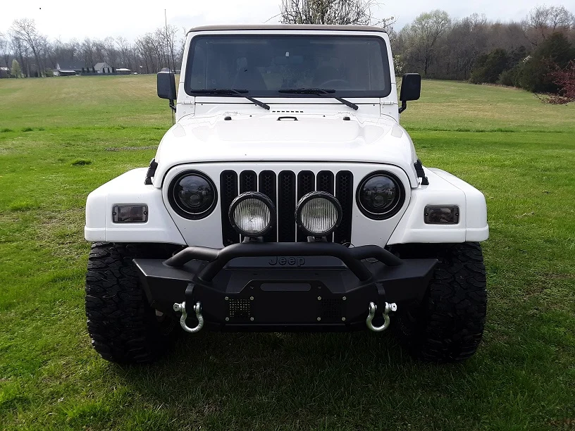

I ended up going with this bumper.
I installed the factory fog lights temporarily until I decide on what I want to do which is why I didn't run the wires through the tubing. I believe I'm gonna go with 7" round LED lights like one of these sets.
And then install these inside the bumper in the lower mounts.

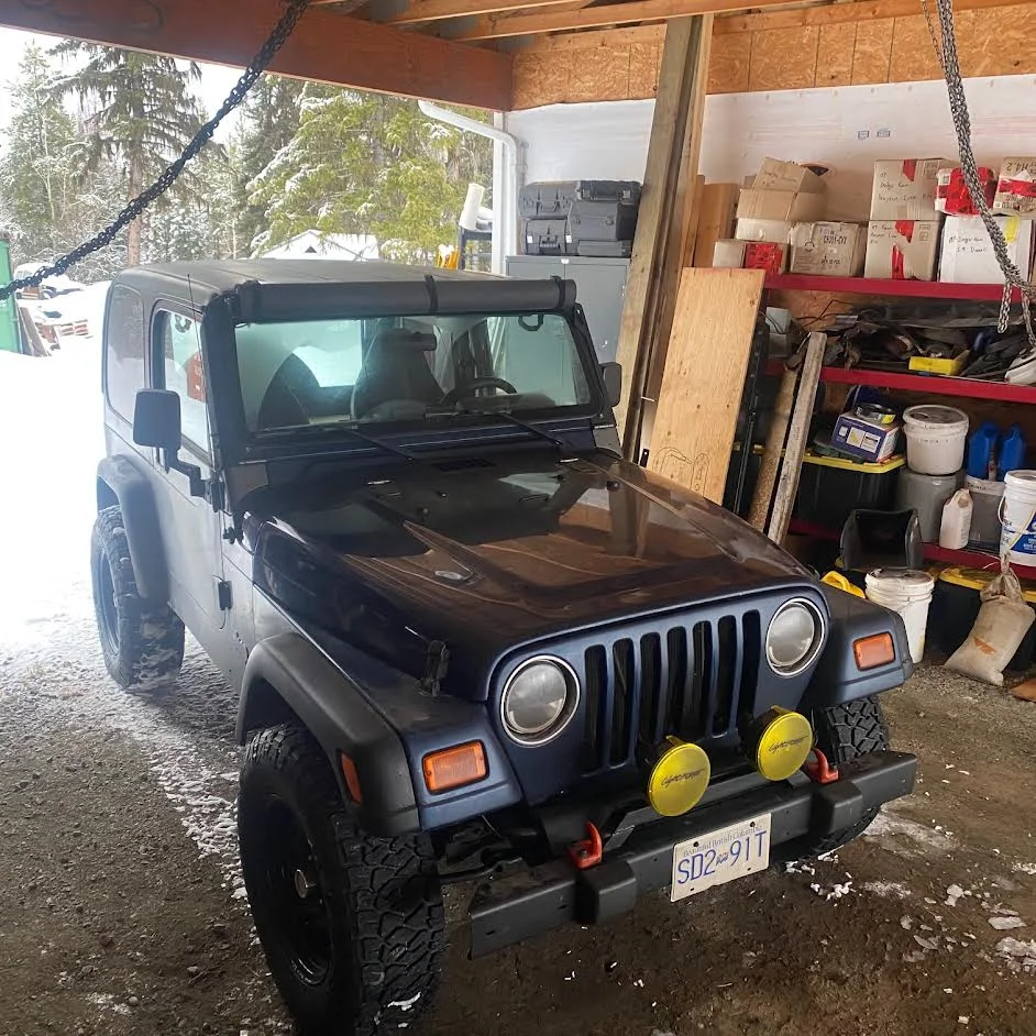

IThey are no less visible than the factory lights.
Are you sure? ;)
Depo disclaimer -
8.) 99% OF THE PRODUCTS WE SELL ARE INTENDED FOR SHOW CARS AND OFF-ROAD USE ONLY, UNLESS SPECIFIED OTHERWISE IN THE ITEM DESCRIPTION. PLEASE MAKE SURE YOU CHECK WITH YOUR LOCAL LAW ENFORCEMENT FOR THE USAGE.
Are you sure? ;)
Depo disclaimer -
I'm as sure now as I was when standing there judging them after installation comparing them to the factory lights. 😁
