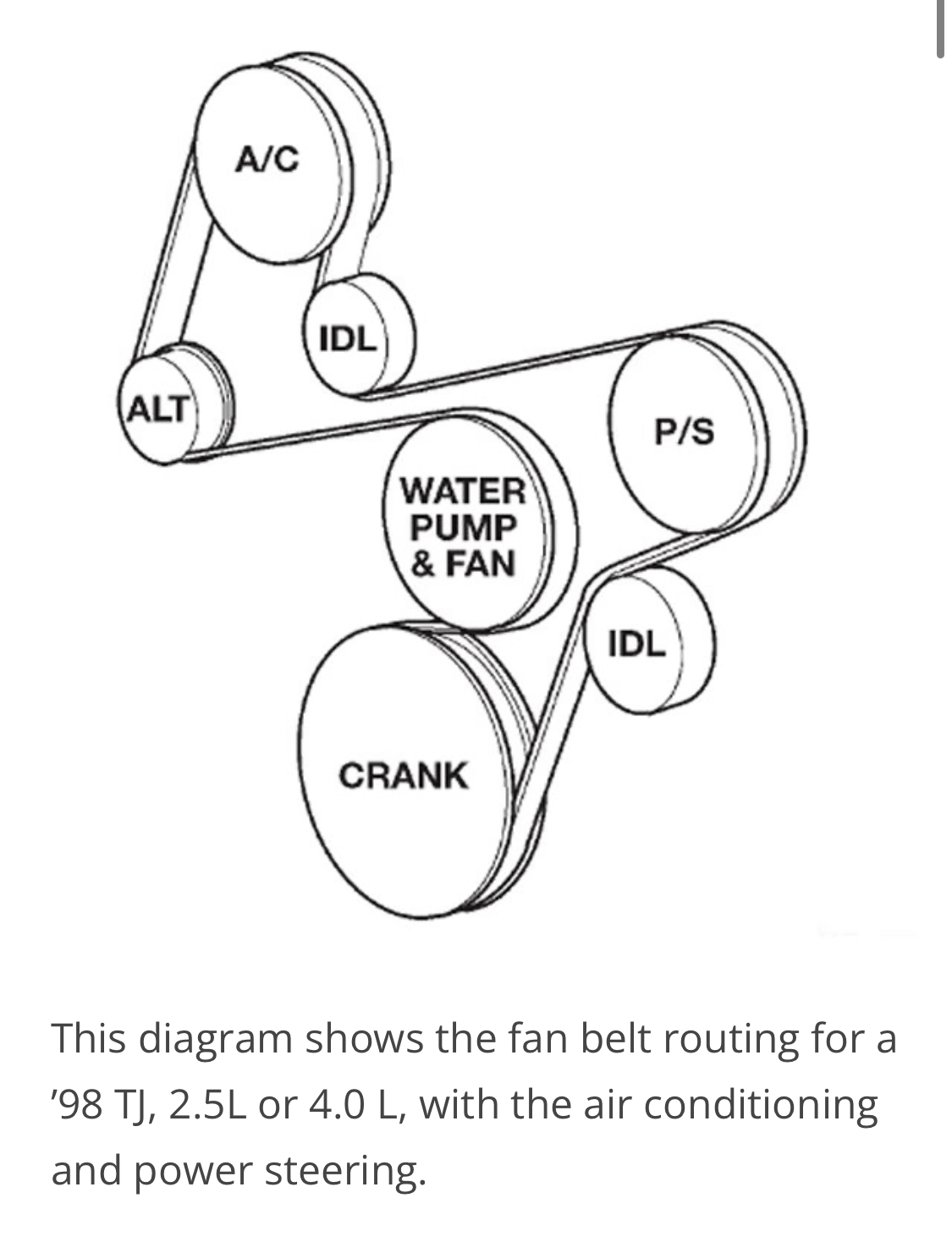

There is an idler pulley, and a tensioner pulley. You need to rotate the tensioner pulley back/down to slip the belt off.
The tensioner pulley is under the alternator in this picture.
Working on it now, have a slight problem. The idler pulley won’t loosen enough for me to take the belt off. The belt is still very tight with the pulley loosened all the way. What do I do?
You are missing something obvious or the belt would have never been able to be installed.

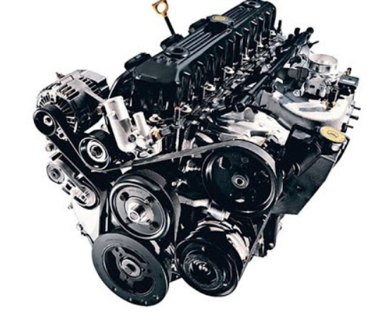

That’s not what mine looks like. This is mine
The idler pulley on the bottom right is all the way loosened, and the belt is still tight
Look down behind the bracket with the slot in it and make sure the threaded block is all the way at the end of the adjuster bolt.
I loosened it so much that the pulley came off. So the pulley is all the way off, and the belt is still tight

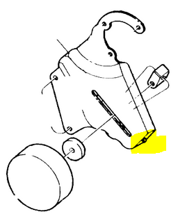

Is this the tensioning pulley and its adjusting bolt at the bottom in this setup?
If this is it, are you loosening the pulley or tensioner (highlighted)
The bolt in the pulley locks the tension adjuster in place. You have to loosen the bolt, then turn the tensioning bolt which then slides the pulley up and down in the slot.
Reactions: BlueC
The pulley moves in that slot by turning the tensioner bolt. Did you turn the bolt on top of the bracket to move the pulley all the way down in the slot?
Yes, I did that first. All the way. That wasn’t enough, so I took the pulley off in its entirety hoping that that would loosen it a bit more. Still tight
That’s what I was planning on
You do understand that if you have to cut it with the pulley removed that there is something really odd going on, right? Typically with that set up, when the pulley is all the way at the lower end of the slot, the belt will just sneak over it but once in place is not very tight at all. For it to still be too tight to remove means they did something almost impossible to install it.
Yeah, for sure. I have no idea how they got it on. It’s off now though. Thanks for your help
