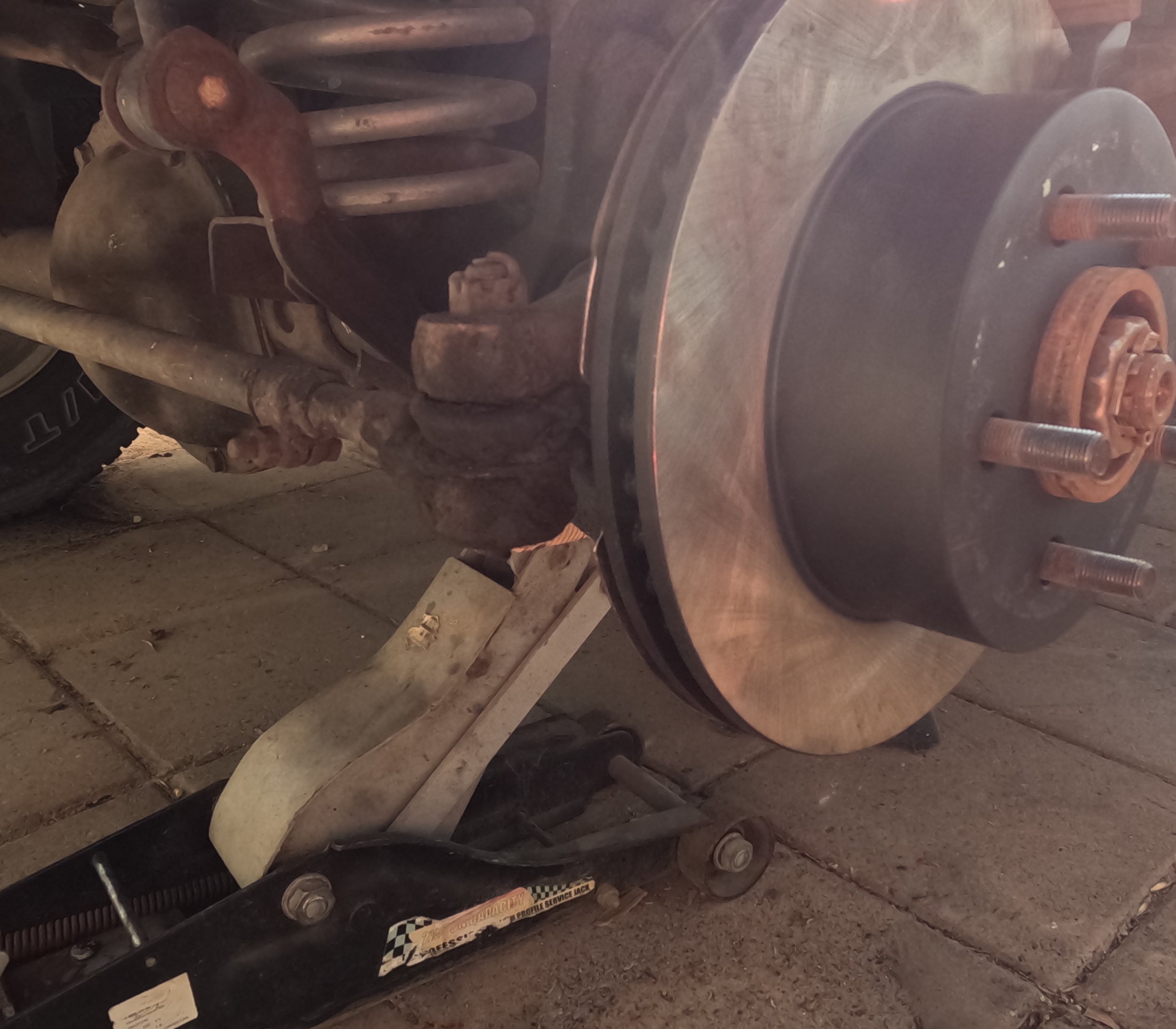

RSaucedo1 Member Original poster Joined Jan 11, 2025 Messages 32 Location Arizona, USA Nov 2, 2025 #1 My steering tie rod end needs to be replaced, any tips to successfully replace the part? I'm thinking of buying the moog brand from amazon. Thanks! Reactions: inkedrose

Chris Administrator Staff Member Ride of the Month Winner Joined Sep 28, 2015 Messages 76,801 Location Gillette, WY Nov 2, 2025 #2 It's very easy to replace. You'll just need to make sure and align it afterwards. Reactions: TJRD4, Blue Clearwater and inkedrose
RSaucedo1 Member Original poster Joined Jan 11, 2025 Messages 32 Location Arizona, USA Nov 2, 2025 #3 Chris said: It's very easy to replace. You'll just need to make sure and align it afterwards. Click to expand... thanks for responding man, any tips on aligning the part correctly? Do I count the threads?

inkedrose washed up superhero Supporting Member Ride of the Month Winner Joined Dec 22, 2020 Messages 1,516 Location Arvada, Colorado Nov 2, 2025 #4 Here’s a quick explanation https://wranglertjforum.com/threads/diy-alignment.65839/ Reactions: Chris and tr21triton
TJ4Jim TJ Expert Lifetime Supporting Member Joined Dec 9, 2015 Messages 4,140 Location Brookings, Oregon Nov 2, 2025 #5 RSaucedo1 said: My steering tie rod end needs to be replaced, any tips to successfully replace the part? I'm thinking of buying the moog brand from amazon. Thanks! View attachment 652873 Click to expand... I installed the Moog ends and links just about 6 years ago now. No issues at all..... Reactions: tr21triton

Chris Administrator Staff Member Ride of the Month Winner Joined Sep 28, 2015 Messages 76,801 Location Gillette, WY Nov 2, 2025 #6 inkedrose said: Here’s a quick explanation https://wranglertjforum.com/threads/diy-alignment.65839/ Click to expand... This is very worth reading. Pretty easy to do too. RSaucedo1 said: thanks for responding man, any tips on aligning the part correctly? Do I count the threads? Click to expand... Read the above thread. If you follow that thread you'll do it right the first time and you won't need to pay to have it aligned. Reactions: inkedrose

TJRD4 Member Joined Dec 2, 2023 Messages 68 Location NC Nov 3, 2025 #8 Check these out: https://metalcloak.com/metalcloak-toe-alignment-tool.html I picked up these alignment brackets from metal cloak a while back and have gotten good results. The brackets helped hold the tape measures together and pay for them self after the first use.
