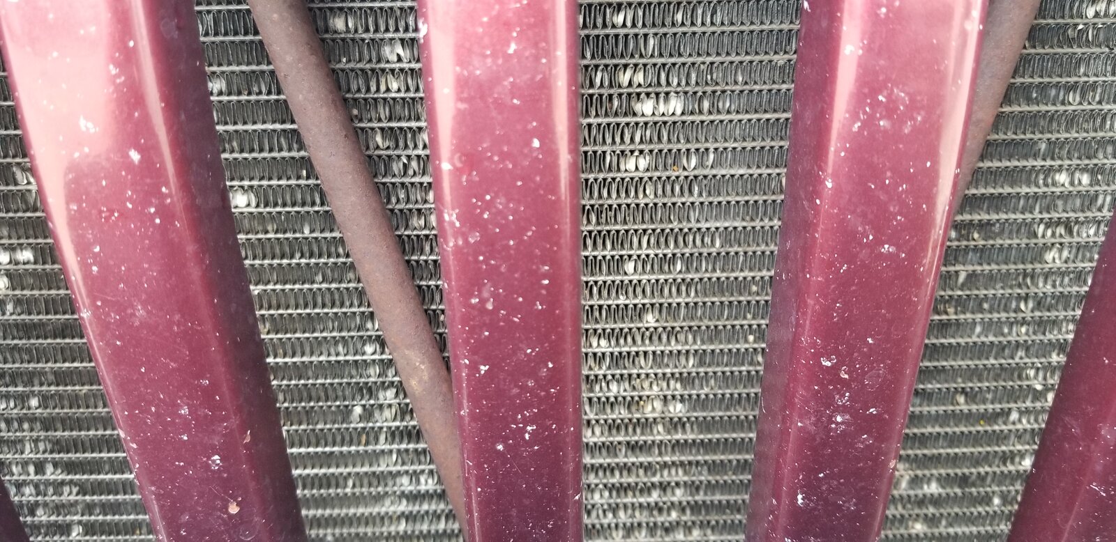

Before you swap anything, do the flush, then make sure the AC condenser and radiator do not have any blocked fins.
Definitely appears to be rust inside mine. I ordered the product.
I may comb my condenser fins as well.

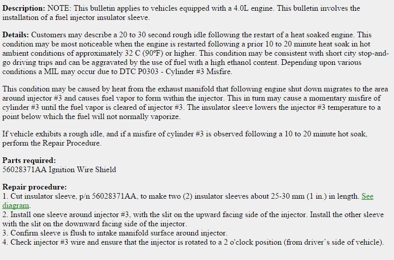

Unfortunately I have had zero improvement on my hot starting issue.
Last Saturday I pulled the trailer at 70mph for approximately 60 miles at an ambient temperature of approximately 70 degrees. My temperature gauge never passed the 210 mark and ran fine. I stopped at a gas station to see how it would react with the engine off for 15 minutes before restarting. The temp was showing a little over 210 ignition on and engine off from sitting without water flow and then after starting returned to 210.
It started and ran roughly for a minute or less. Felt like it had a bit of a miss and has a knock as it runs until smoothing out.
Without pulling the trailer this doesn't happen unless it is 95 degrees plus and stuck out on trails crawling around for hours. I have some heat shielding for the injectors and fuel rail lying around I may try, but it appears that a mopar radiator is the next step to eliminate the aftermarket oreillys radiator as the issue unless I have gathered the information wrong.
I don't mind an expensive aluminum radiator as an option if there is a good track record but it sounds like that it just doesn't exist from some thread searches.
A new radiator will not improve your hot start issue. If the cooling system is able to maintain 210 it's fine. Hot restart problems are usually a result of fuel system issues. Check your fuel pressure when it is running rough. Also make sure the factory fuel rail heat shield is installed.
