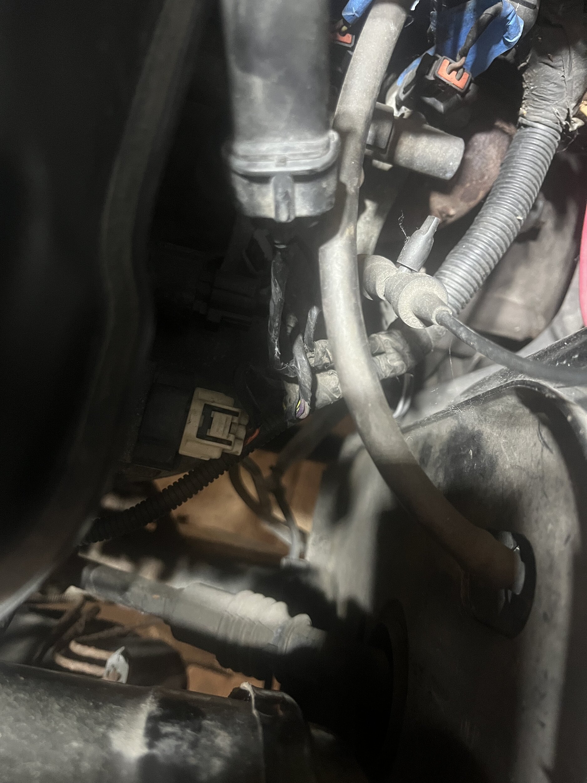

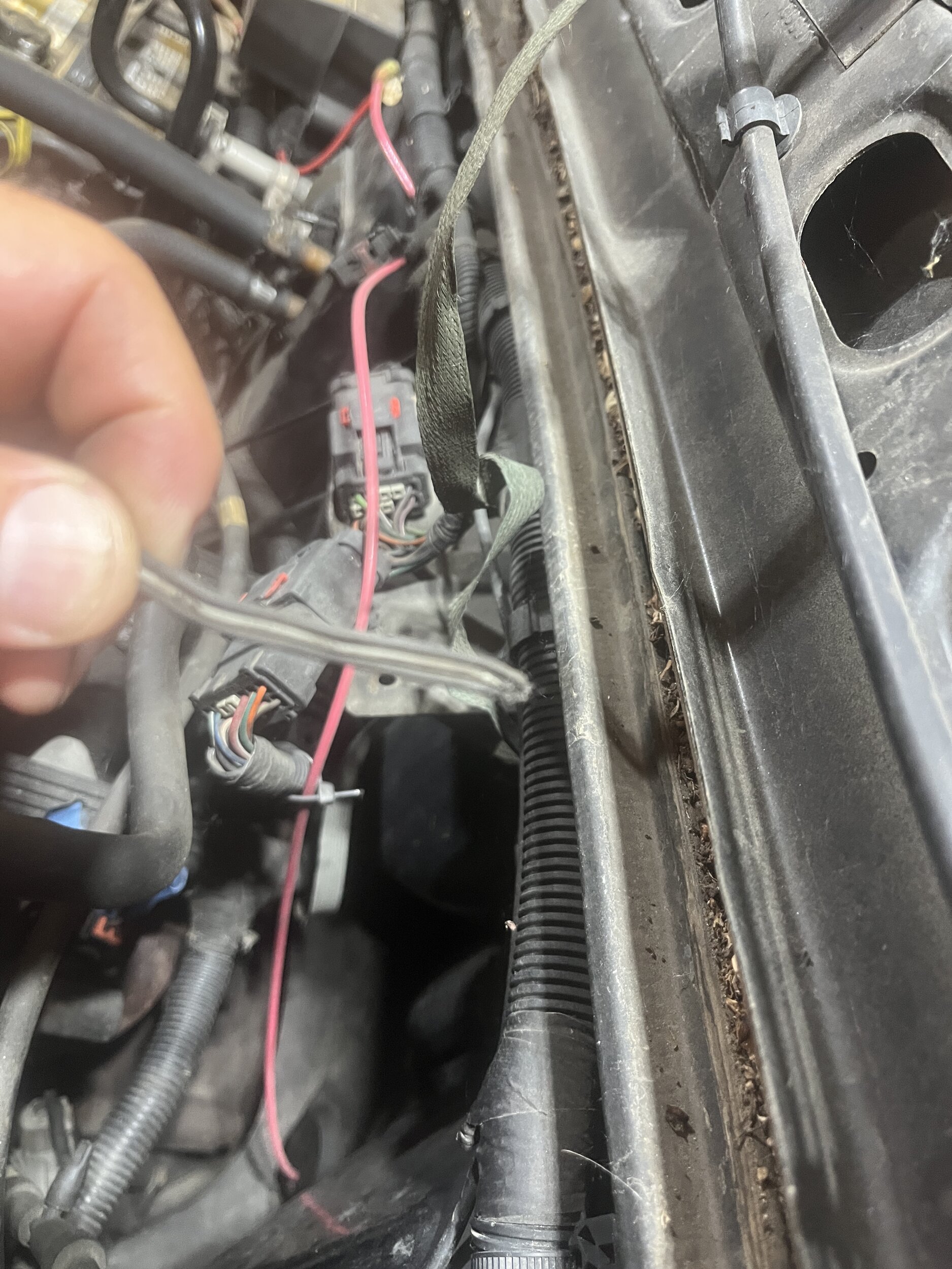

I recently replaced the clutch in my 98 TJ 2.5L and after assembly, found a 3 wires (1 bundle) severed and I cannot figure out where they go. The come out of the harness behind the throttle body between the firewall and throttle body and have a 3 pin plug on them. The back side of the 3 wires is black, but when I flip it over the center wire has a white stripe. I believe this is preventing my engine from starting.
The engine will sit there and crank, but it will not start. Prior to me, taking the transmission out, the engine started fine.
