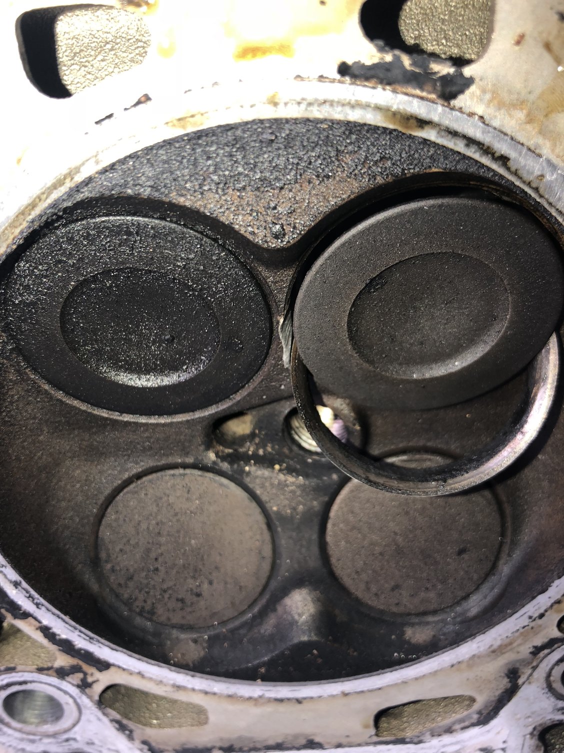

I think they should all be at the same height. If that is the only one at that height, I would guess burned valve or seat which means the head will have to be pulled.
So… I’m going to follow thru with the service bulletin, but does this indicate a bad valve seat? Why would the spring present itself higher? If I understand it’s sitting higher that means the valve is not stuck open but closed father than it should be?
I’m sure the answer would present itself with pulling the head but that’s a farther job than I might be willing to get into at this point.

That makes sense. Could the same be true if the valve is too far up? Once the rocker arms were off. You can see the exhaust valve was farther UP than down. If the “seat” is busted or burned, could that happen?
I guess I’m not 100% opposed to pulling the head, I just don’t know if there’s more trouble lurking on the bottom end as well.
One is high or one is low. I think installed height is around 1.6" Valves bend or stretch, seats get damaged and chunks of pistons or rings embed themselves in crazy places. I think you're going to find some interesting stuff when you pull the head. If you have a bore scope or are able to see there is a tiny possibility something crazy is wedged in there and when you pull the intake you'll be able to get at it but that's a Hail Mary for sure.

After breaking many things, one thing I can say is that things can break weird. No telling until you get a good look at what's going on. Any way you slice it that head is coming off I think.
Reactions: pagrey

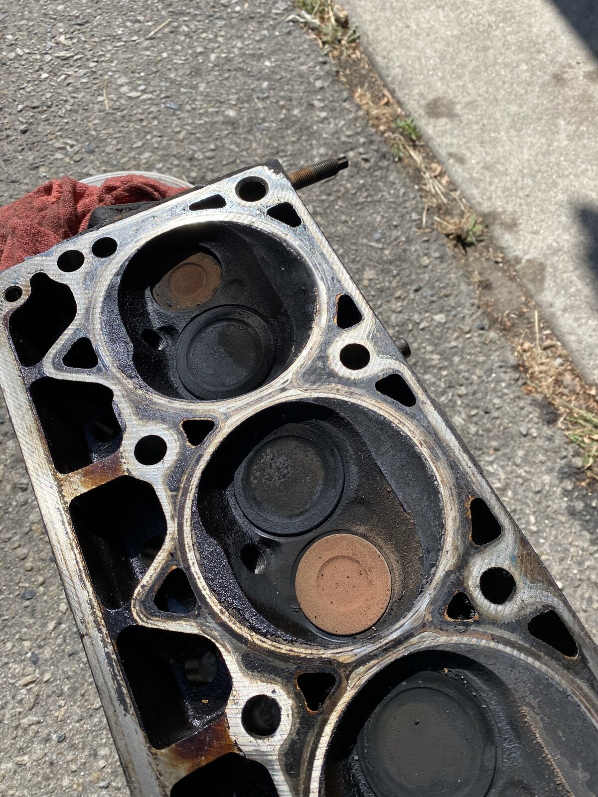

A little recap/catch up…
Ended up pulling the head and found a bad exhaust valve as expected. They also found a crack in the head. Boo. (Shout out to Cylinder Head Exchange in Sun Valley, CA).
I ended up getting a rebuilt head and installing with little issue, but now I’m getting the P0421 - which is basically a catalyst failure. Had a suspicion this would happen with misfire running for so long. Luckily there’s a Jeep junkyard nearby as well so I’m pulling the cats off of a junker and should be able to finally get back to CEL zero!
Ended up changing the lifters and everything in the top end. Hope to do the chain, cam and low end components eventually. Probably should’ve done it at the same time, but I was on a race to drivability.
There’s still some knock which I’m 99% certain is chain slap now. Cylinder bores looked fantastic and no evidence of blown piston rings or anything.
* added some before and after of the piston cleaning.
