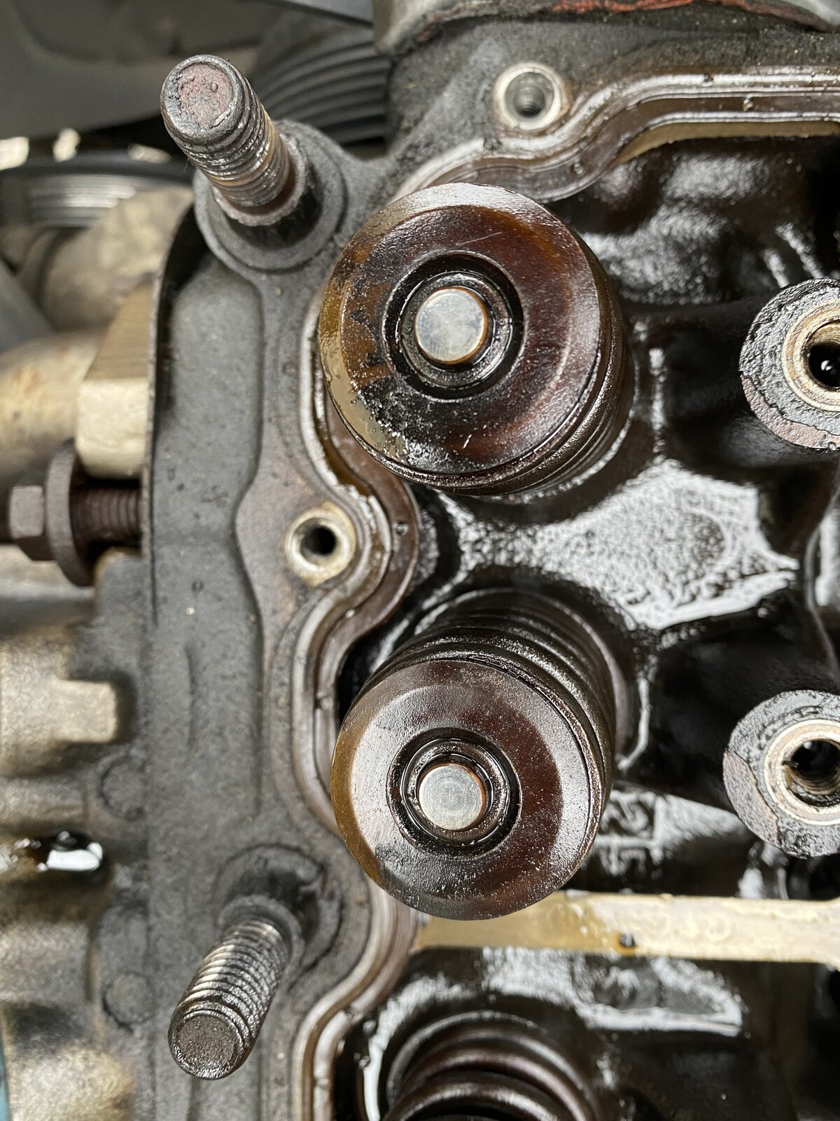

Update: got all the tools to accomplish the task, went ahead and pulled rocker arms and pushrods hoping for a bent push rod but all were straight….only thing of note was that they were completely caked in crud. If that’s the state of the innards, I’m guessing the stuck valve may be correct, if not worse. I’m not sure if I noticed the “bullseye pattern” on the affected cylinder so I’m hoping it’s stuck and this job will free it!
That said, the pattern is very very faint on all valve stems so I also admit I may be shooting in the dark here.
Ha, me too. Might research TSB 09-003-03. There's a thread here about it somewhere but the search didn't show anything.
Probably going to end up posting this since there’s not a single dedicated thread to the TSB, but sure looks like the intake valve (bottom) has more of the bullseye pattern than the exhaust for cylinder 1.
Also I’ve seen some folks mentioned “the ruler test”… Looks like the exhaust valve spring is sitting higher than the intake. But, I may be stepping over my knowledge at this point.
I haven't read back farther than the pic. They are supposed to be level if they are both on the base circle of the cam. Are you sure they are?
Oh, and duh. Clearly no rocker arms in that pic. I wish I posted that later in the day so I could blame it on 🍺
So… I’m going to follow thru with the service bulletin, but does this indicate a bad valve seat? Why would the spring present itself higher? If I understand it’s sitting higher that means the valve is not stuck open but closed father than it should be?
