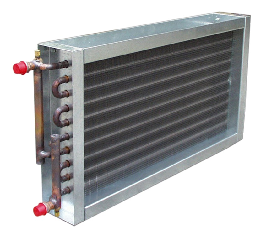

Our coils are generally applied in large commercial and industrial HVAC equipment with higher expectations for longevity, so the construction differs. We build mechanically bonded round tube/plate fin (RTPF) type cores and braze the coil tubes into a main header/distribution tube.

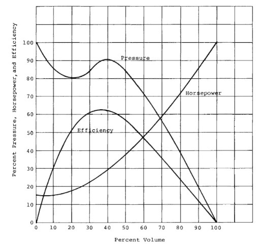

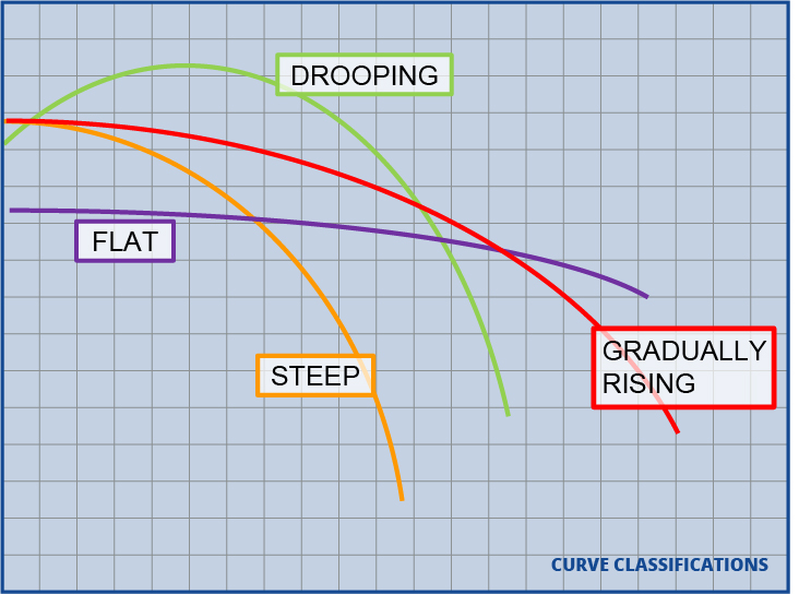

For example, if we're already out on the right of the water pump curve and it happens to be reasonably steep, then that means the flow rate (x axis) would be more tolerant to increased fluid pressure drop (y axis). Flat would be very sensitive.
Fans have a different shape but the same principle applies. Not only do we hope to be out to the right for the reduced sensitivity to pressure drop, but we also want to stay out of that hump area where 2-3 different volume flow rates can result from the same pressure, because it likes to switch unpredictably back and forth between the solutions, making lots of noise and possibly damaging the fan.
