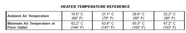

Stick a thermometer in the vent and see if it meets spec:

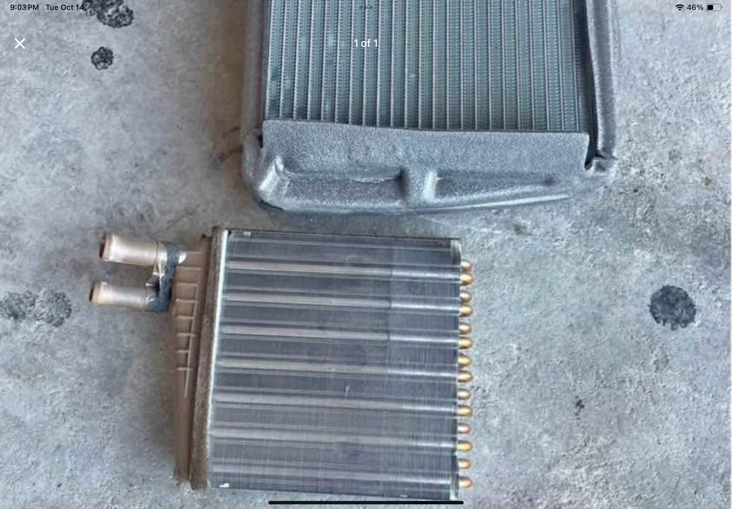

I got me a used heater core and air conditioner condenser for $40 plus shipping on marketplace. I’m going to get the heater core flushed and checked out at a radiator shop and make sure it’s ok, before I spend another 500 bucks to get it put in.
Maybe I’ll have a Jeep I can run this winter.
