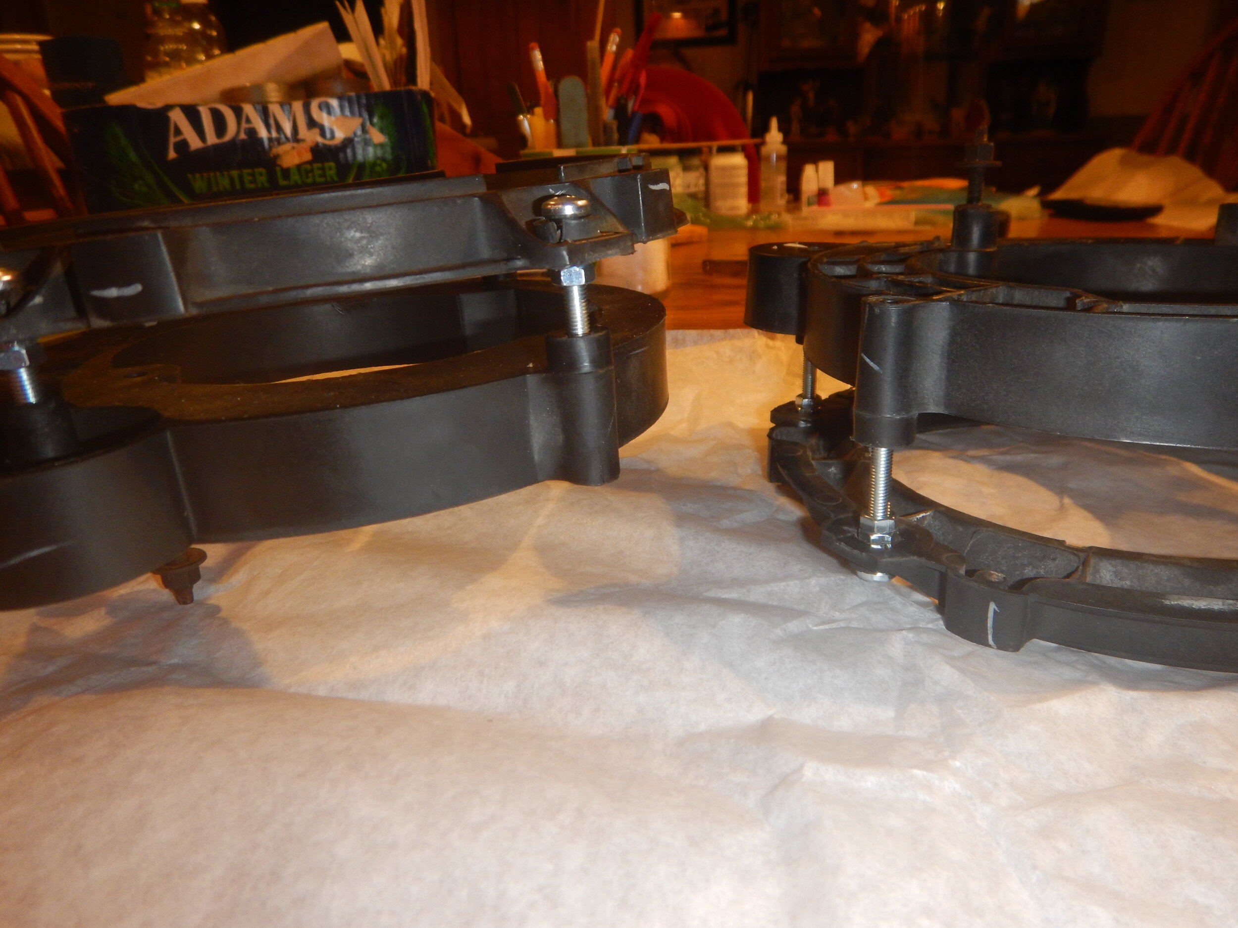

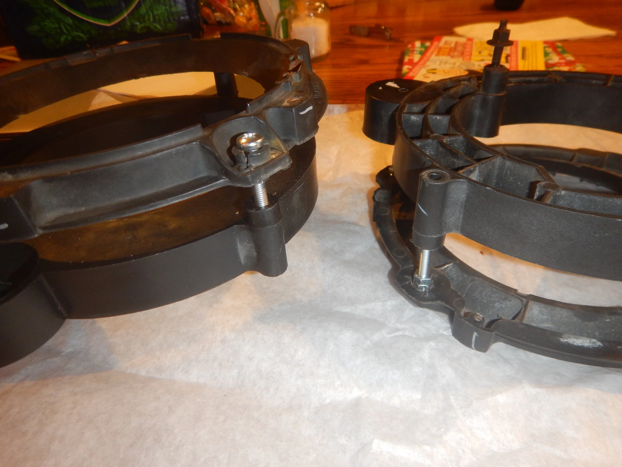

I had the same problem. I pulled the whole bucket, got out the Torx headed screws and replaced them with M5-.80x50 screws and used two nuts together to lock it under the adjustable part. Screwed into the plastic base with no issues. Total cost at Lowe's $5.05 including tax. I can post pictures in anyone wants.

Yes please.
I didn't use any washers as it didn't see necessary. It seems one of the screws is fixed and the other two do the up/down and side/side adjusting. I haven't installed them yet. This gives me access to the backside of the fender bolts. New fenders are the next step. I'm also putting in new shifter boots; a mouse ate thru both.
