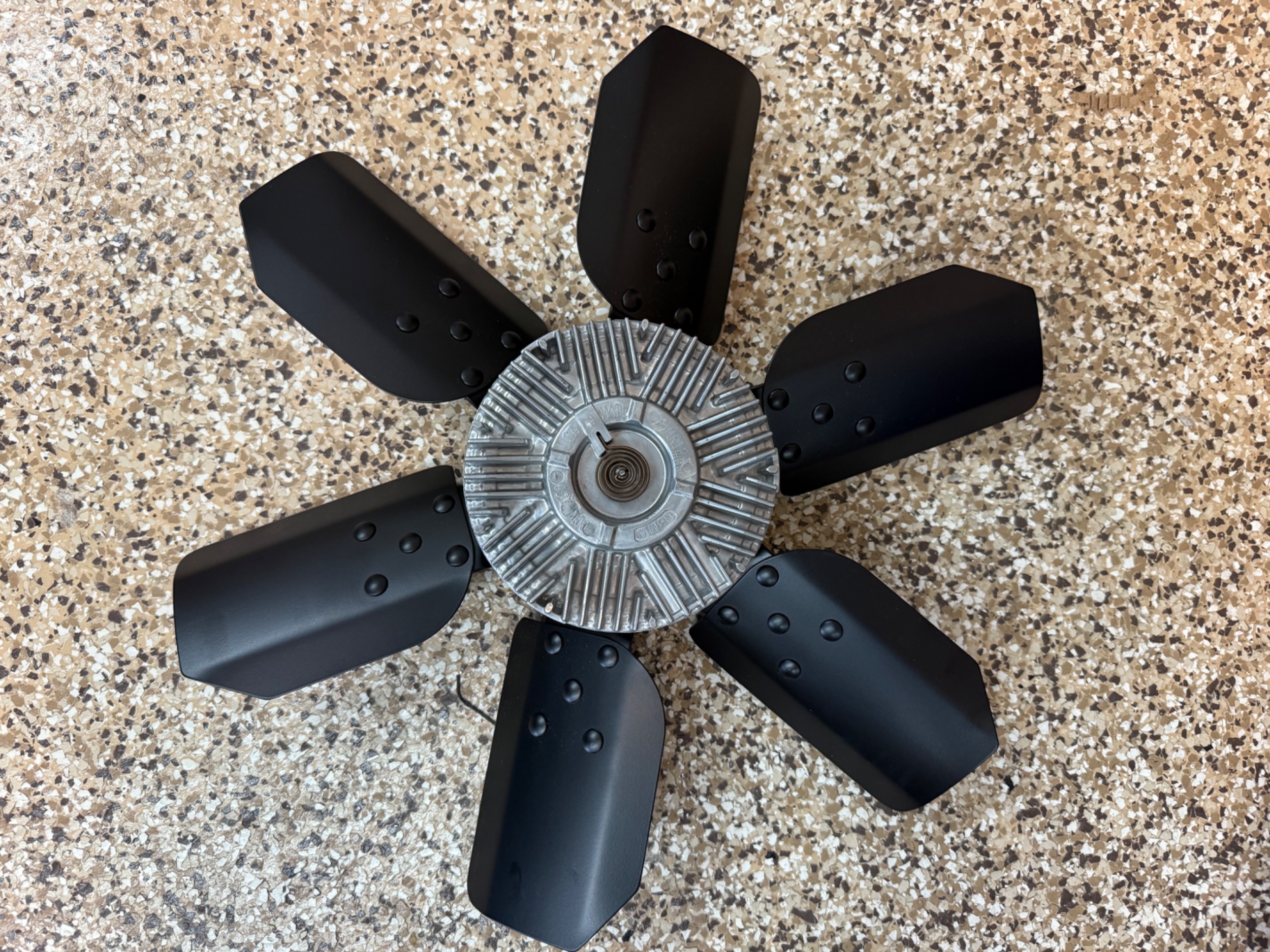

I opted to try the USMN as the 2791 I have has always been very quiet. Even at initial start up and quieter then the Mopar was. Guess only way to know is to try it.
