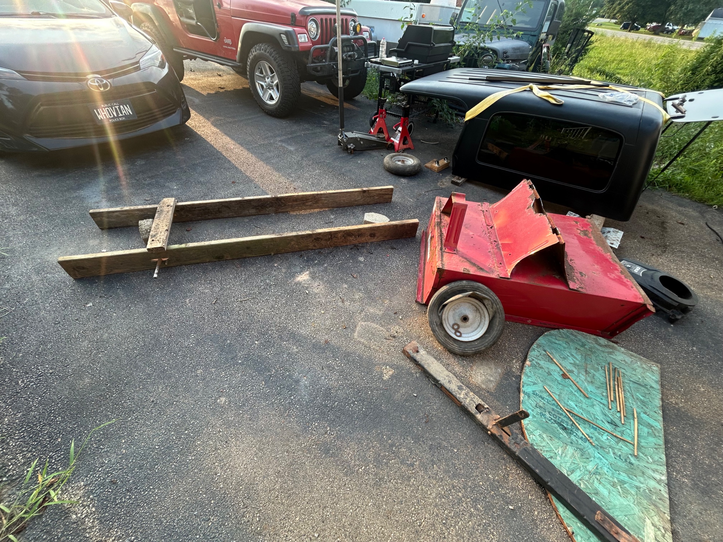

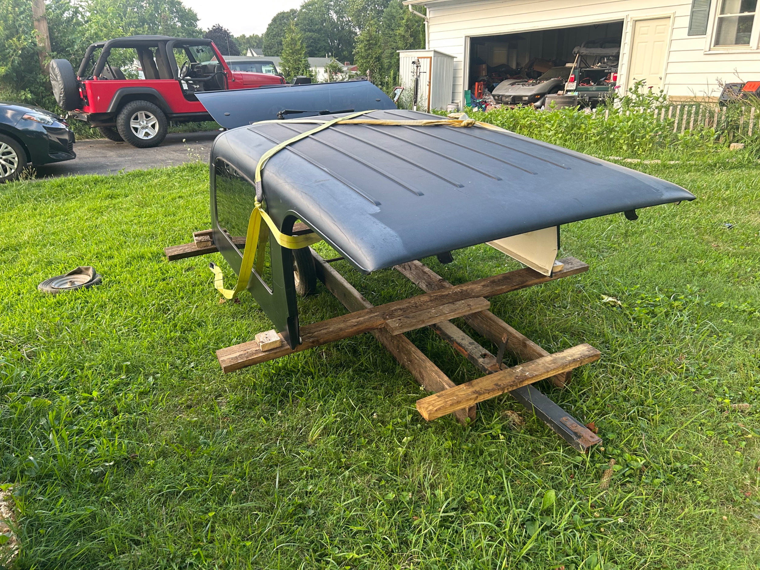

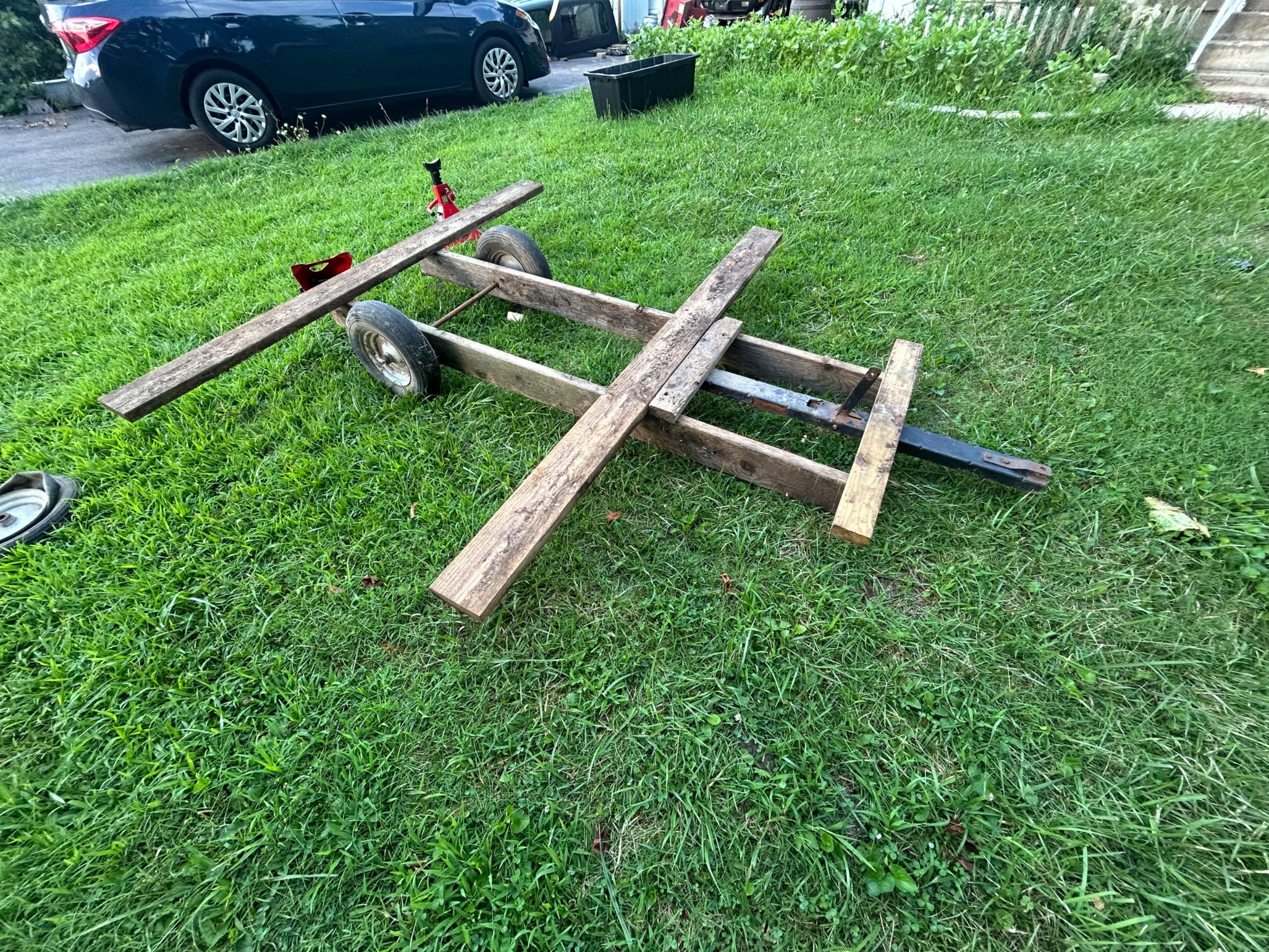

Well took all summer but I made this for only the cost of some screws. The lumber was free, and I got a scrap lawn mower dump trailer that I used the wheels, axle and trailer tongue from. Not perfect but good enough. The only thing I wish I did different was either widen the frame or narrow the frame so the engine hoist can actually fit through it, but thats a future me problem. Also might look into what it would take to have it sealed up when stores away. Its already been sitting in the elements all spring and summer so not like I am in a hurry to do it now.

One change from damaging mine - you might want to add a 2x2 around the inside of the top where the hardtop would sit on the tub - you might crack the fiberglass exterior having it ride/rest on the lip.

What this guy said. Flat 2x4's works as well, solid protection for a very common damage area.

Good point, I will add some supports up front.

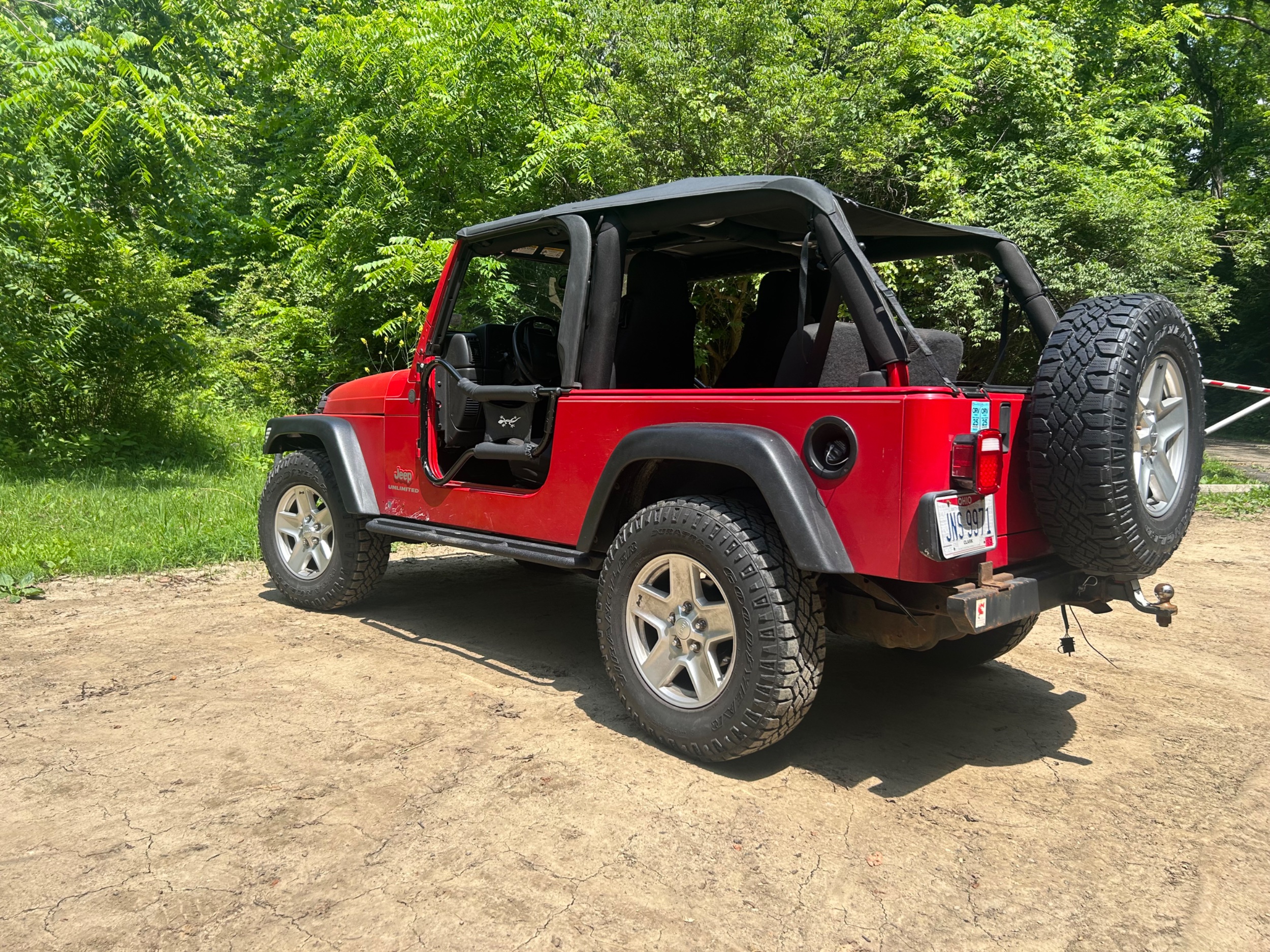

Got any closer pics of those newer Jeep wheels on yours?

Had to get 2 sets of 4 wheels since they are from a JT for a whole whopping $50 and a set of take off Duratrac tires for like $600.
