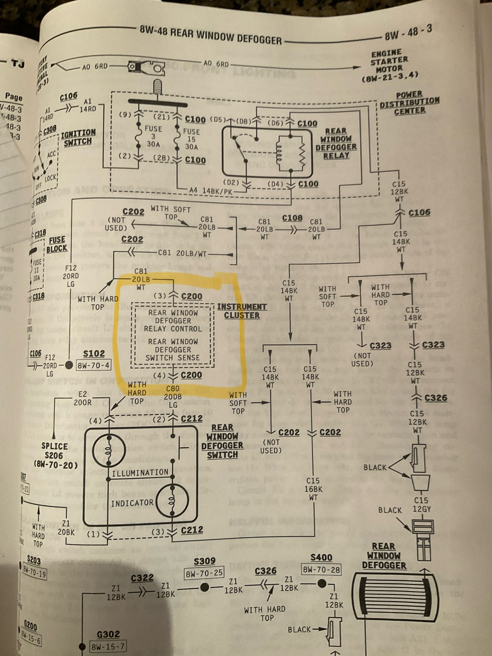

1. I‘d like to run the defroster switch through the instrument cluster as shown in the FSM. Is this “rear window defogger relay control/switch sense” item just a lamp indicator in the cluster? See attached picture.
2. Will this be in my instrument cluster, as my TJ was originally a soft top?

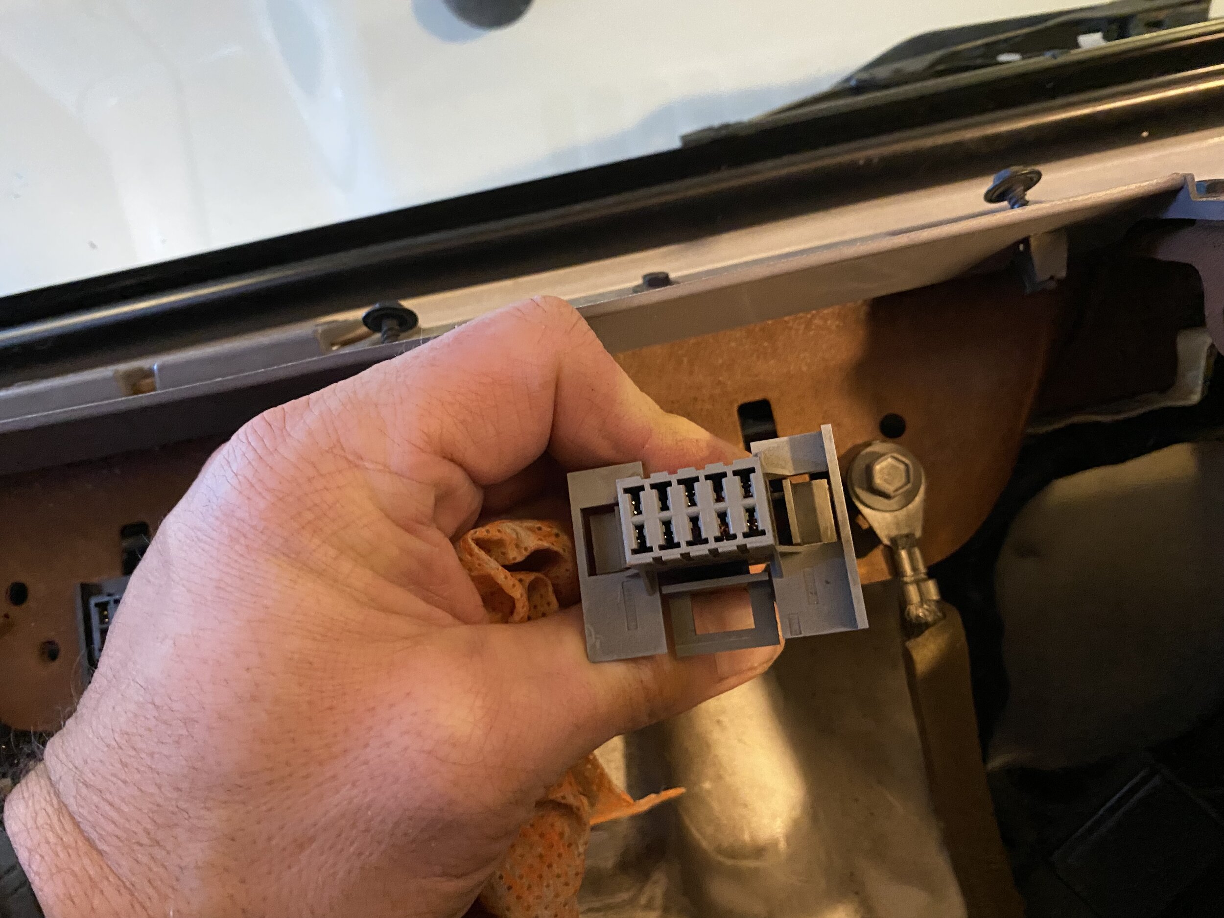

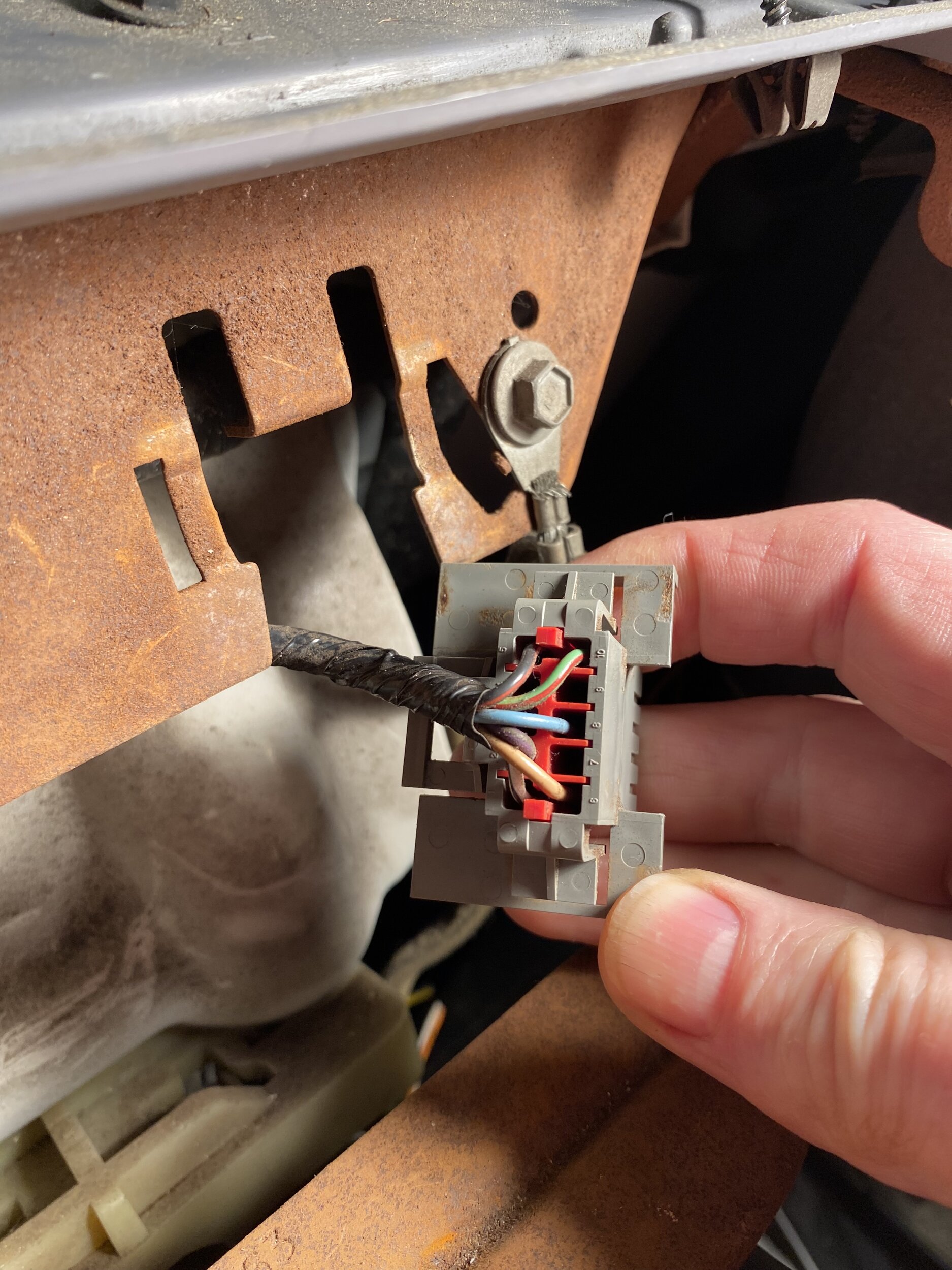

3. Does anyone know what size or ‘type’ of pin connector is used in the instrument cluster connector? If I want to add this circuit, what pin type do I need? See picture.
Yes, it's the light in your instrument cluster.

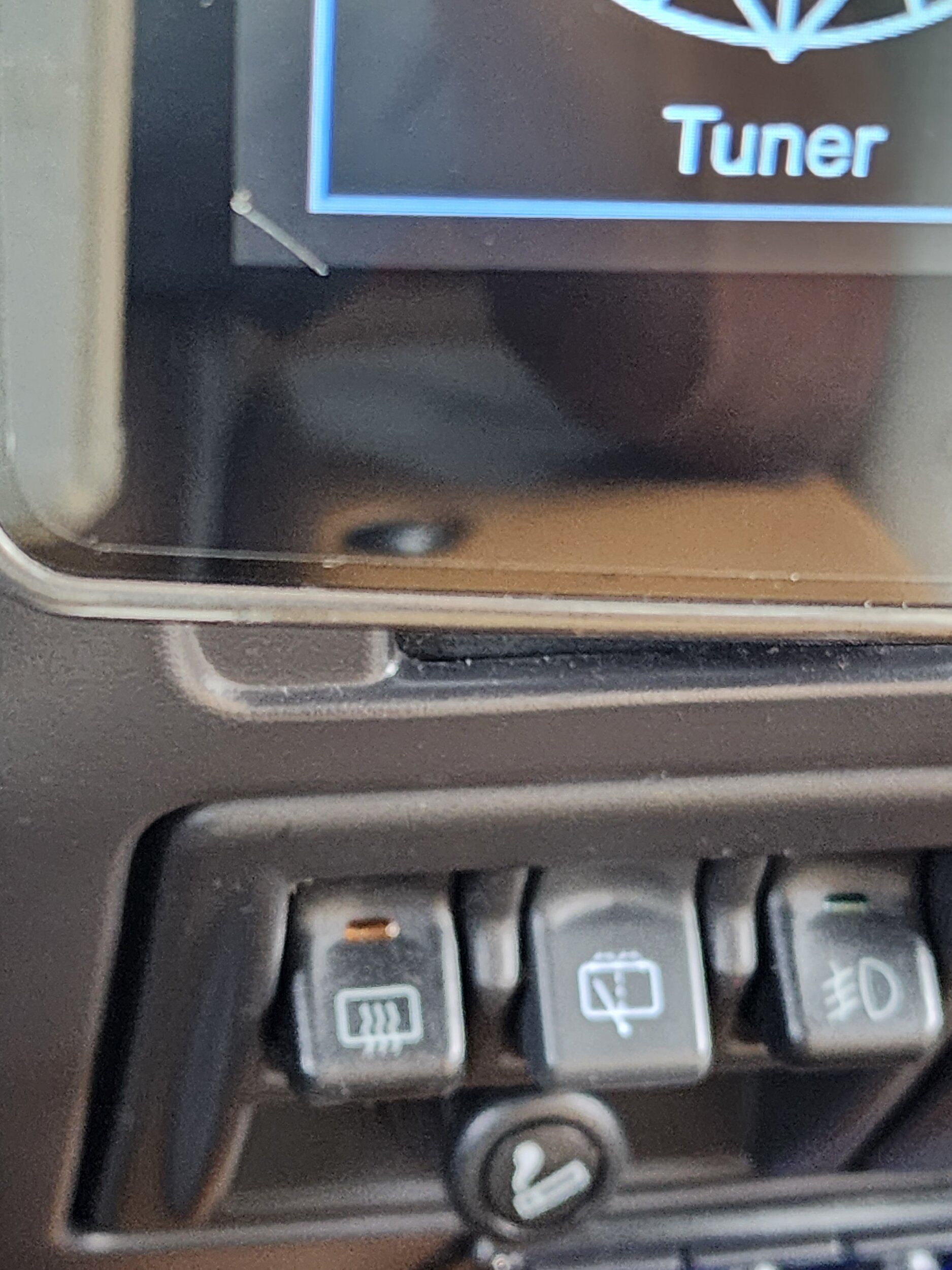

Yes, it should have the provision for this since Jeep probably didn't change out an entire cluster just because it had a hard top or soft top. Take a fairly bright flashlight and shine it on your cluster through the clear plastic, you can see all the indicator light provisions with a flashlight.
You'll have to pull your cluster to see if the light/socket is there. Match the provision as stated above with the back of your cluster. If I remember correctly, it's a light CC twist and when you feel it "click" it should release and you can pull it out. The light will be similar to what's used for your "4WD" indicator. You may have to do some searching on eBay or Amazon for the socket and light.

There’s no light in the cluster. The reason it goes through the cluster is because there is a timer built in. IIRC it’s ten minutes with the first push, and an additional five minutes if you push it right after the first ten minutes are up.
I had to do some custom wiring when I replaced my OEM switch panel with a custom thing so I did some studying on this circuit. There's a timed relay in the instrument panel that de-engergizes the defogger relay. The light on the switch is actually powered from the same leg of the relay that powers the defogger.

My third question on the original post was actually about the pins inside the connector of the instrument cluster. If I want to add that circuit through the cluster, does anyone know the size or name or type of connector pin that goes on the end of the wire and into the connector? I think I have to add this loop through the cluster to get the timer functionality. But I don’t know what pin type is inside of that connector. I’m looking for something along the lines of what’s shown on this picture. I can measure the blade width on the cluster side, but what shape goes into the connector side?
After some more digging I believe the cluster uses a 2.8mm molex blade connector. But I’m still not 100% sure of the shape or if there are multiple shapes. I was thinking maybe I couple de-pin one of the wires and see what it looks like, however I can’t figure out how to do that either. Does anyone know how to take this connector apart? It looks like you should be able to pinch the red tabs and pull it out, but I tried multiple times and it won’t budge. Seems like I’m missing something.

When it says 'sense' it means the cluster is looking for a signal from an input; in this case the rear def.switch.
I can't remember who, but someone on here has a good post about what pins are used where (with links to buy).
You'll probably need a special pin extraction tool. Usually inserted in the front to pull wire out from the rear.
FSM 8W-01-11 shows how to get the pins out.
