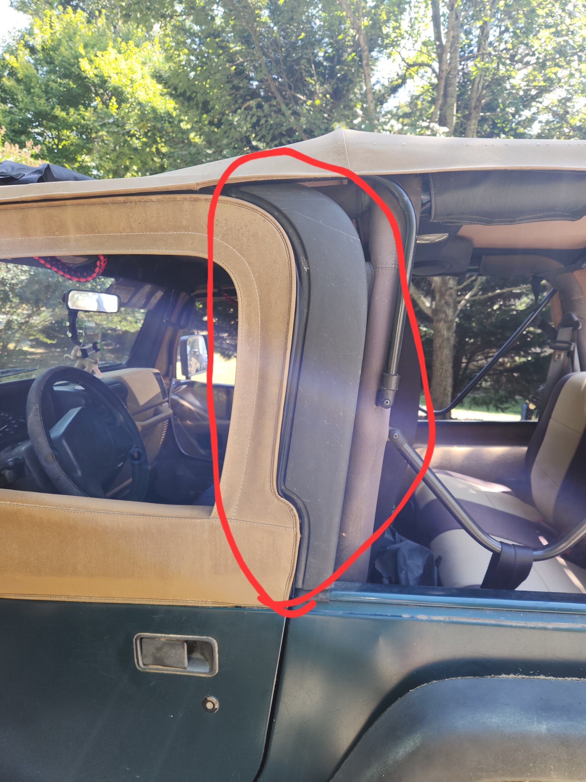

Hi I'm buying a used hard top so that I can switch from my soft to hard top in the winter. I will be keeping at least for now my half doors with soft uppers.
Will I need to remove that black plastic trim (flange?) piece on the right side of the window in the picture (anyone know what it's called)? I'm assuming I will need to bc the hard top has its own "flange" there. I'm not seeing any screws tho - any suggestions on how to remove?
Thanks!

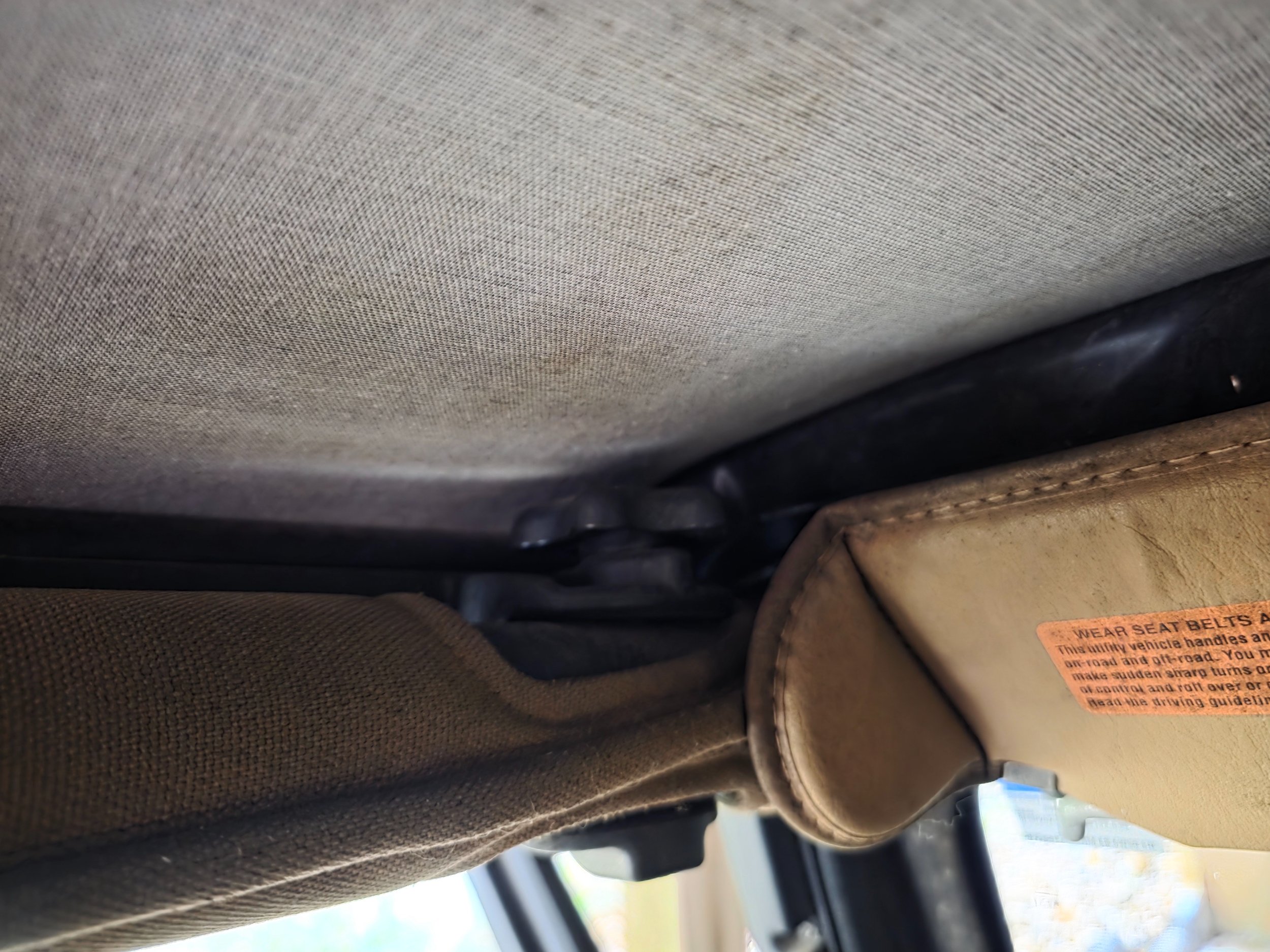

there should be 2 knobs along the top that you unscrew to remove it .this one and one further back
