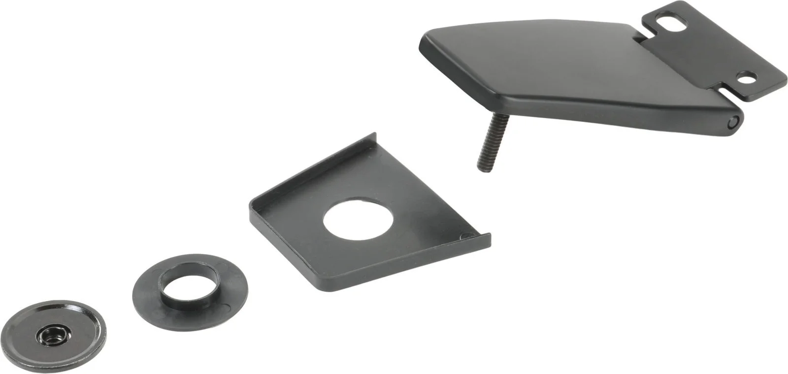

Those hardtop hinges should have some plastic seals underneath them like this:
Are you missing the seals?
Also, you could always use clear silicone caulking.
Thanks for the quick response Chris. I haven't disassembled a hinge yet but from what I can see I don't think they've ever been disturbed. If the seals depicted in your response have cracked with age I imagine a fair amount of water could make it inside since the shape of the hinge section attached to the outside of the glass looks a little like a scoop at the top just below the pivot, filling with water and leaking inside around or through a split or shrunk seal. I'll see if I can find just the seals and replace them along with a touch of RTV for good measure. If not I'll bite the bullet on new complete hinge assemblies with a little sealant and report back.
