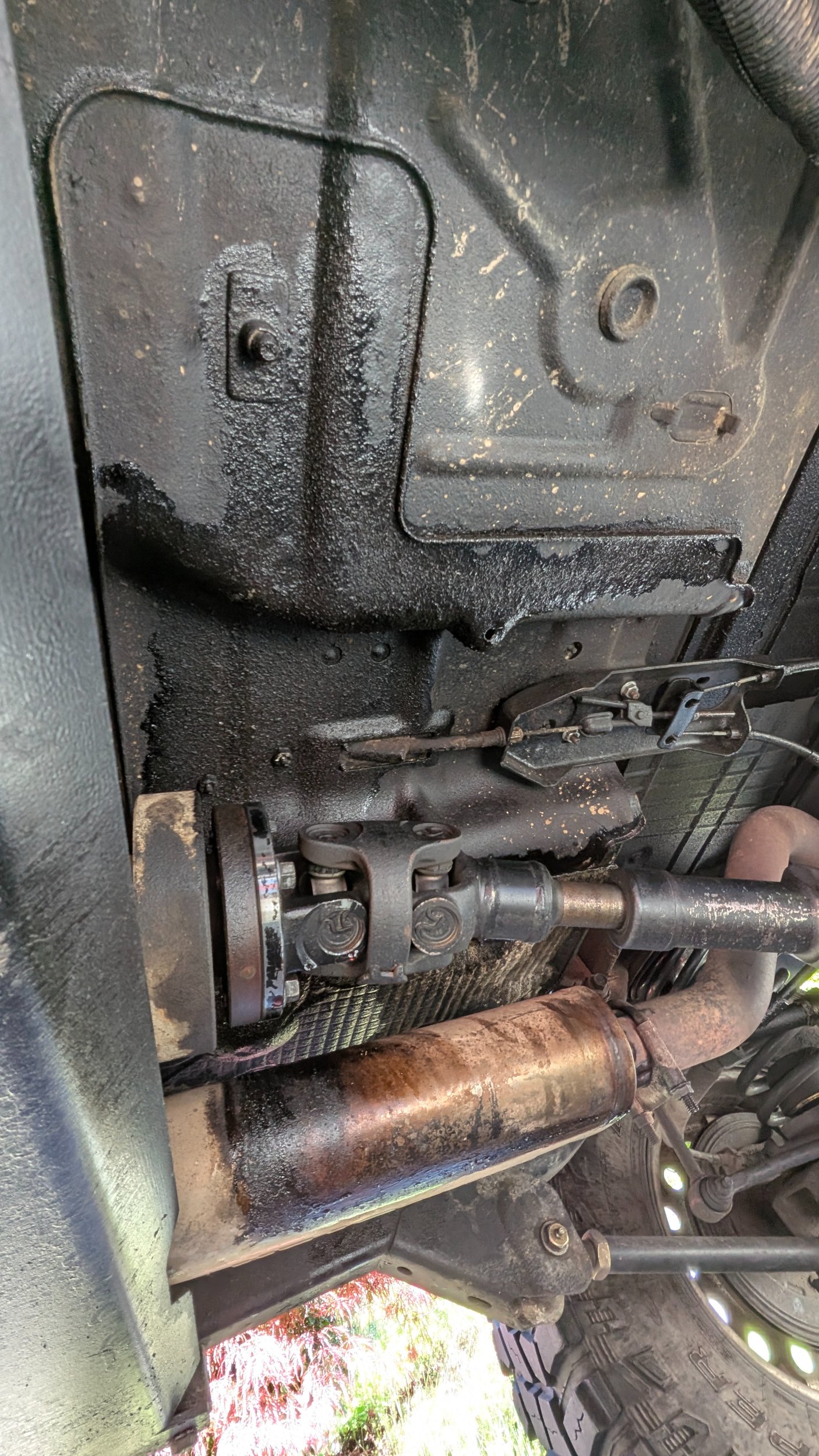

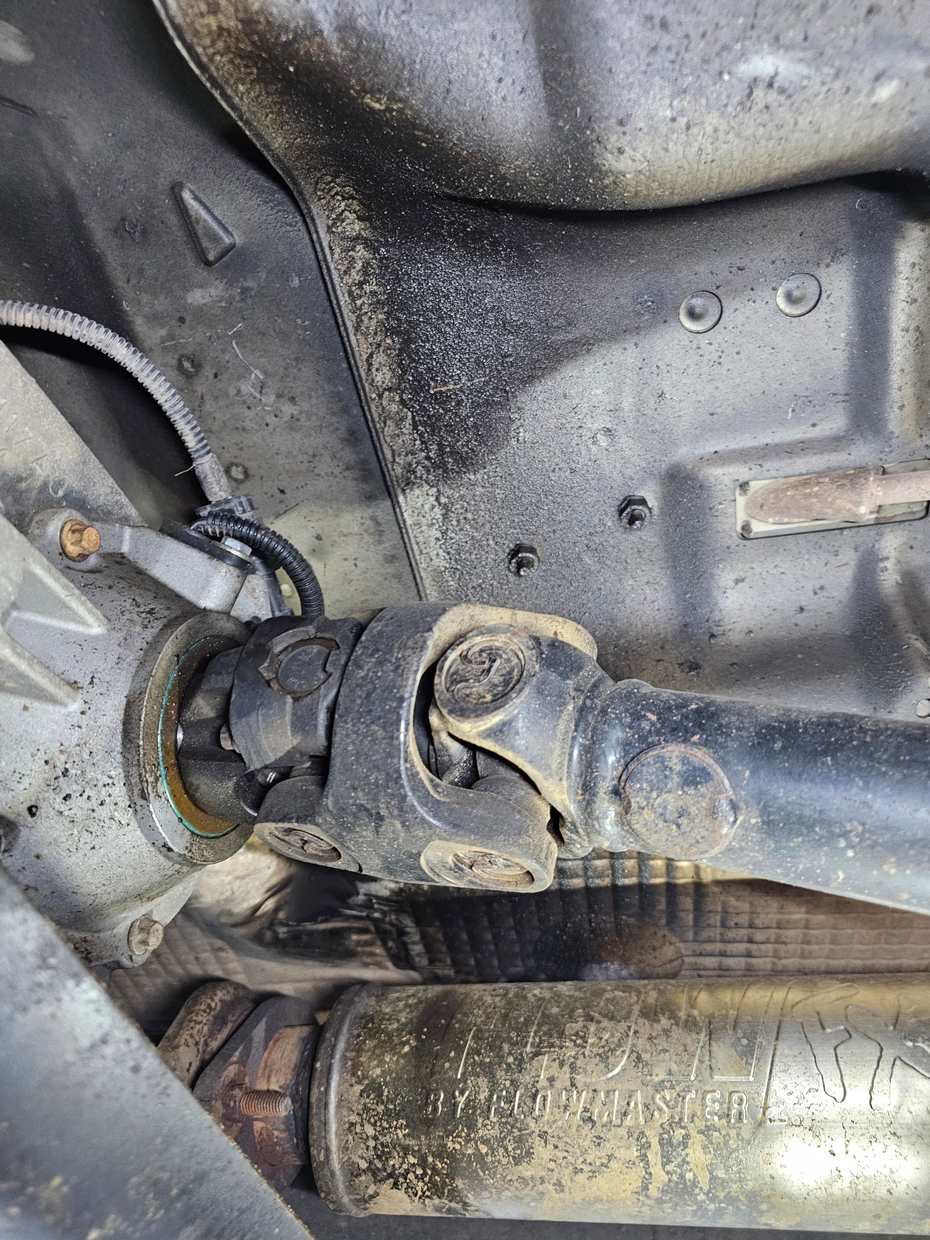

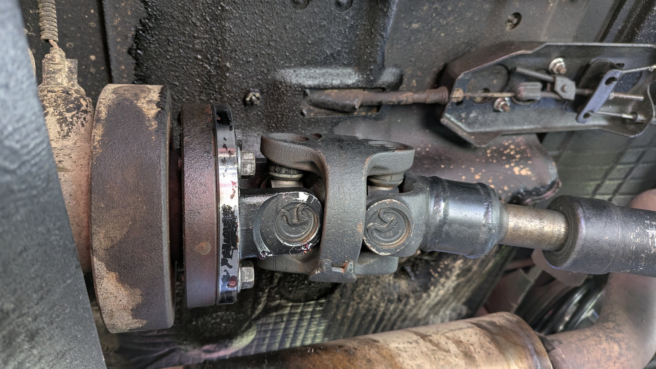

Noticed a couple of drips of what looks like ATF on my driveway. Being that I have a manual rubicon, my guess is that it's coming from the transfer case. Would these pictures appear to line up with a failing transfer case rear output shaft seal? It slung atf all over half the muffler and the underside of the tub. :/
I haven't pulled the shaft yet, but will do that later tomorrow when I've got a bit of time to work. Assuming it is the output shaft seal, is the seal the same on the NP241 as it is on the 231? Just making sure if I need to order a seal that I don't get the wrong part.
Thanks again!
