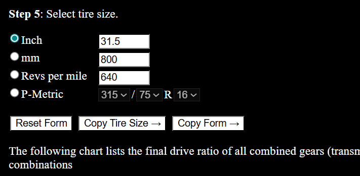

This is why I use the manufacturer rev/mile listing. That 640 number is right in line with most all "33s" on the market. I am on Tirerack looking at the three 33x10.5" options listed there and they are 630, 640, and 640. That means 31.5"-32" for all of them. People make fun of me for doing extra work but that number ALWAYS works for me. Maxxis doesn't advertise that number in this case but when it's available, I use it. It works.
